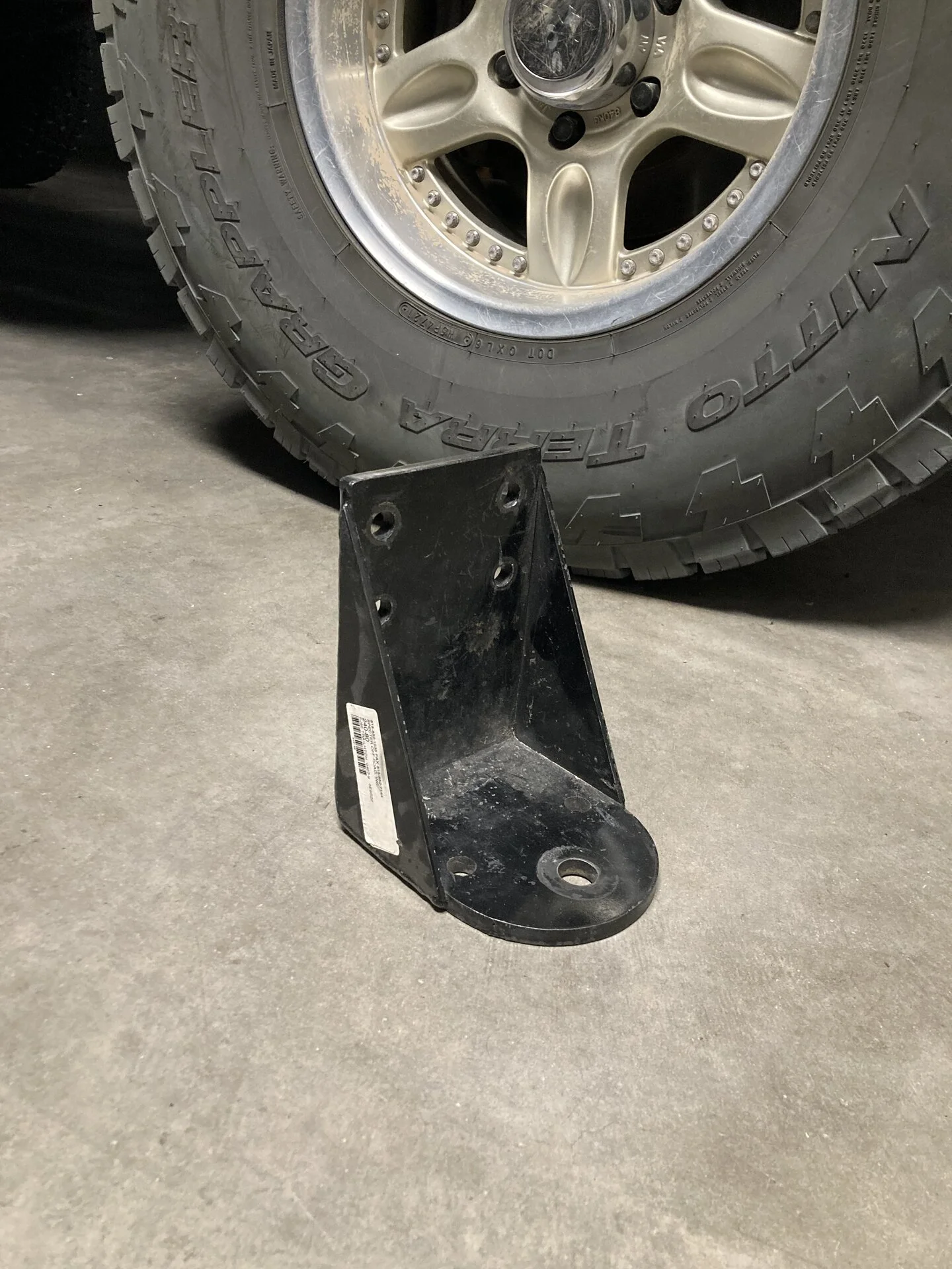

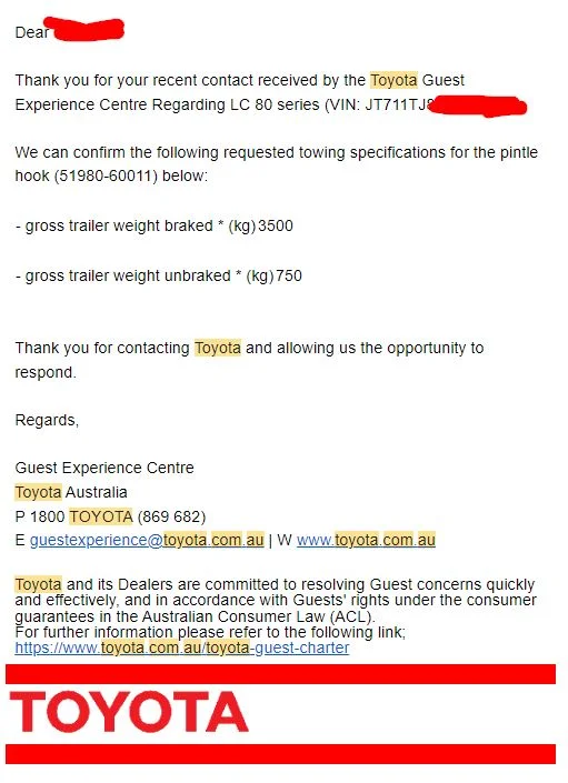

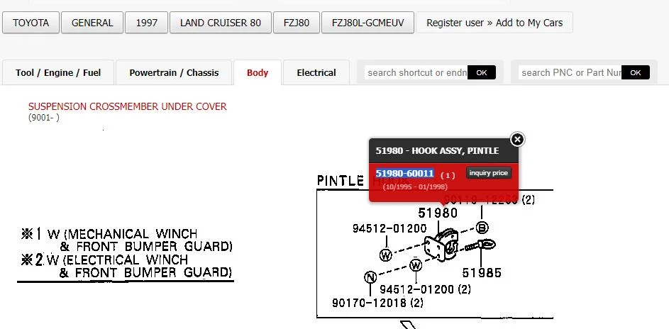

Hey mate, So basing that on a couple of things...
Firstly, The part number for the 80 Series Pintle Hook is 51980-60011.
When I contacted Toyota Australia, I was given the following information:
PLEASE NOTE: My Landcruiser is a 1997 model and rated at 3500kg, the earlier 1990-1995 models are only rated at 2500KG, at least here in Australia.

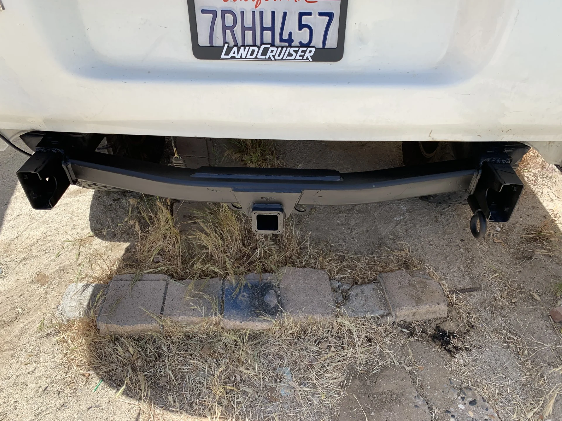

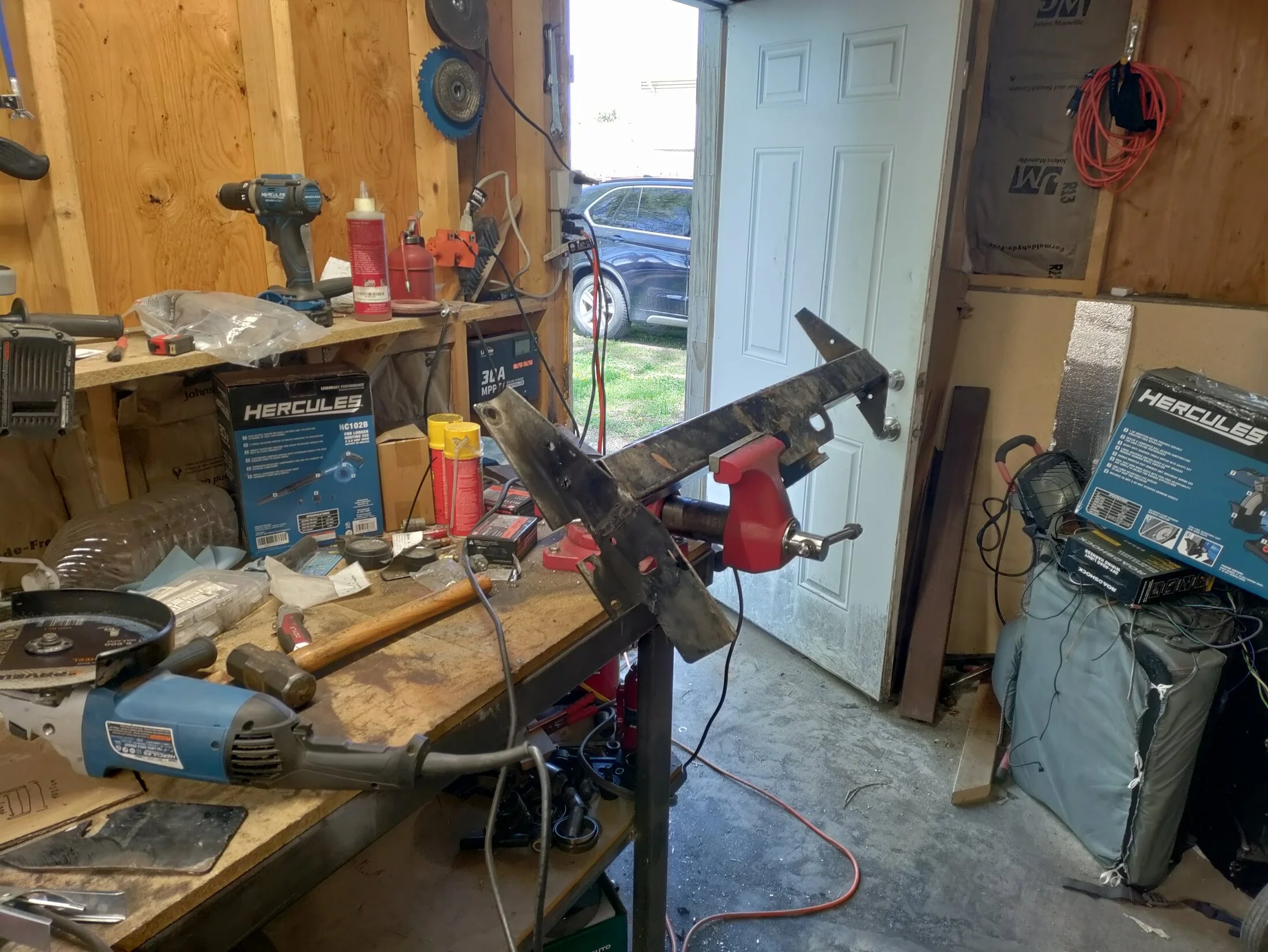

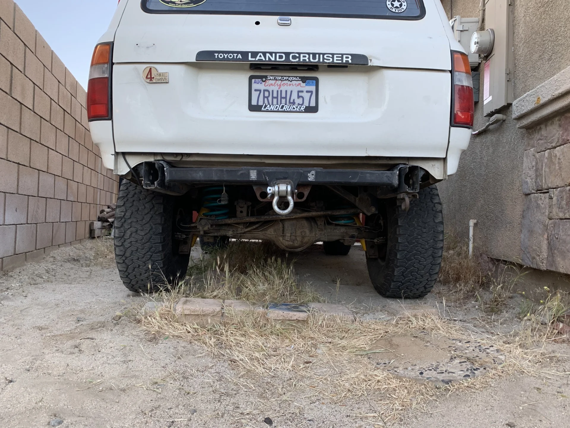

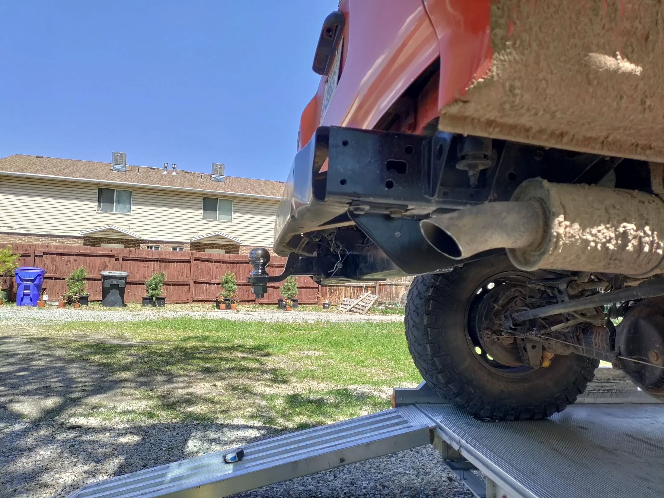

I also disliked the departure angle impact of the US market standard hitch receiver mount.
Came up with the following solution: I moved the horizontal bar 8 inches inwards, and then cut away the excess metal from the brackets.
Now it pretty much doesn't impact the departure angle beyond what the rear crossmember does. I also cut the exhaust pipe to match the hitch.
Benefits of this solution:
  • doesn't cost anything or require any additional materials
  • should improve towing stability (both sway and brake force distribution) as the hitch moves closer to the rear axle
  • hitch mount should become stronger if anything, as there is less leverage to the bolts that secure it to the frame
  • looks decent
Negatives:
  • harder to hook up a trailer or certain things. E.g. I only after realized that my hitch winch mount didn't clear the rear crossmember without modifying it
I have taken it rock crawling after and it's a significant improvement to the stock setup. It's still taking some hits, but now the crossmember is taking some as well. So to improve departure angle beyond this the crossmember would have to go / be modified.
