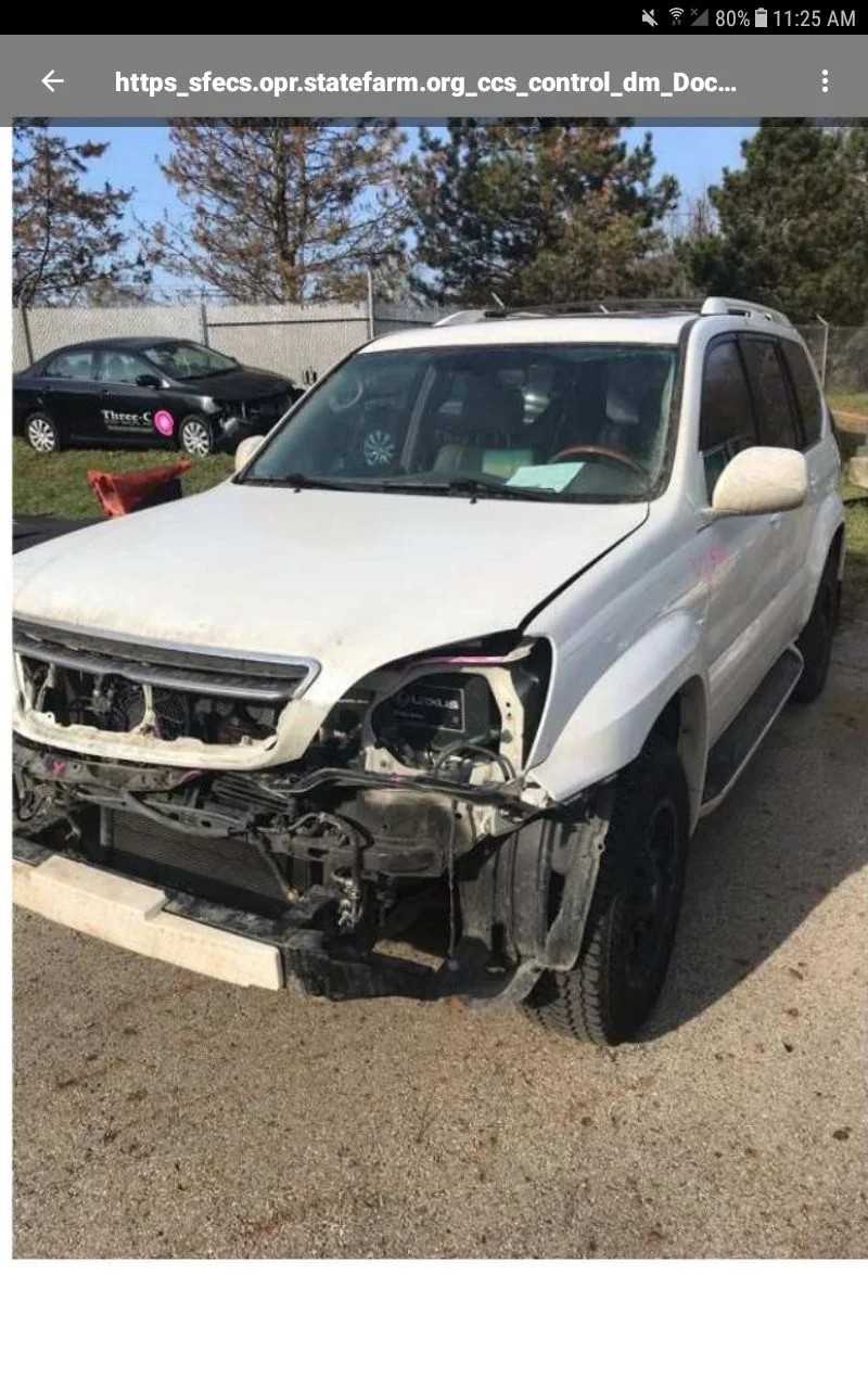

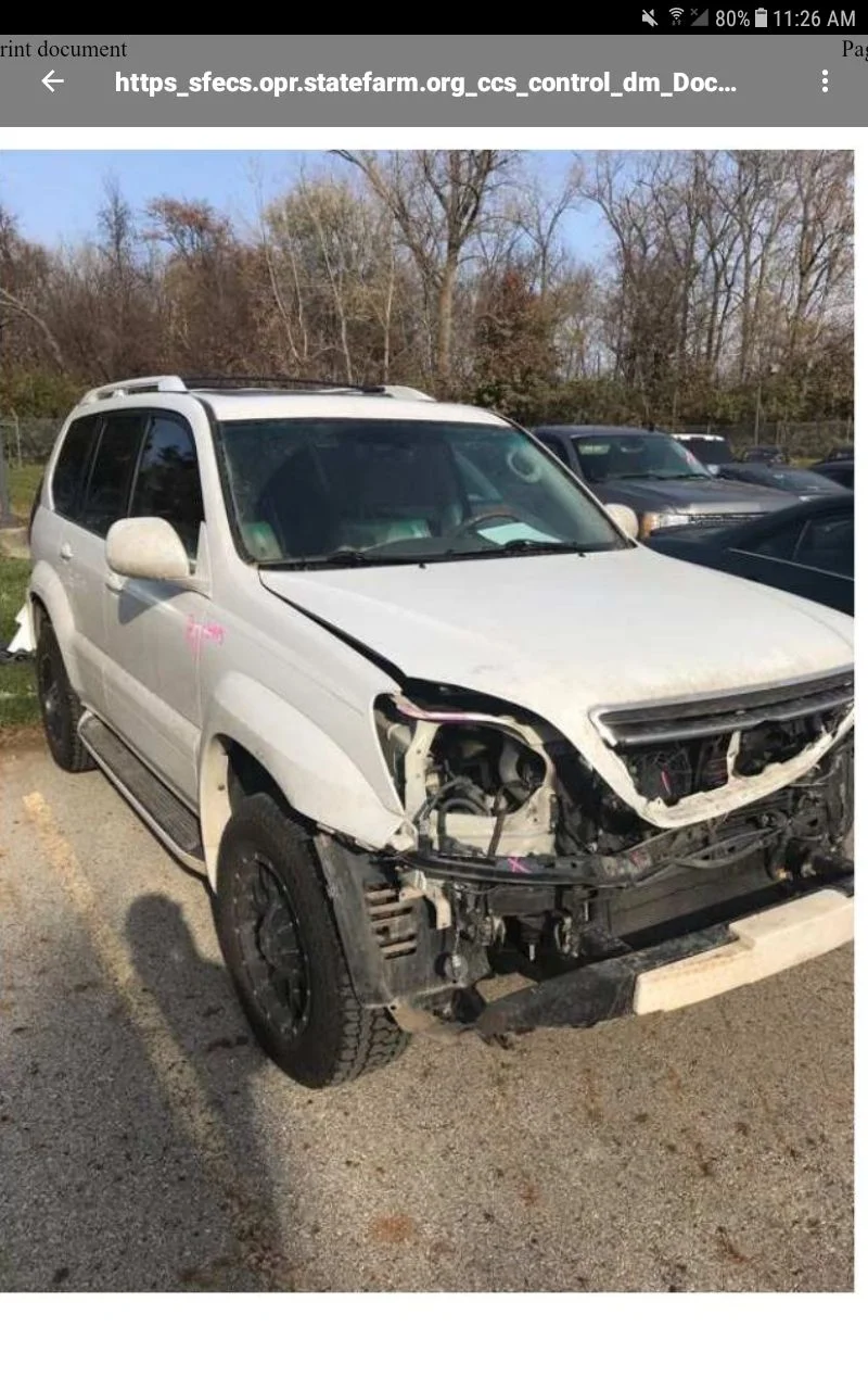

So back on November 12th I hit a deer on my way home, about 5 miles from the house. Pretty good amount of debris, headlights were broken but both still worked fine, did notice a trickle of coolant so we left the scene immediately as it was 15-deg outside (and it was night) and I didn't want to be stranded in the country with no heat waiting on a tow. Truck drove fine, I kept an eye on the temp which was easy to keep down since it was so cold outside and I coasted a lot.
Anyway, assessing the damage in the light of day, here's what I know to be damaged:
- Bumper skin
- Crash bumper
- Grill
- All four lighting assemblies
- Hood
- Horns
- All three coolers
The airbags did not deploy and the fenders and fender flares are all 100% fine. I also closely inspected the core support and the ONLY damage to it was a few minor bends where the coolers and whatnot attached to the thin lip via brackets, where those brackets attached the lip is bent but can be very easily straightened, I even own the tool necessary to do so.
I don't want to be naive about this, I'm not an insurance adjuster or a body shop guy, I do understand hidden damage but this was a small buck (~100lbs?) hit at 45-50mph while braking, it broke a lot of plastic bits and folded a bit of cheap sheet metal but did not deploy the airbags, bend the frame, mess up the alignment...nothing. In my mind it's an easy fix, I can literally do the entire job myself, the only alignment needed is the new hood but that's just 4 bolts and some rubber stoppers.

To fix that in a body shop it will likely be around $7000 with OEM parts and a little shopping. To fix that yourself and add a bumper would be around $5000 with outside labor and $3000-3500 with your own labor.
First off, glad you are ok. Always sucks to see things like this happen.
Secondly, take some better pics in the light of day. Hard to tell from that pic what exactly is damaged and how badly.

That damage does look like structural. It should be fixable.

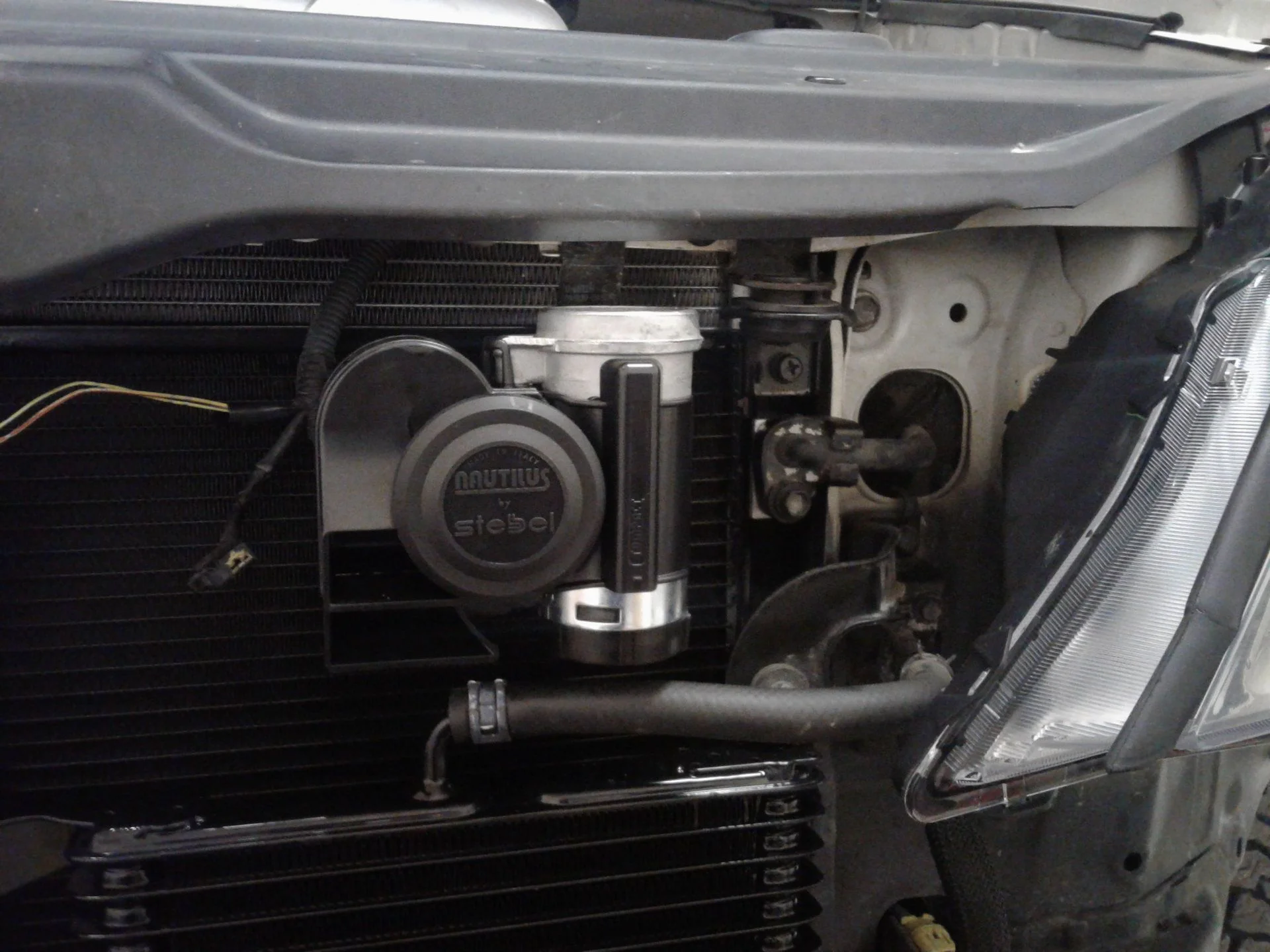

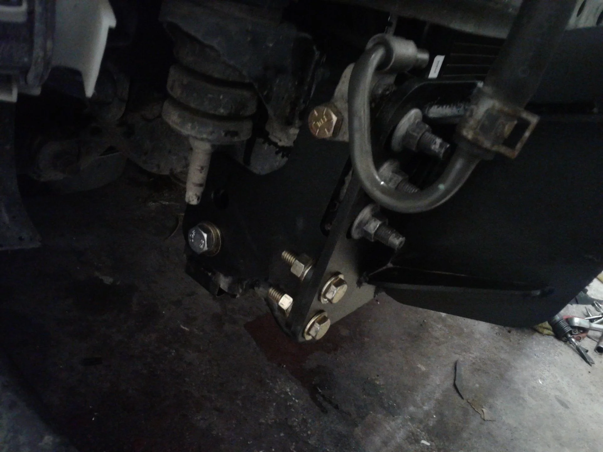

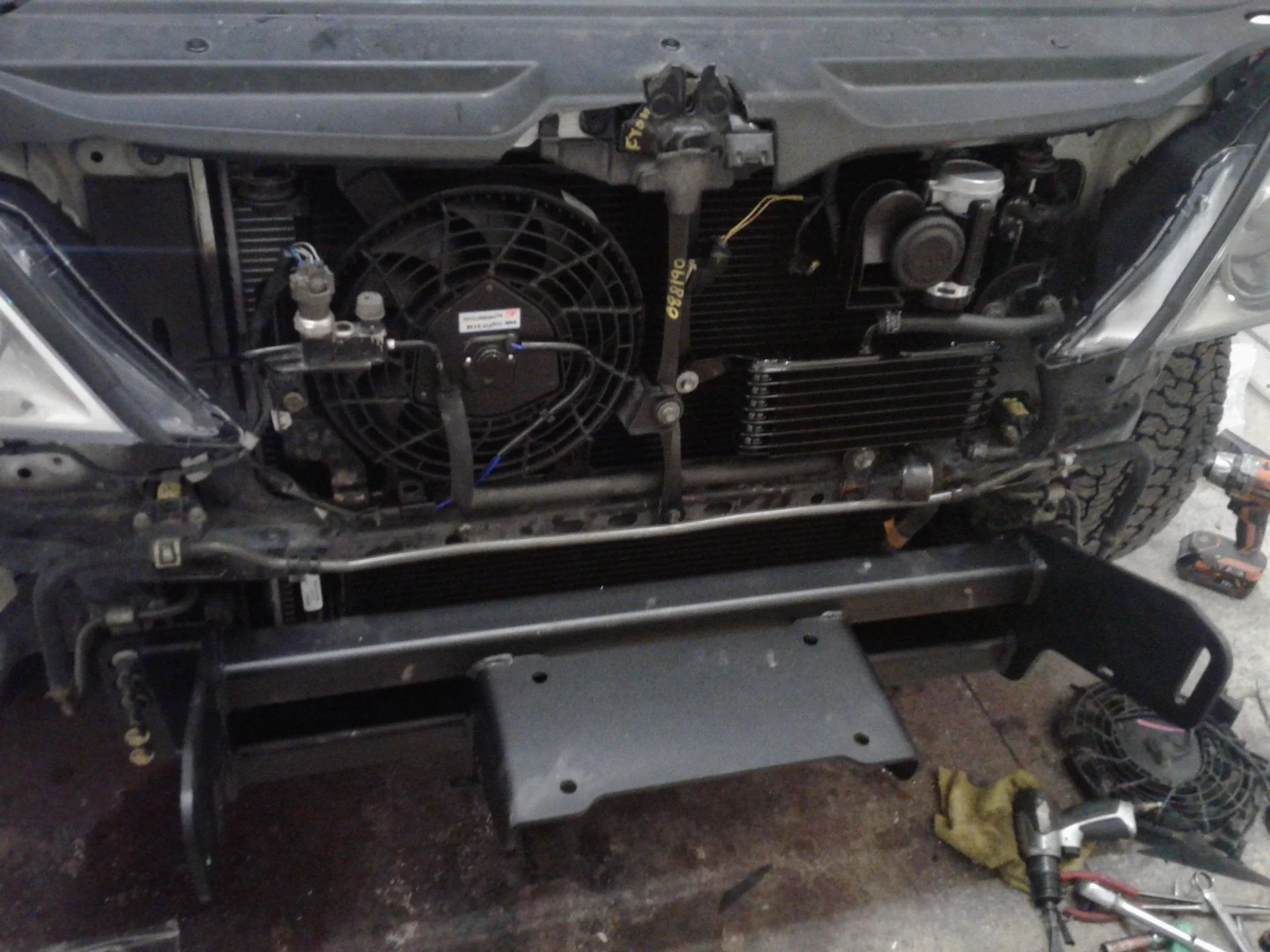

IT'S ALIVE!!!
NEW:
- Radiator
- AC condenser
- Trans Cooler
- Clutch Fan
- Electric Fan
- Thermostat
- Coolant Hoses
- Radiator Cap
- Headlight Assemblies
- MetalTech Goblin Front Bumper (here, not installed)
Have bought TWO brand new hoods from two different vendors, both smashed to hell during shipping...awaiting refund for the second and still looking for a third...
