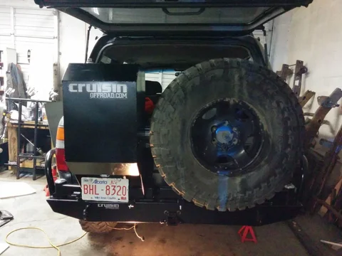

Cruisin' offroad rear bumper. Another superb piece by Jason. The item on the left swing out is a slip tank. Looking at roughly 230L on board now.

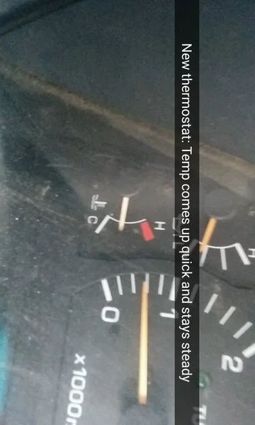

Replaced my thermostat

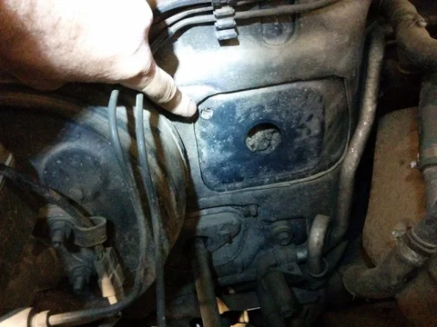

Free'd up the firewall hole, had all my mods wired through there. I'll be need that for my clutch resevoir.

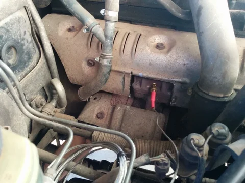

Put the thermocoupler in this morning.

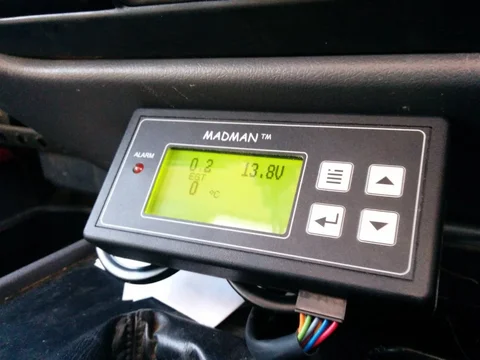

Madman EMS1.
Still need to wire in the coolant and oil temp sensors, which are plumbed into my veggie oil HEx loop.
So, out test driving the EGT. Saw temps come up to 200-300°c range driving around town. Would drop very fast when nor accelerating.
As my caption on the thermostat photo said, with the new thermostat I was getting super hot air into the cabin, and my rear HEx loop was finally seeing heat, (had been thinking it was air locked).
I saw about 600°c on the pyro.
When I parked, the EGT dropped right down to -77°c. I will righteously complain about how cold it was in the morning installing that probe out in the driveway, but I know it wasnt that cold.
One thing I didn't do, was use a grounding point on the engine block for the EMS1 unit.
I'll be trying that tomorrow.

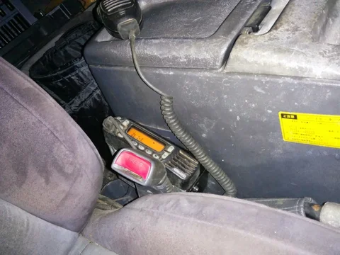

a road radio for all the high traffic back country industry roads up here.

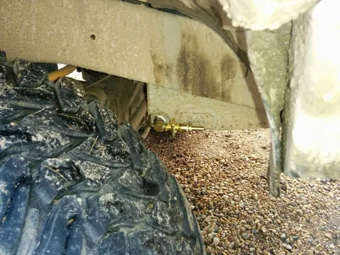

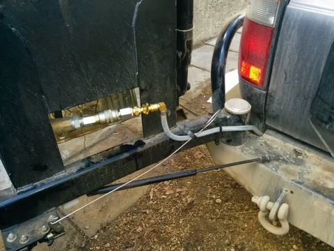

Also plumbed in a line so I could gravity feed my slip tank into my aux tank with a fairly easy disconnect. makes draining the aux and slip tanks easier

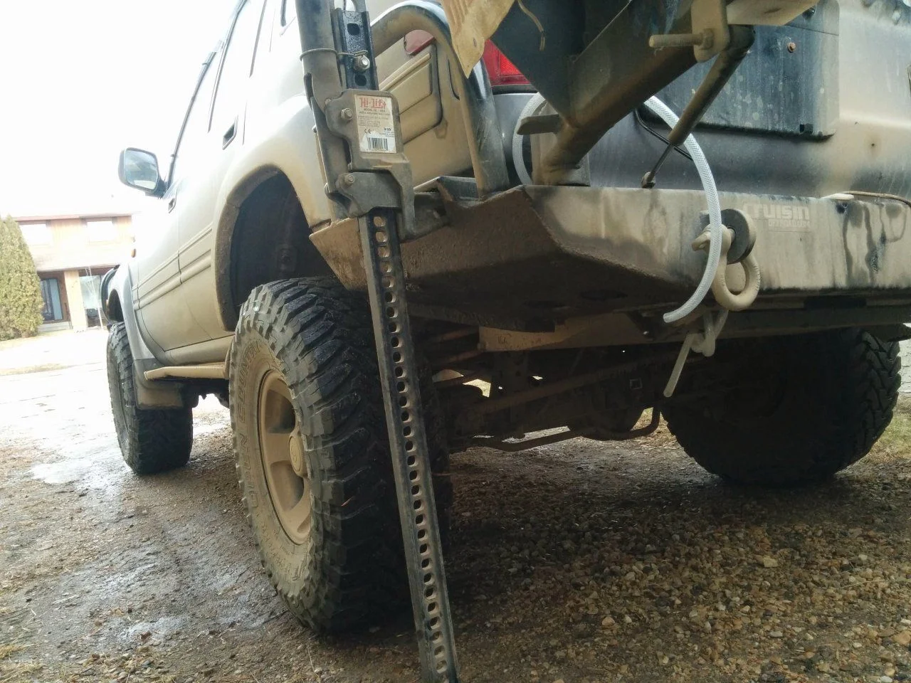

tried to use my hi-lift to tilt the fuel to the far side of the take while i replaced the plug.
think i need a taller hi-lift
