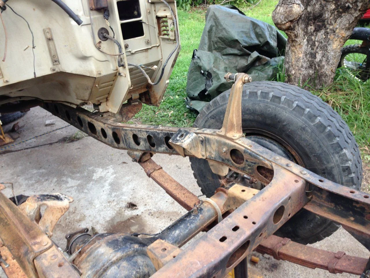

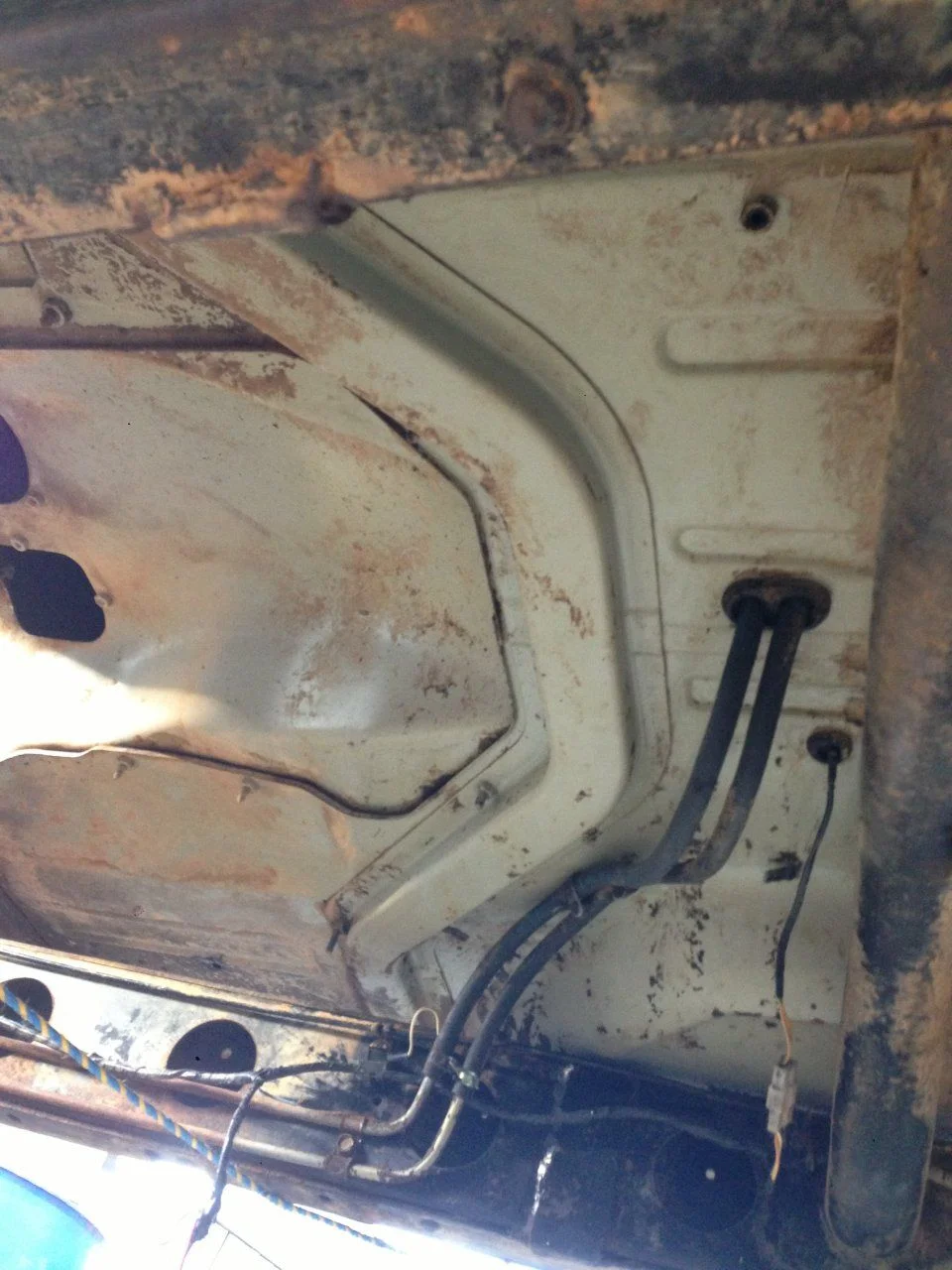

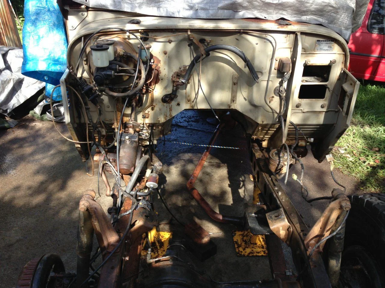

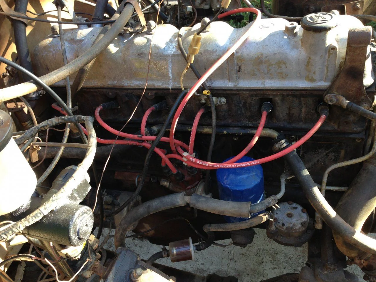

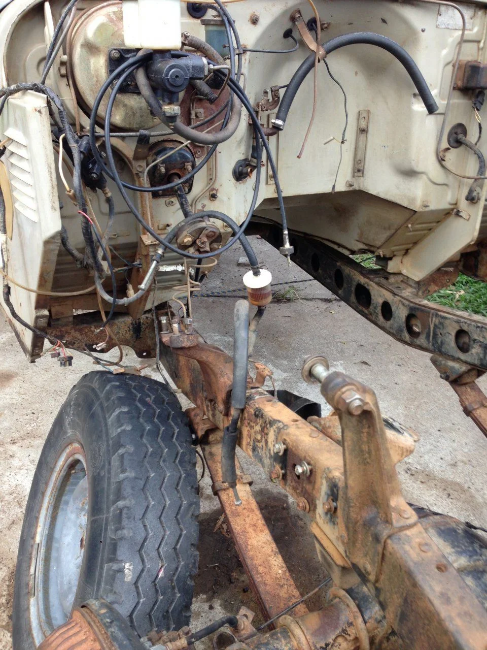

I got stuck into the truck today striping the plumbing, mechanical and wiring to lift the engine and box out. All I have to do before pulling the engine is the 4 speed shifter and H/L shifter and the handbrake cable. I suppose the photos look the same from a few days ago but after spending 6 hours today rolling around under the truck in 36 years off grease and grime it deserved a mention.
Keep it up mate it's getting there
There's a lot of room there now

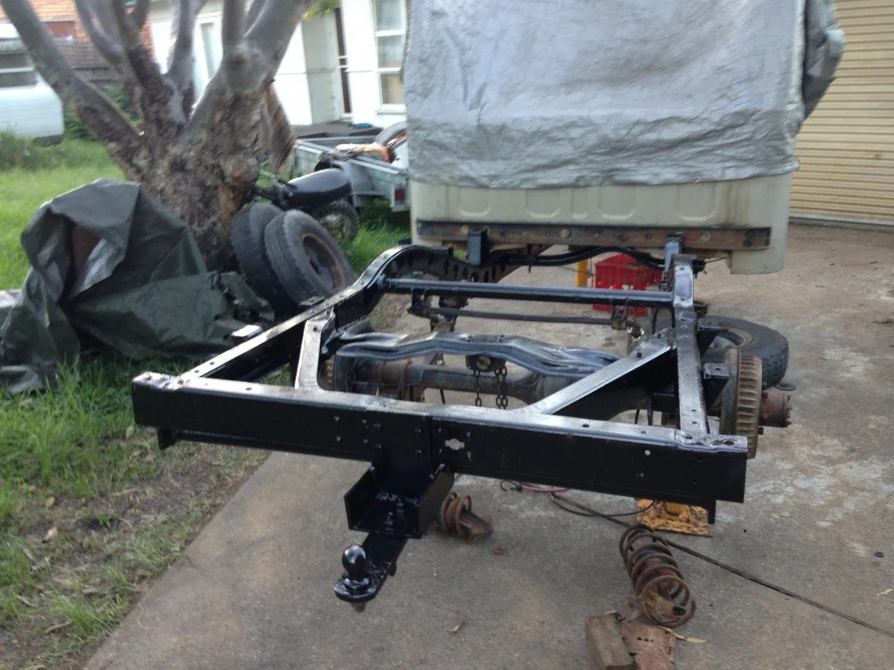

This is as far as the build is going in strip down mode as the tub and chassis being done in gal is beyond my build funds.

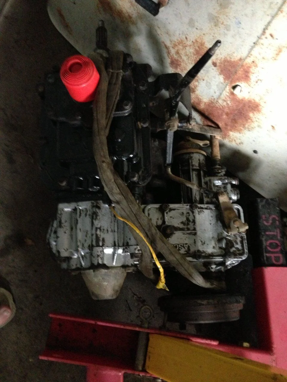

I spent a hour degreasing the 36 year old gearbox who said oil and dirt don't preserve stuff. I got it 90% clean before running out of degreaser. I need another 6 pack to finish the gearbox and start on the engine bay and front chassis rails.
That's one clean gearbox and transfer case looks good after so many years

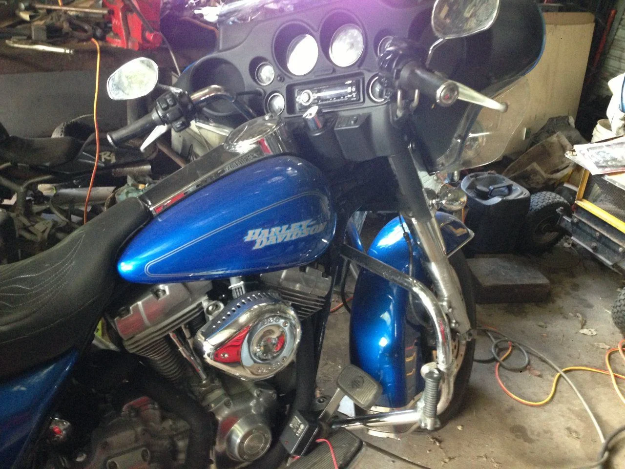

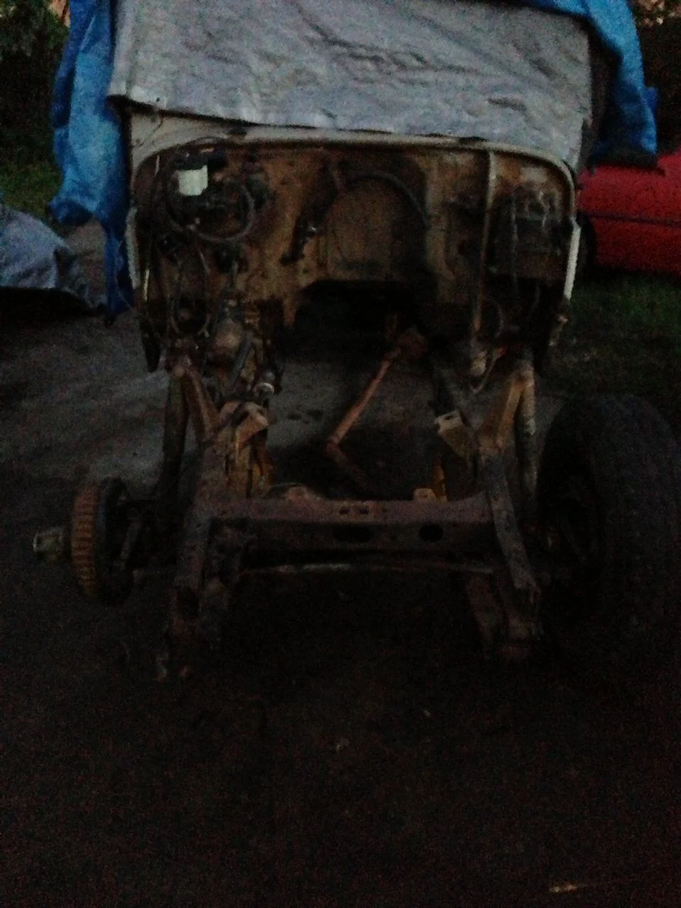

Spent the day degreasing and cleaning between the chassis rails with compressed air and a high pressure washer. Its slow going but I'm still working on the grease and grime. I wish I had room in the work shop but its full of motorcycles. I'm trying to get a 20ft container to put beside the shed so I can store all my bikes and make room for the 45 rebuild.

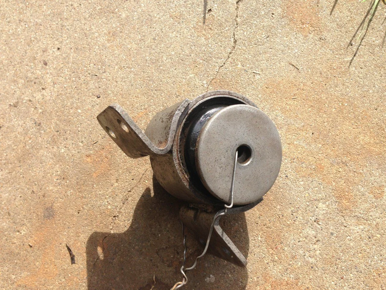

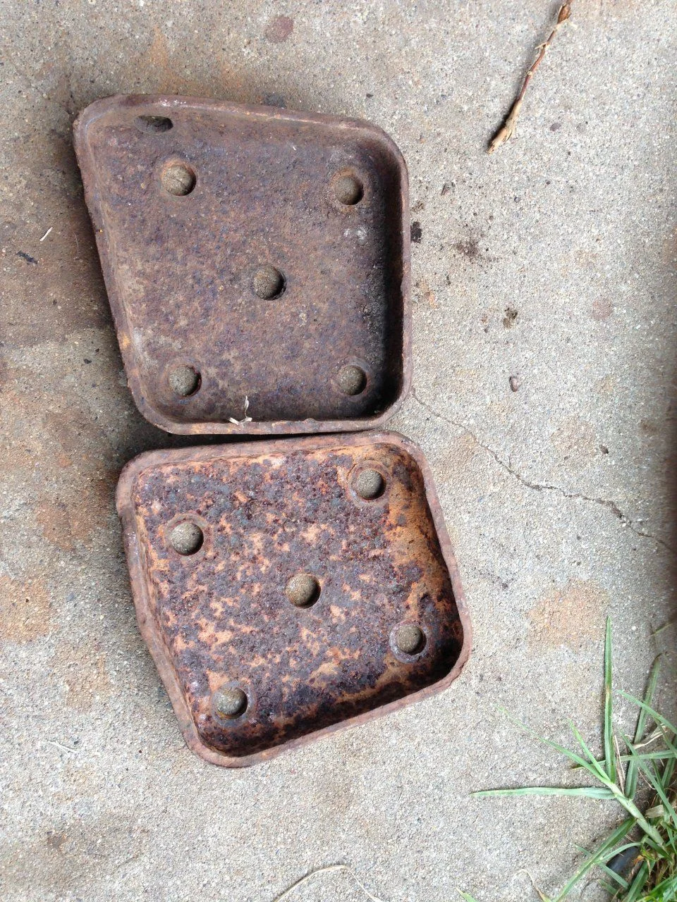

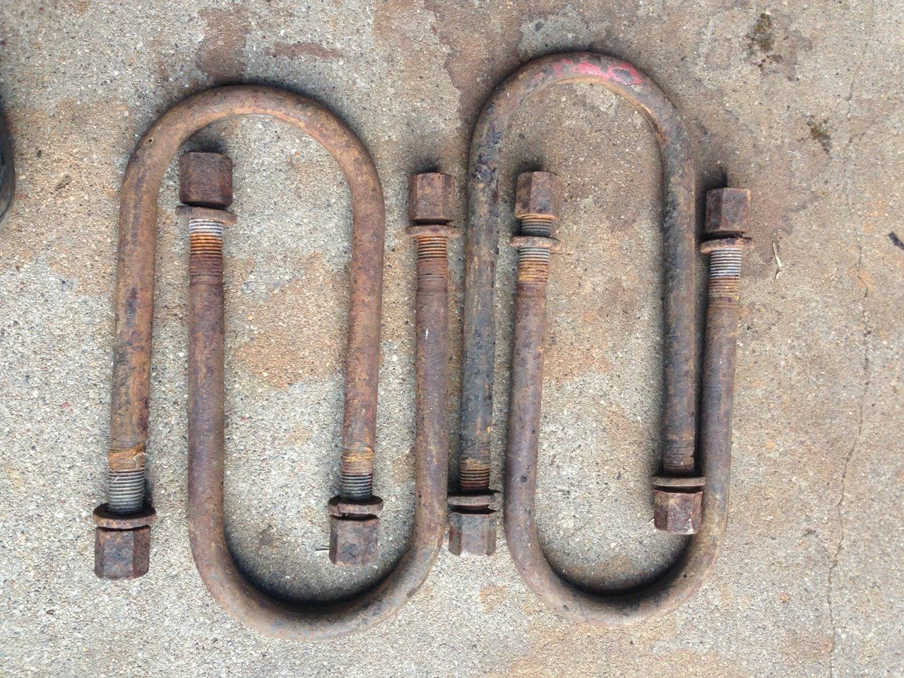

Some pics of todays work on the 45 the h engine mount just came out of the vinegar and the 1980 front leaf plates and U bolts are going into the to be cleaned from rust and paint.

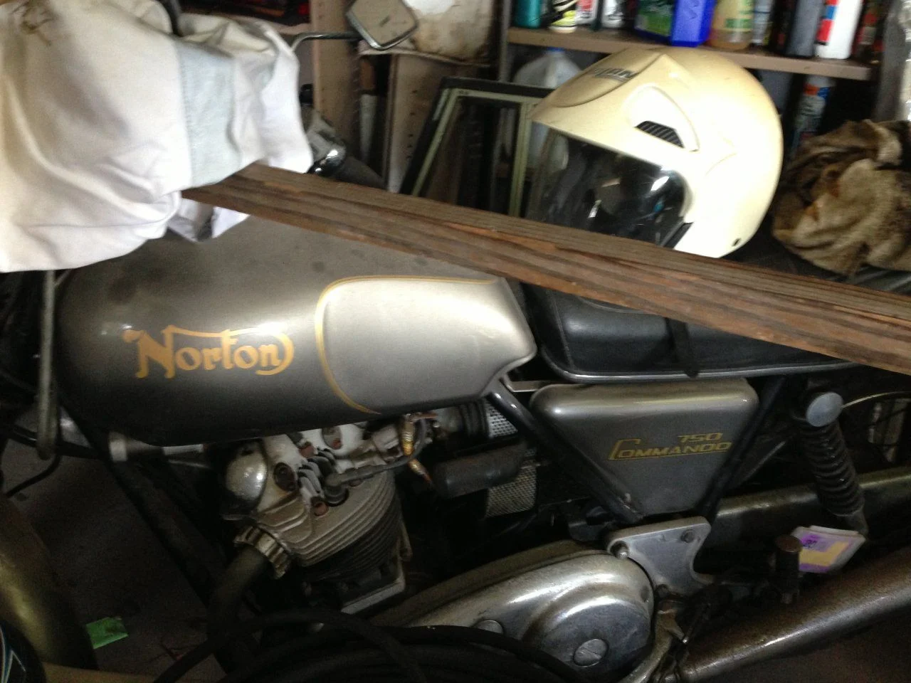

Sweet Commando, my dad is currently restoring an 850 in BRG.
Thanks the Norton is a 1972 combat roadster I brought about 20 year back I done mild restore and rode it for a couple years before parking her up.

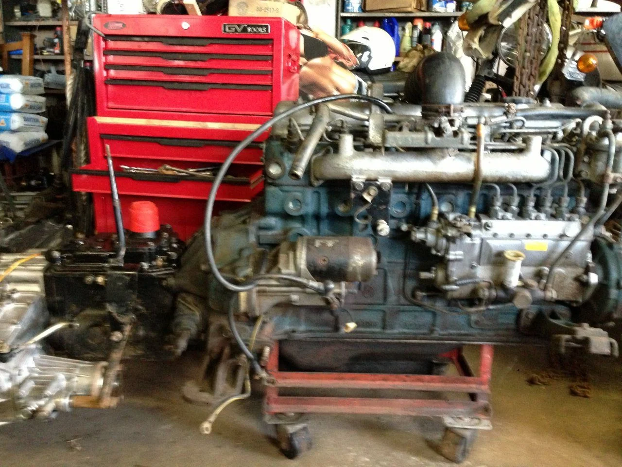

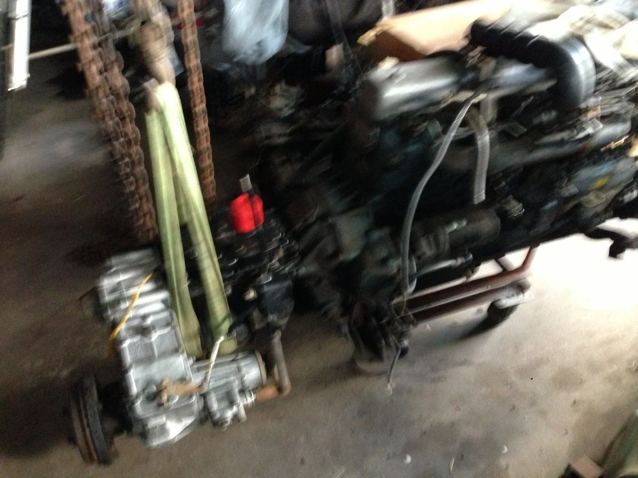

I mated the fj45 box to the H engine today with no problems. Its so easy to do standing next to the engine and box instead of laying under the truck stuffing around with a gearbox jack.

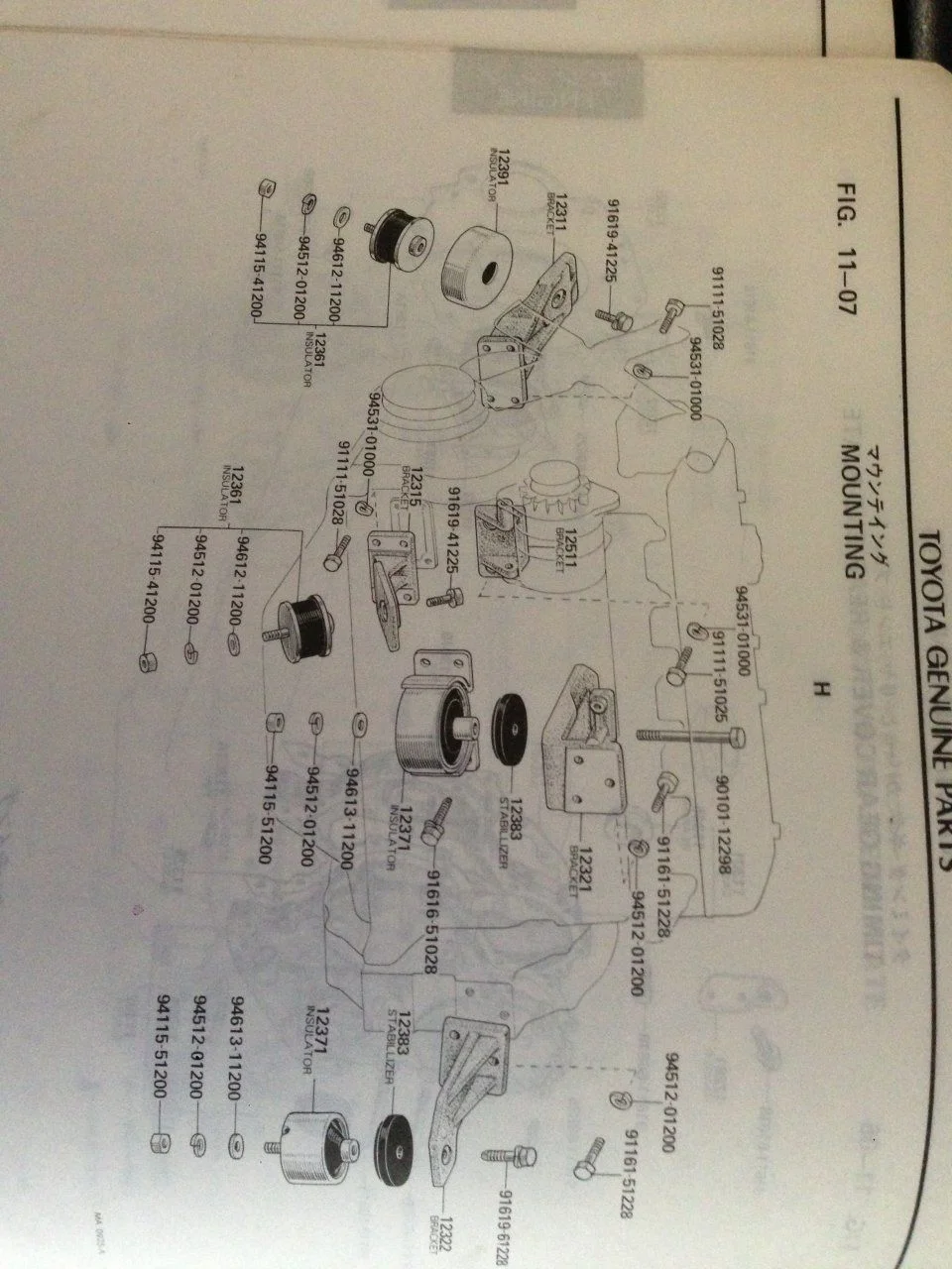

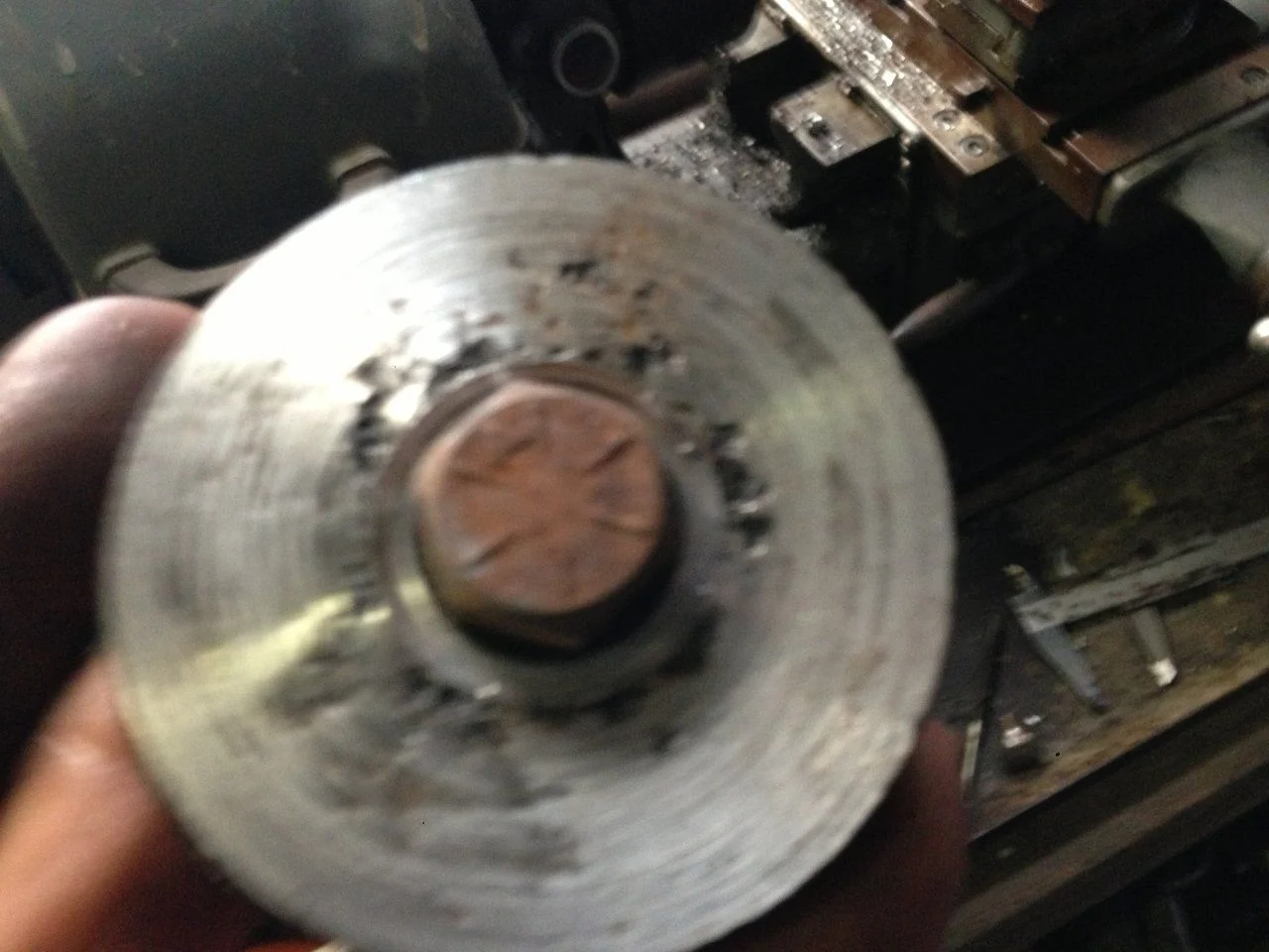

I started fitting my engine mounts and have a few questions regarding the rear gearbox mount isolators on a hj45. I have two isolators from my 1980 hj45 and they were mounted on the bolt to frame engine mount top and bottom and nothing on the other mount. According to my parts manual there should be one on each mount. There is nothing in the chassis and body manuals or the H engine and supplement manuals regarding engine mounts. I will need to put one in a lathe to open up the recession to fit the engine mount. Did any of you guys have this problem or even have them on your H engine mounts.

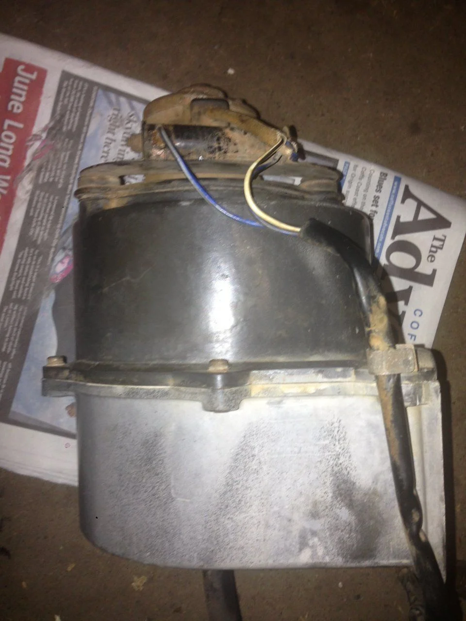

I decided the parts manual must be correct I put the insulator in the lathe and opened up the recession to except the larger engine mount. I also cleaned the faces from rust and glued the rubber cushions back on. I pulled two heater fans down and built one from the best parts as they both had problems. I will get a good plastic paint to cover it in and then add the rubber seals.
