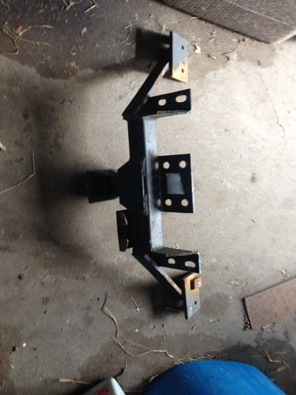

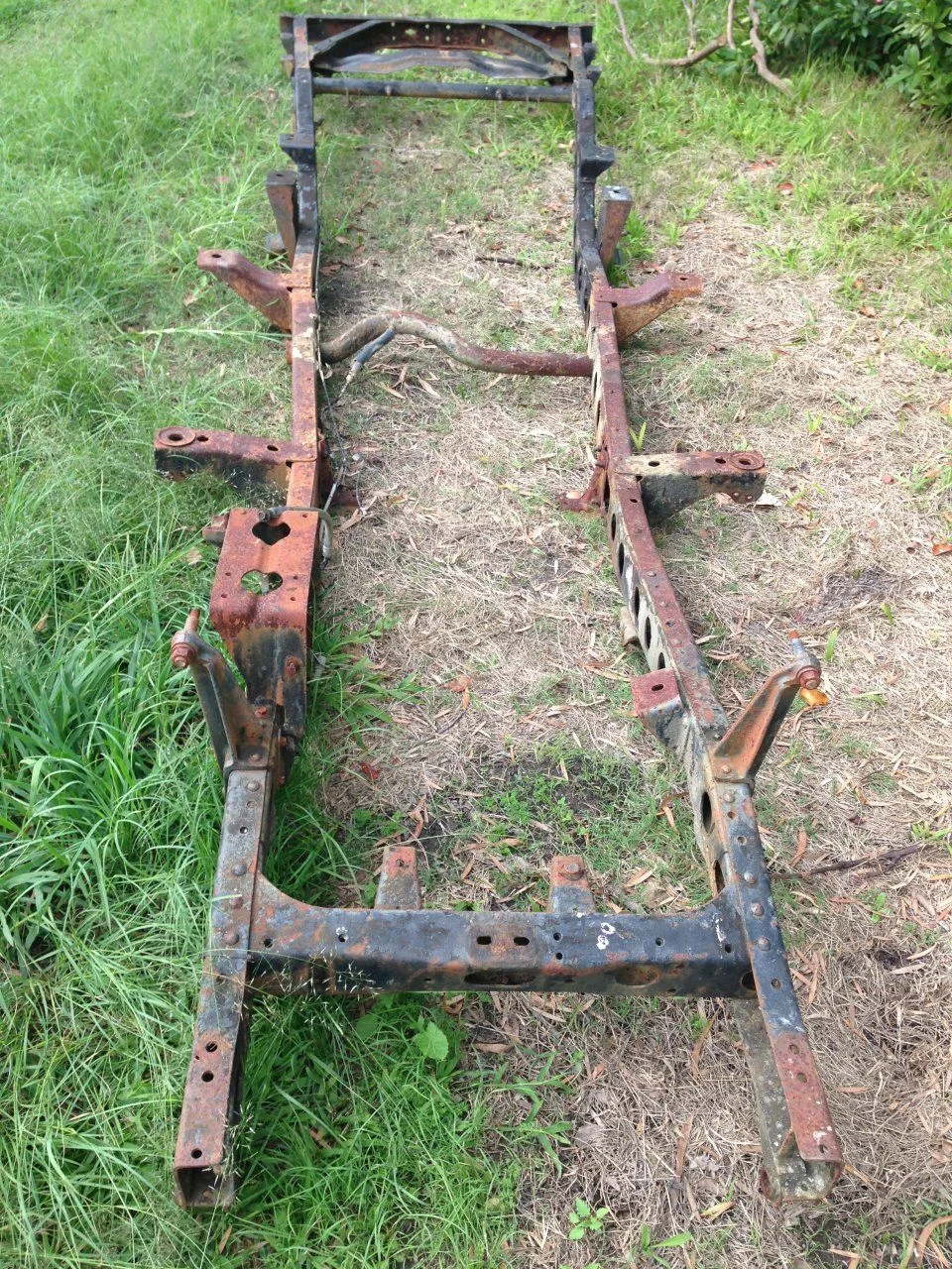

I brought the 1979 chassis but I won't be using it at this stage so I stripped a few good parts that it had. The guy I bought it from gave me a power steering box and a gearbox crossmember to suit a bj42. My wife and daughter want power steering so the h engine will be retired and the 2h from the 60 Saraha will be going in with the PS pump. I will need to pull the 2h engine next weekend to get it ready for the install.

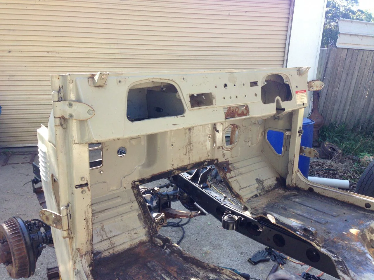

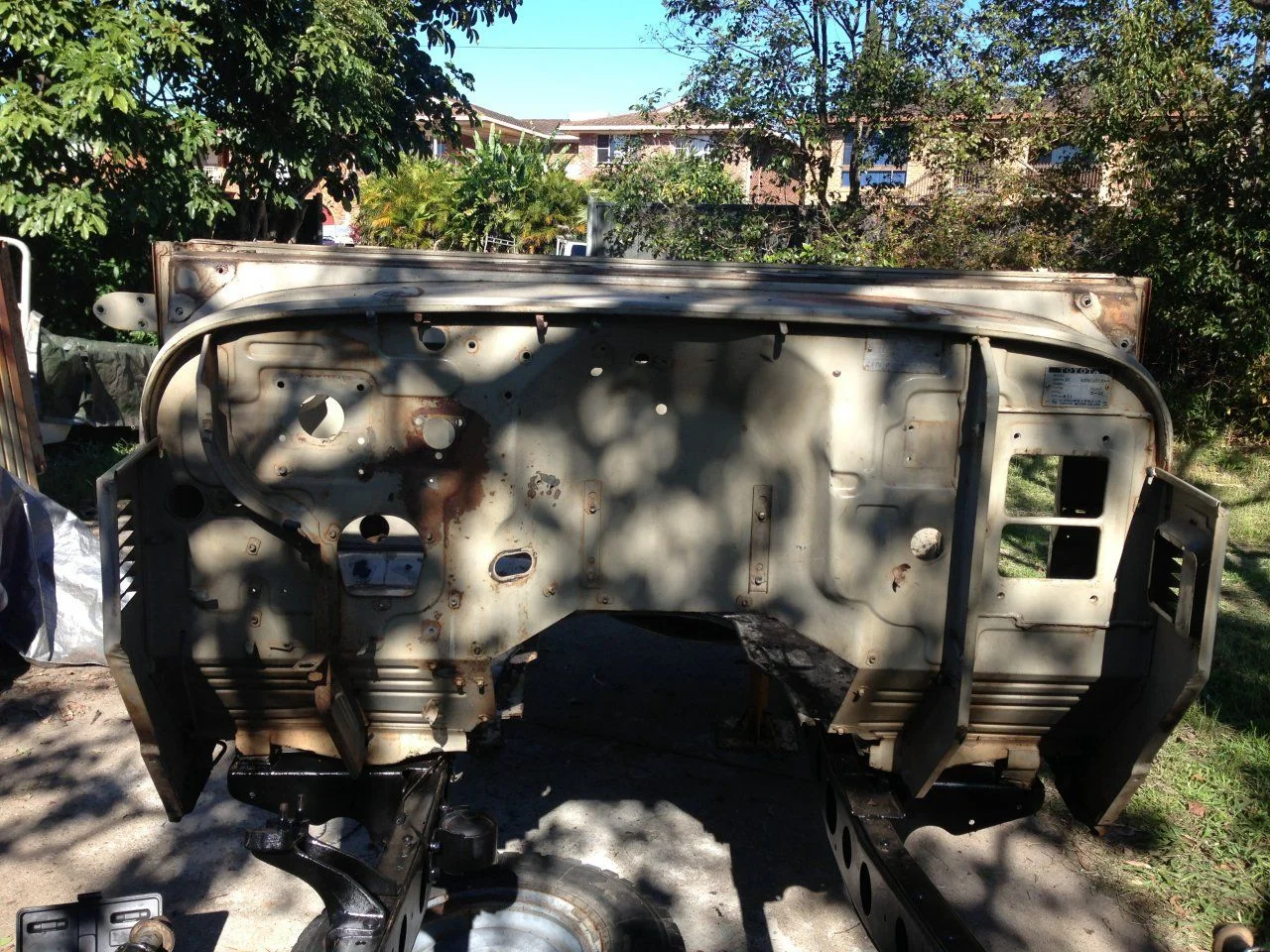

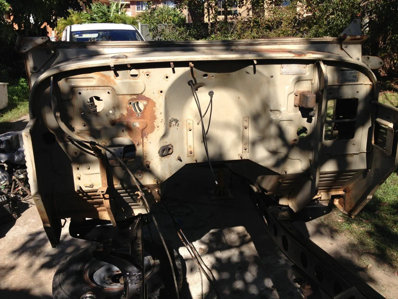

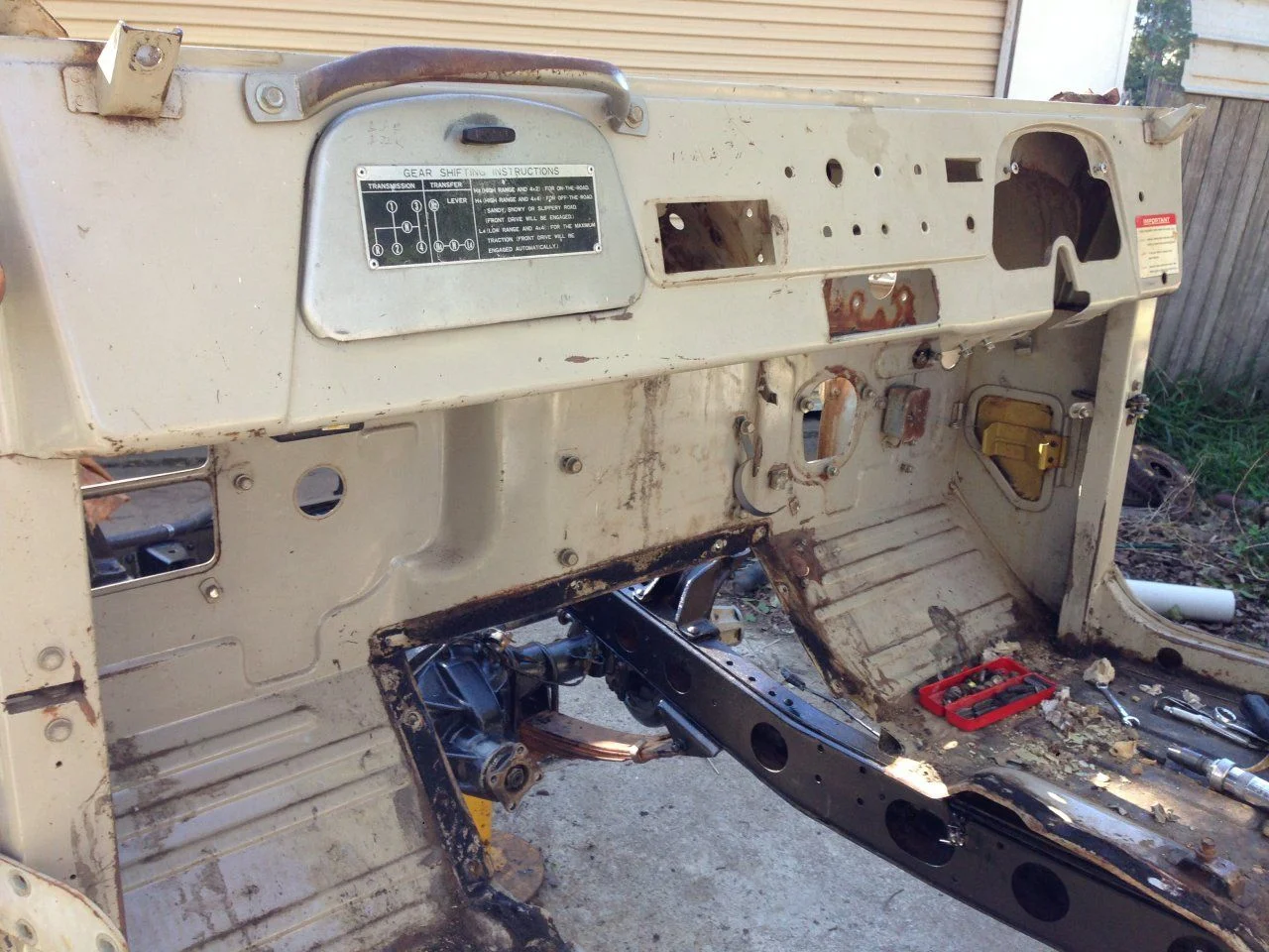

I decided to strip it it down and remove the cab from the chassis so everything has been stripped out except the last four bolts holding it to the chassis. I'm going to try and get the nod from the local galvanizing plant to get it super clean with soap, degreaser, paint stripper instead of sandblasting. If they agree the cabin will be hot galvanized before the epoxy primer and paint. I took a few photo's mainly for rebuild purpose so they will be a little boring

You've made lots of progress mate looks like it is in great condition still
Yeh mate cab is very good but some off the panels are letting her down and panels are getting hard to find rust free.
I might have to upgrade to a 2000 model with the extra cab and start over. ;)

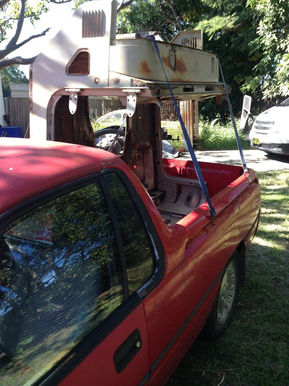

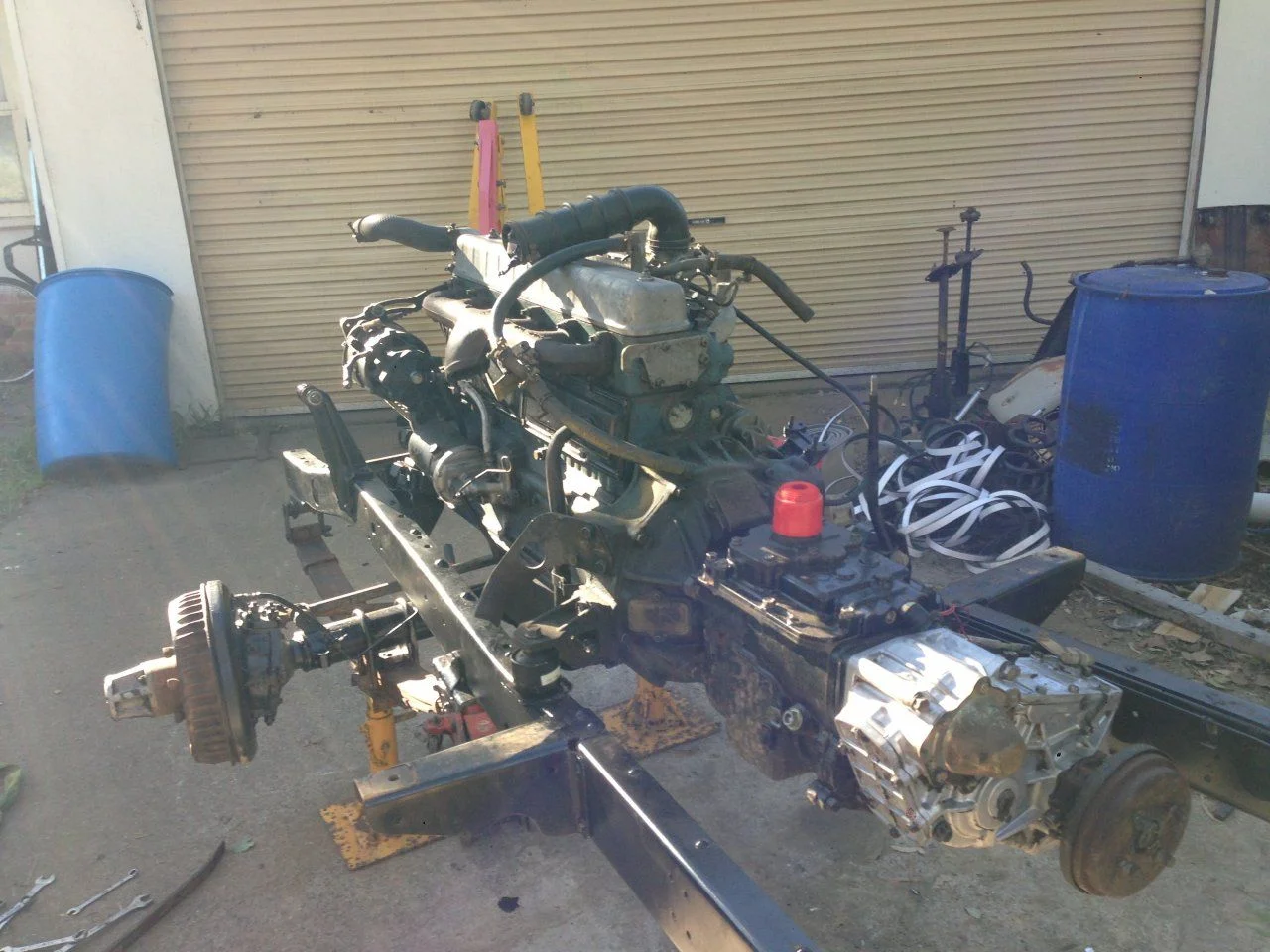

I fitted the H engine mount today and got around to removing the last four cab mounts so all I need to do is lift the body into the ute so I can deliver to the panel shop Tuesday morning. I should have the H engine and gearbox back in this weekend so I can start fitting all the running gear.

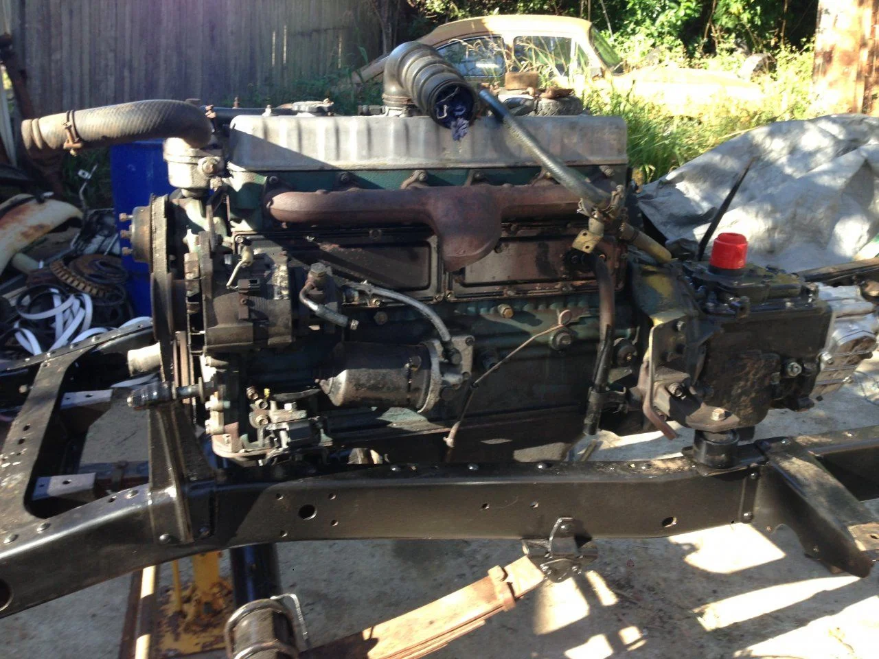

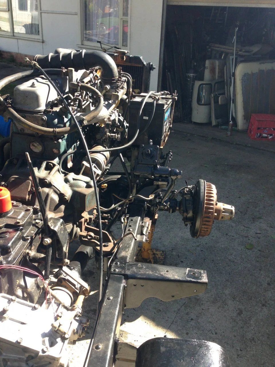

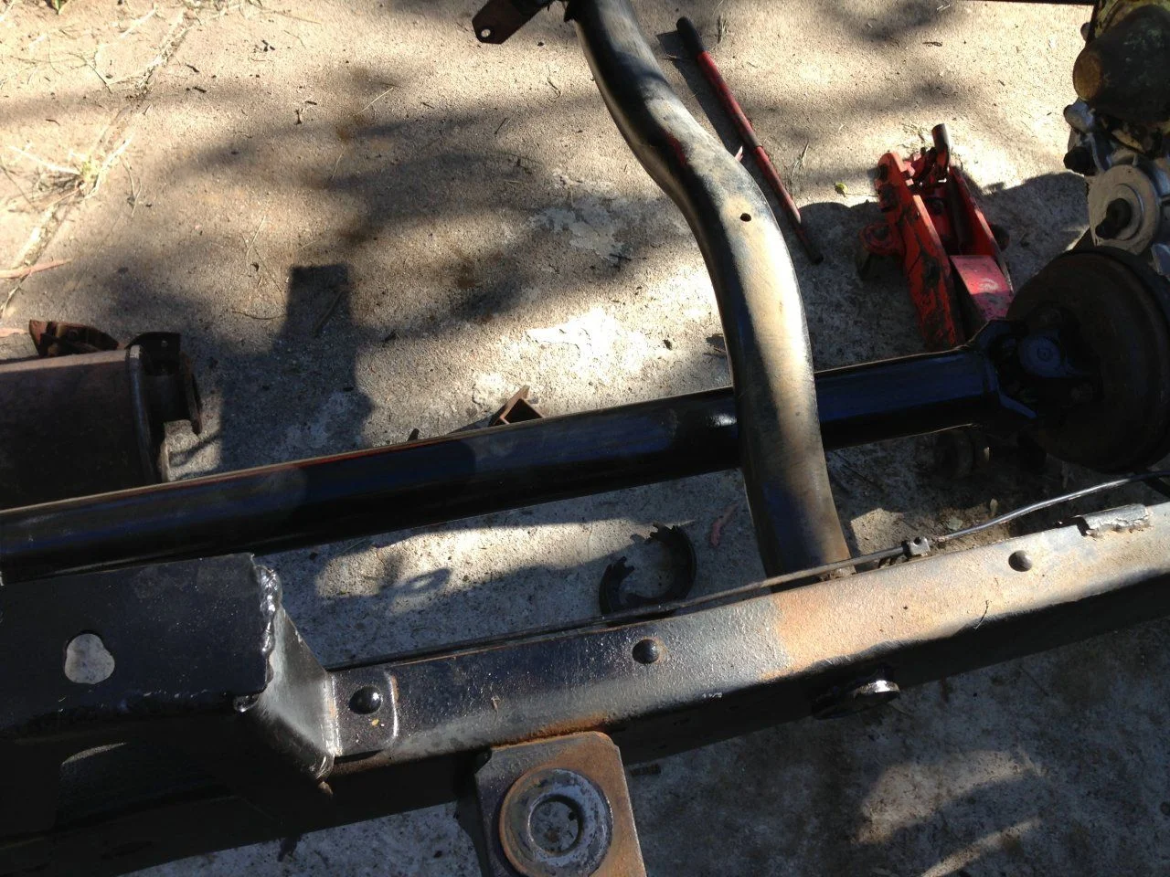

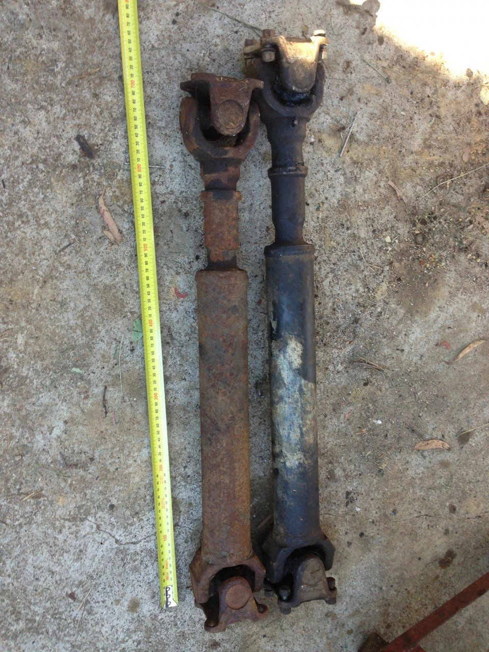

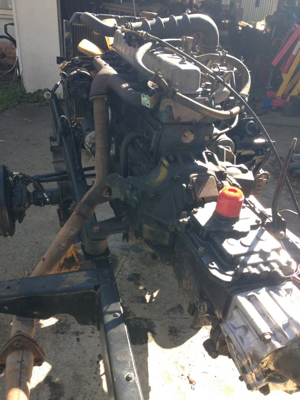

I found out today the H diesel engine and gearbox are mounted around 2 inches forward compared to the 2f motor and box. The front shaft is shorter and rear longer so I'm now hoping the gear and transfer levers will still clear the engine cover if not I will need a diesel cover. I cleaned the 1980 prop shafts up and rattle canned them black enamel I left them baking in the sun while I put new shoes in the park brake and also replaced the rubber brake hoses.
Slow going but I'm getting there. :)

It's looking good mate
I will have to come see it in person after my 75 series is done
Good work mate nearly there now

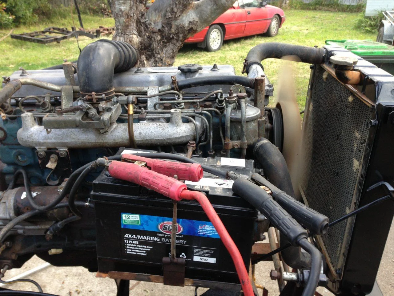

Yeh mate full crawl ahead now but I'm smiling because the engine is running strong with only a filter prime with a sniff of either to fire.
I will need to rebuild or update the alternator as its pumping oil instead of pulling a vacuum so it must be stuffed.
If I need to upgrade the alternator I will try and find a 150 amp to run twin thermo fans + dual batteries for the ramsey winch.

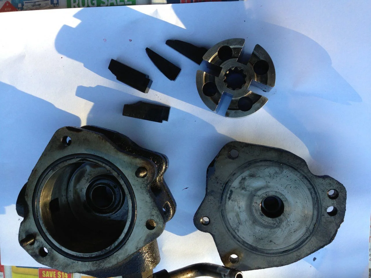

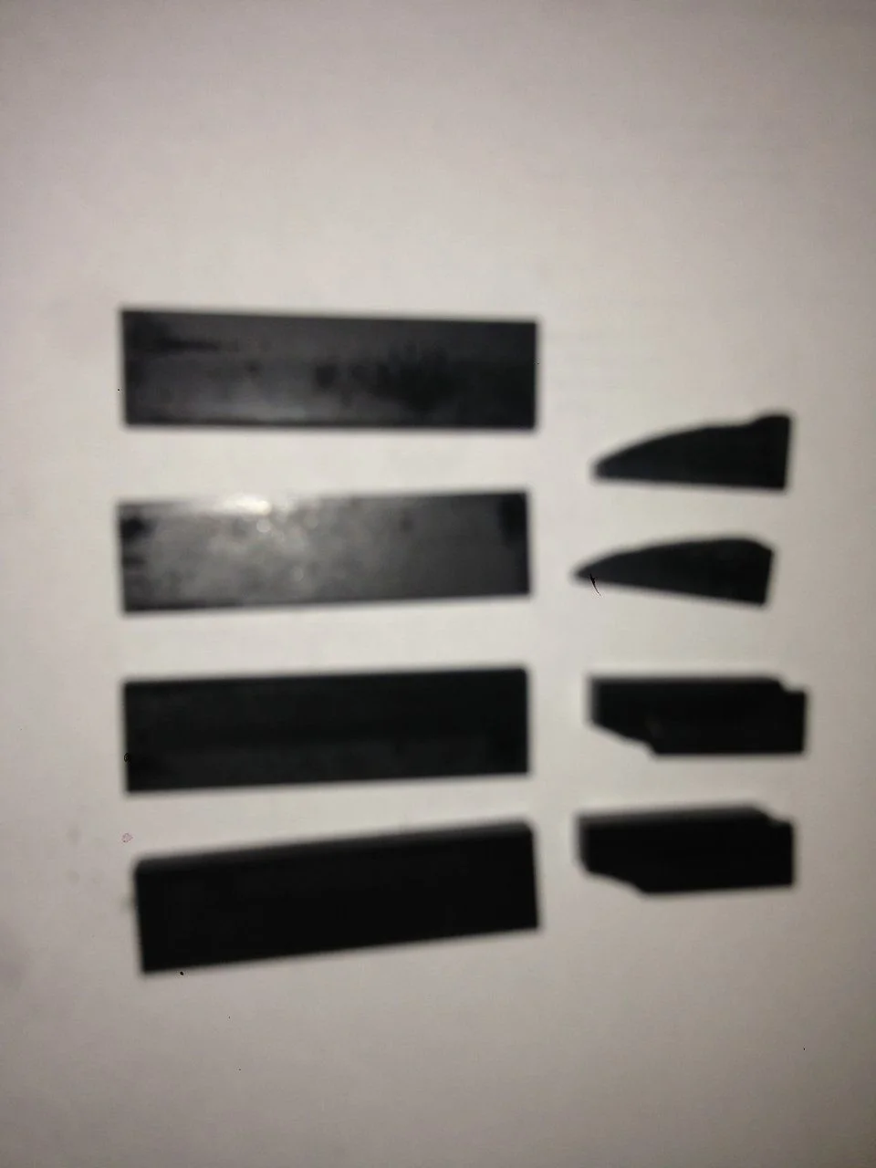

I decided to run the engine again and the vacuum pump one way valve must have jammed open with piece of the old carbon vane dumping a few quarts of new oil over my driveway. The vacuum pump and broken carbon vanes.

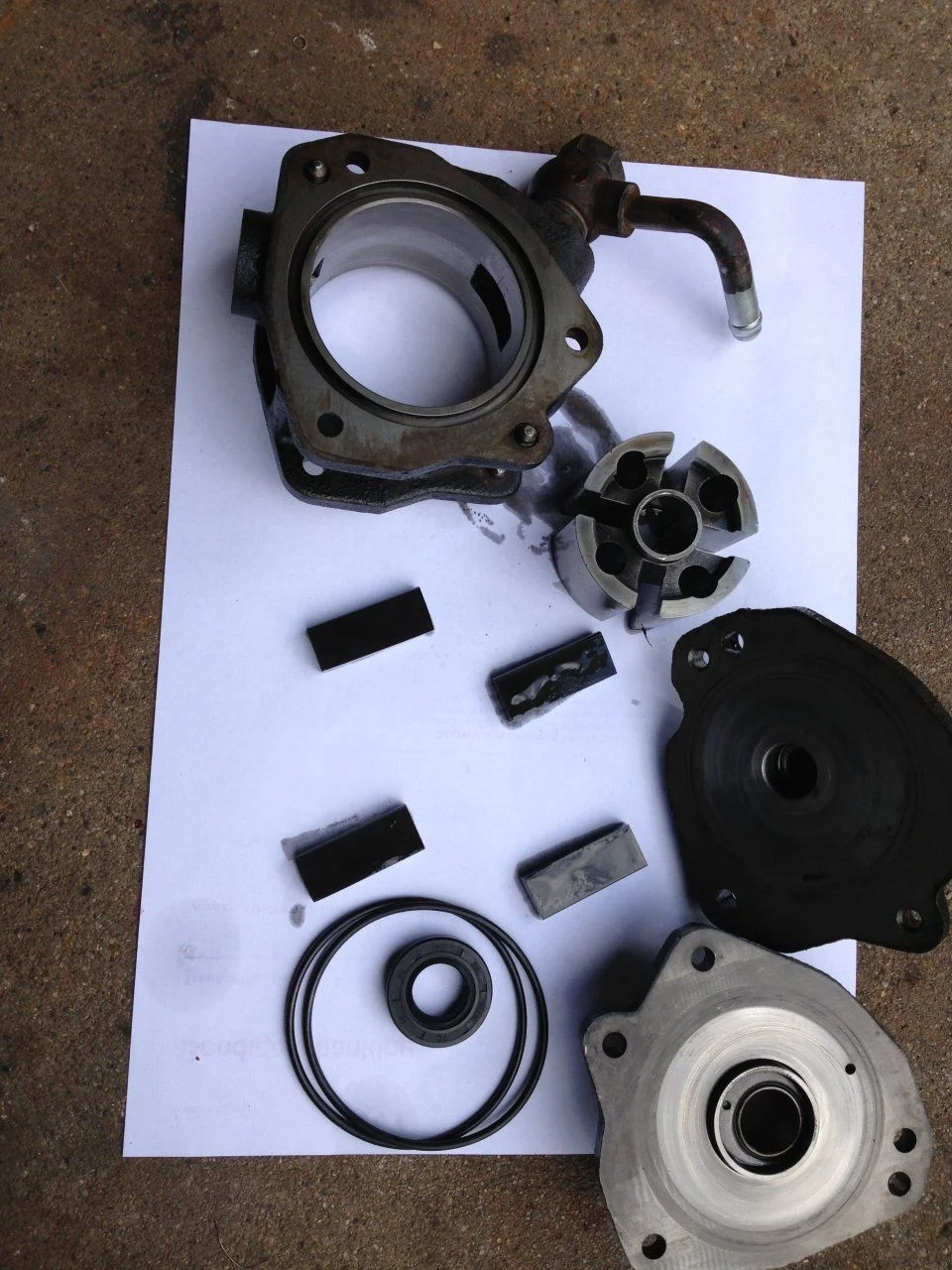

I was lucky and found a good set in a old truck vacuum pump vanes that where the same thickness but larger.
I cut the carbon vanes down with a hacksaw and finished them off with emery cloth over 3 hours and then cleaned and rebuilt the pump.

More oil on your drive way gees mate sounds like you fixed it though
