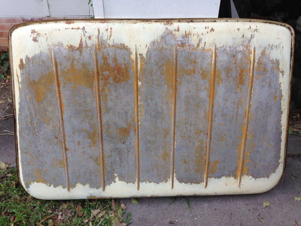

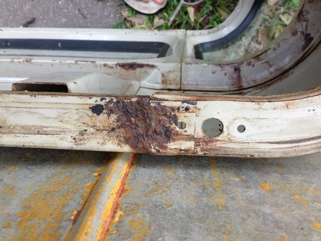

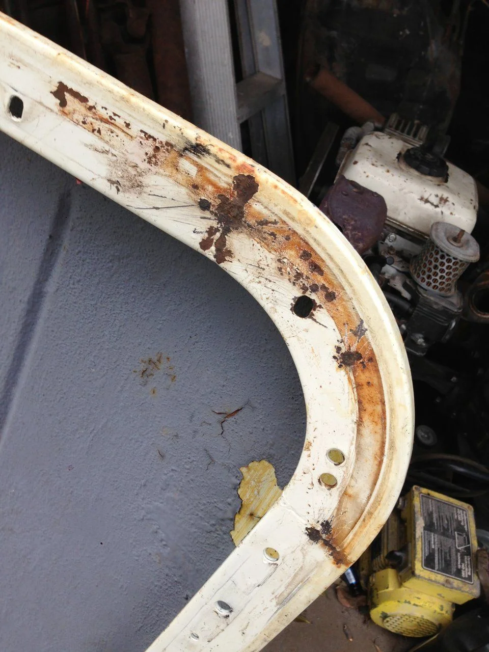

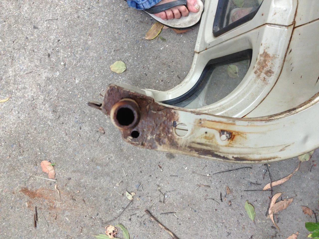

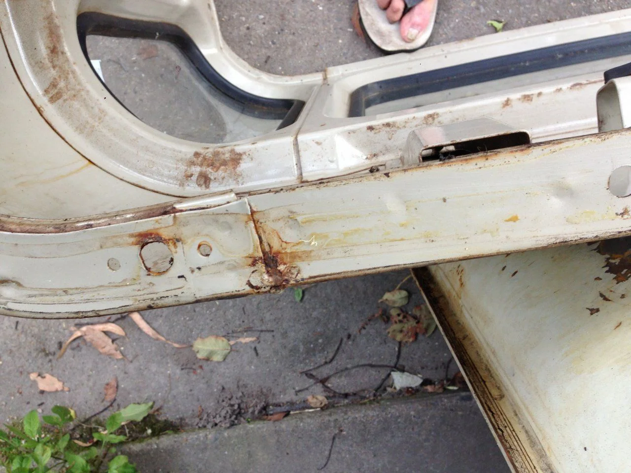

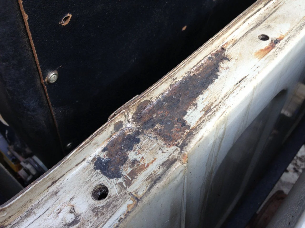

I soaked the roof in vinegar with a old blanket to remove the surface rust. I then pulled roof and rear panel and rolled the windscreen forward to check for rust. I found a few holes considering its 36 years its not to bad

Great condition for its age keep up the good work

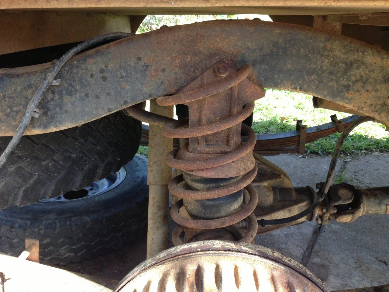

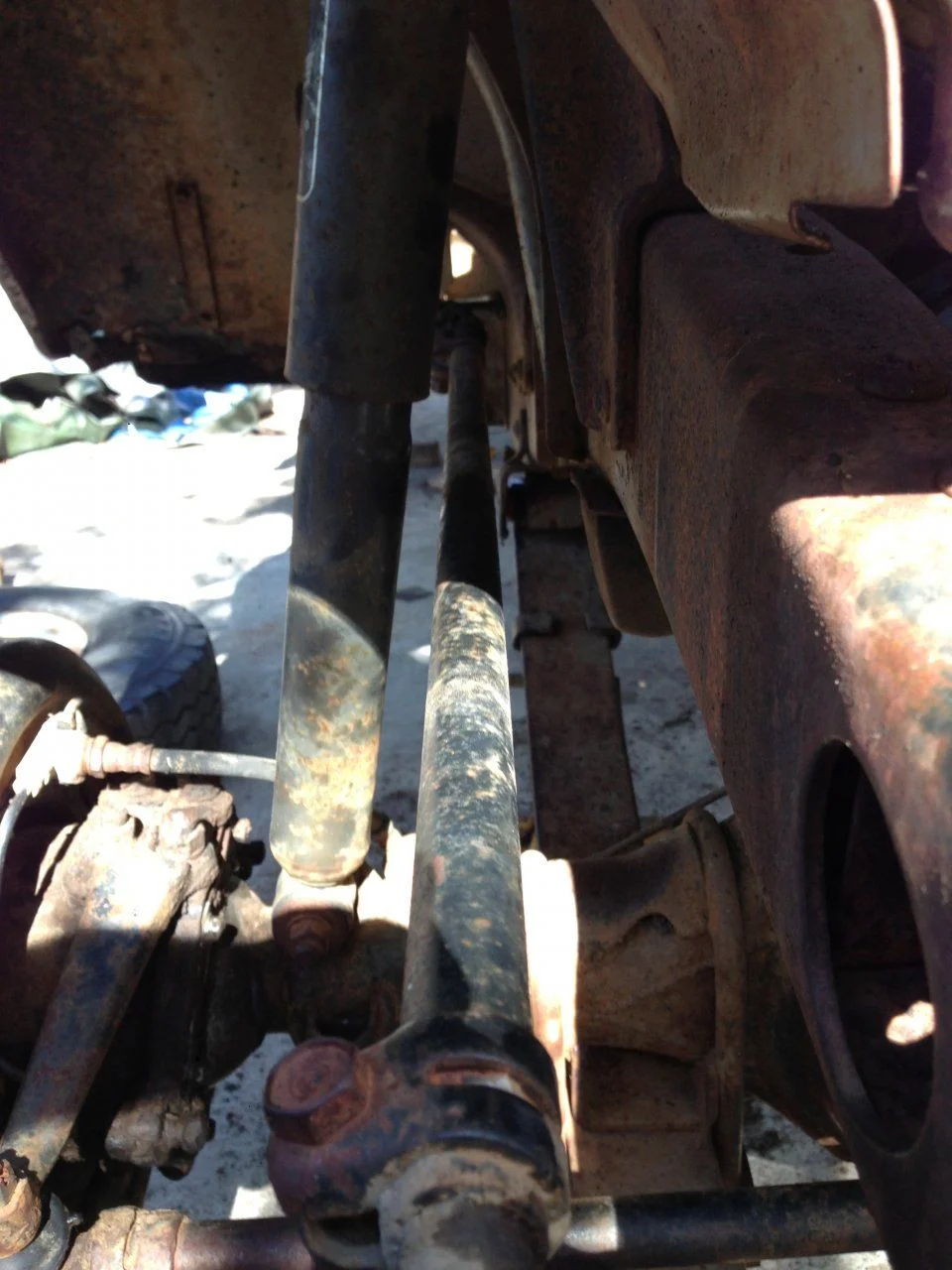

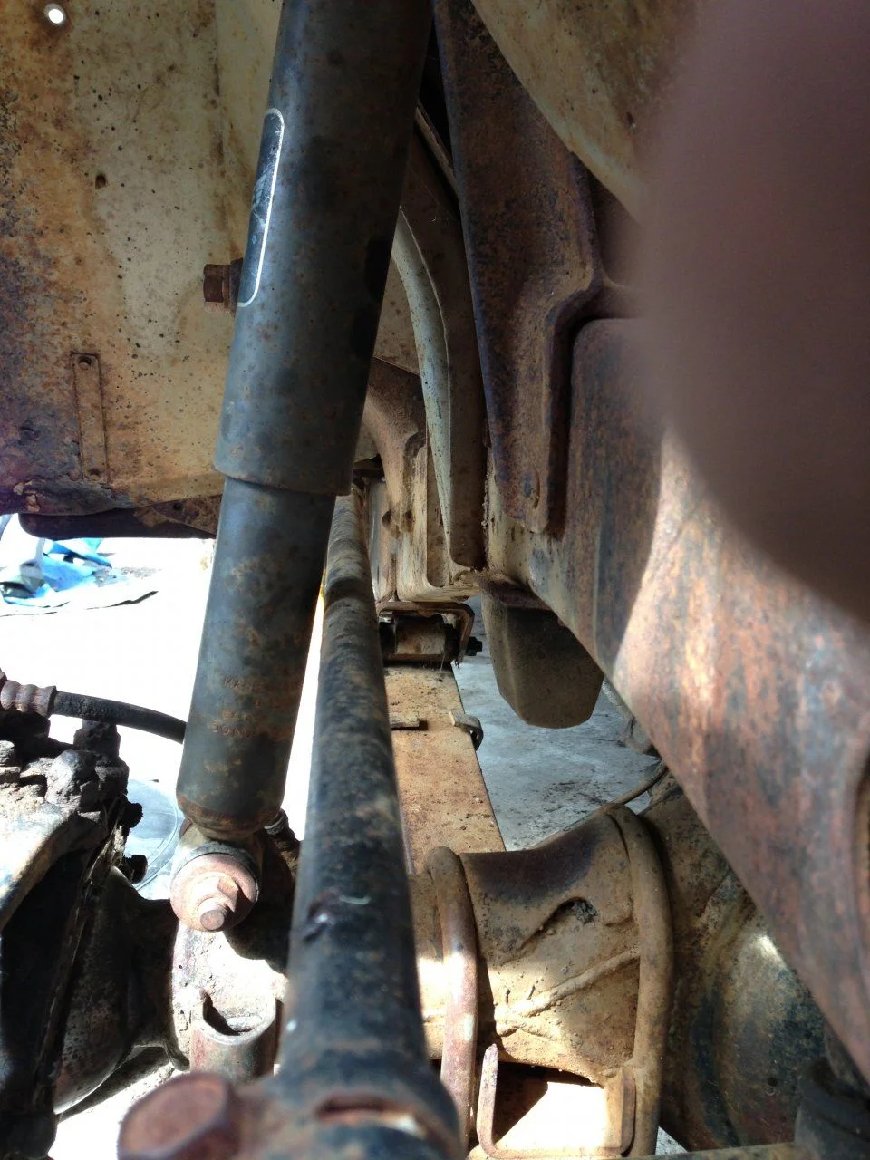

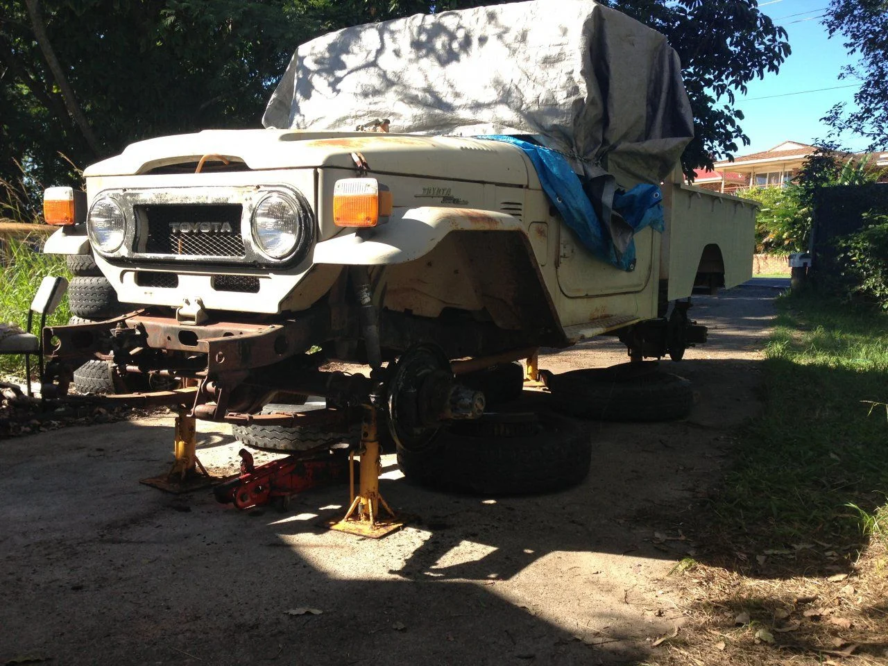

I dropped the front suspension down to fit new bushers and found the draglink hitting the shock. Photo 1 diff hanging under chassis with draglink hitting shock. Photo 2 diff jacked up to full height with 1/8 inch jap between draglink and shock. I was about to order heavy duty gas shocks all round but I best to my homework on whats the best option. I included a photo of a overider on some of these old mine trucks that carried heavy loads. I will strip these of before painting chassis rails.

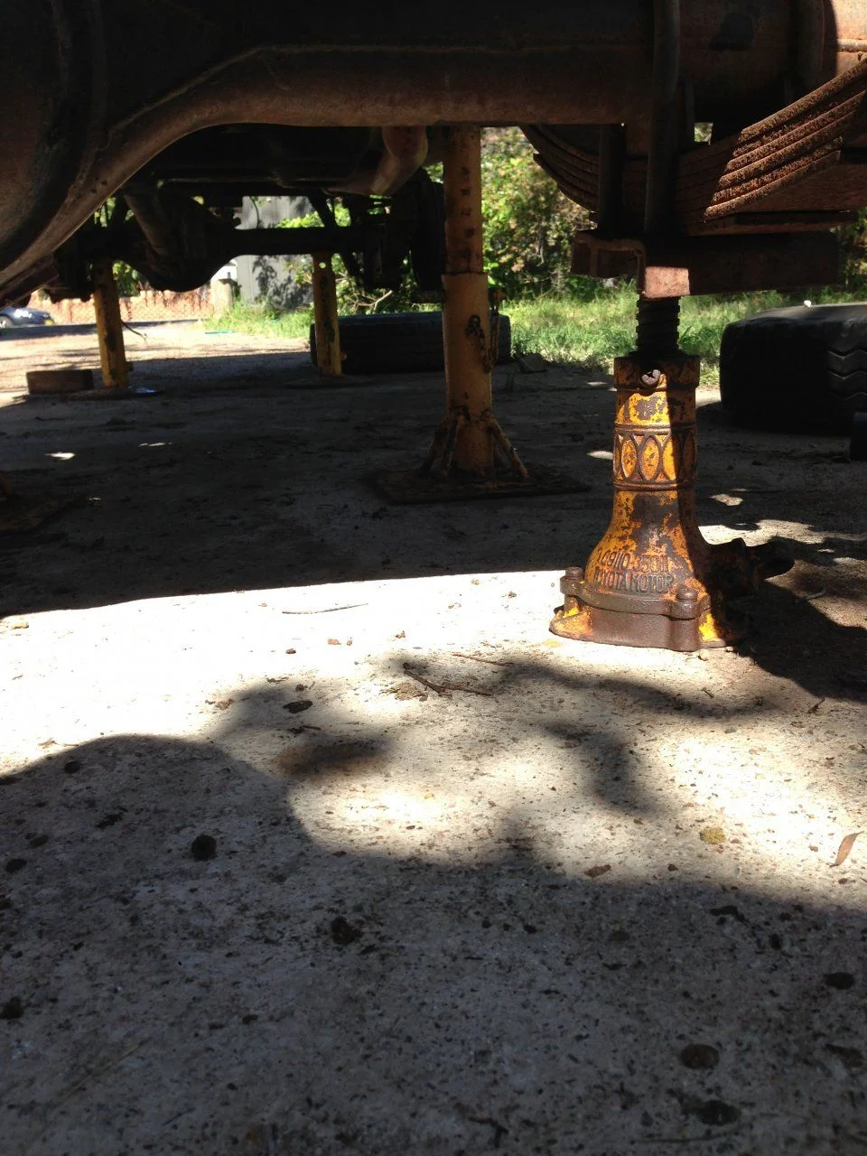

I dug around in my parts bin and found a 1980 hj45 center arm and bracket assembly thats will move the draglink over 1/2 inch it also tilts it away from the shock so hoppfully it will clear the heavy shocks I want to order. I fitted it up and there is around 1/2 clearance with suspension fully down. I pulled the front shackles and rear pins and have them soaking in viniger to remove rust and old paint. Stock jack in use so I had to put a photo of that in action.

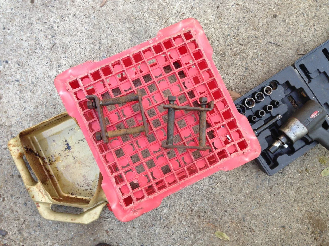

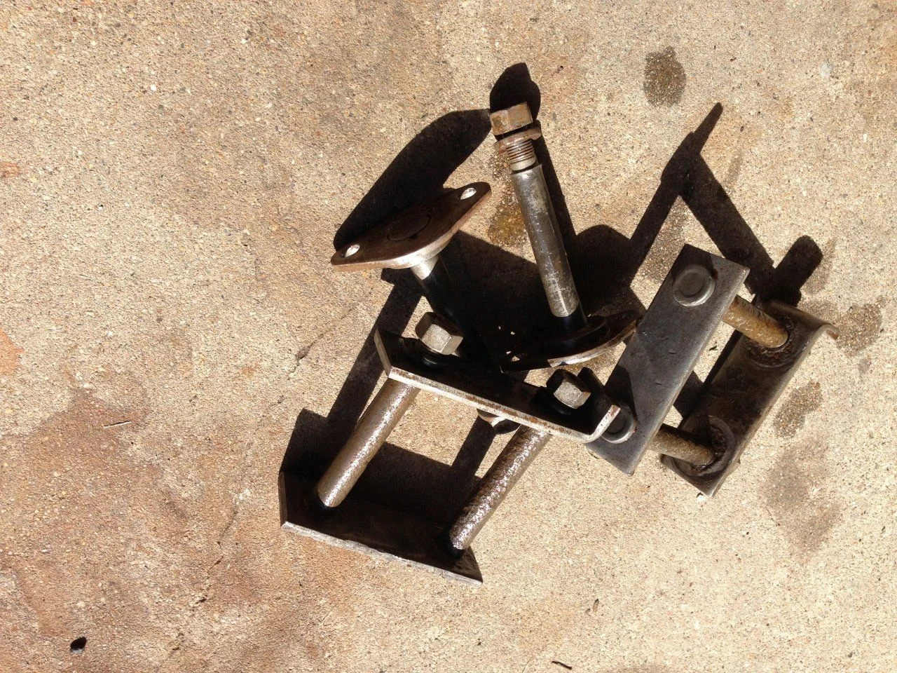

This shot is 18 hours after putting the old shackles in the vinigar. I know there stuffed but I found out my front leaf springs need replacing so these will do to keep it rolling untill I find a replacment set

That worked pretty well neat trick

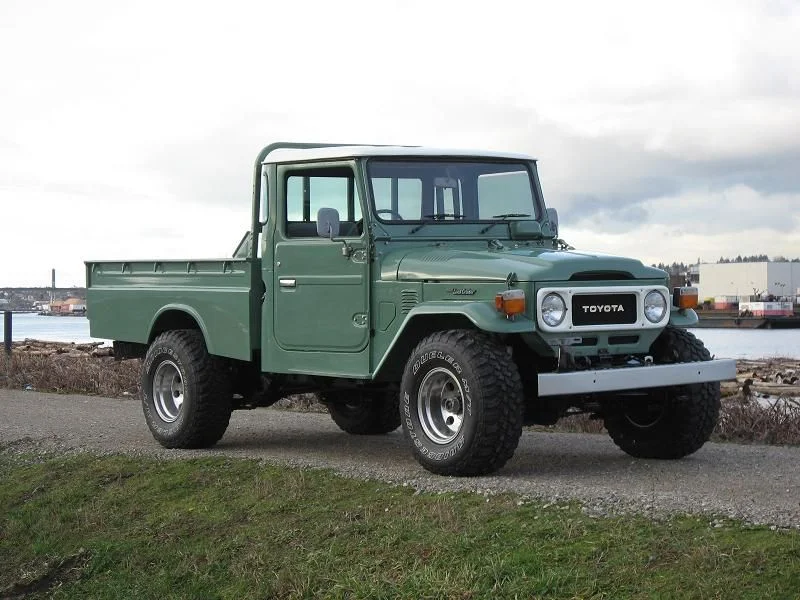

I finished off the shackle rubbers all round and replaced all the rubber brake hoses over the weekend. I had a 1980 master cylinder laying around so I rebuilt it today and went to fit it but discovered the old one been replaced in the last few years. I stripped it down checking the seals and put it back on for now. My plans for next weekend are to strip the ute tub and front end to pull the engine, gearbox and transfer. I also fitted the water and radiator overflow bottles on a timber mount I fabbed up as a templet for a steel mount. I have also added a photo of the color I hope to paint the 45 in the next few months

That's a nice green definitely paint it that colour

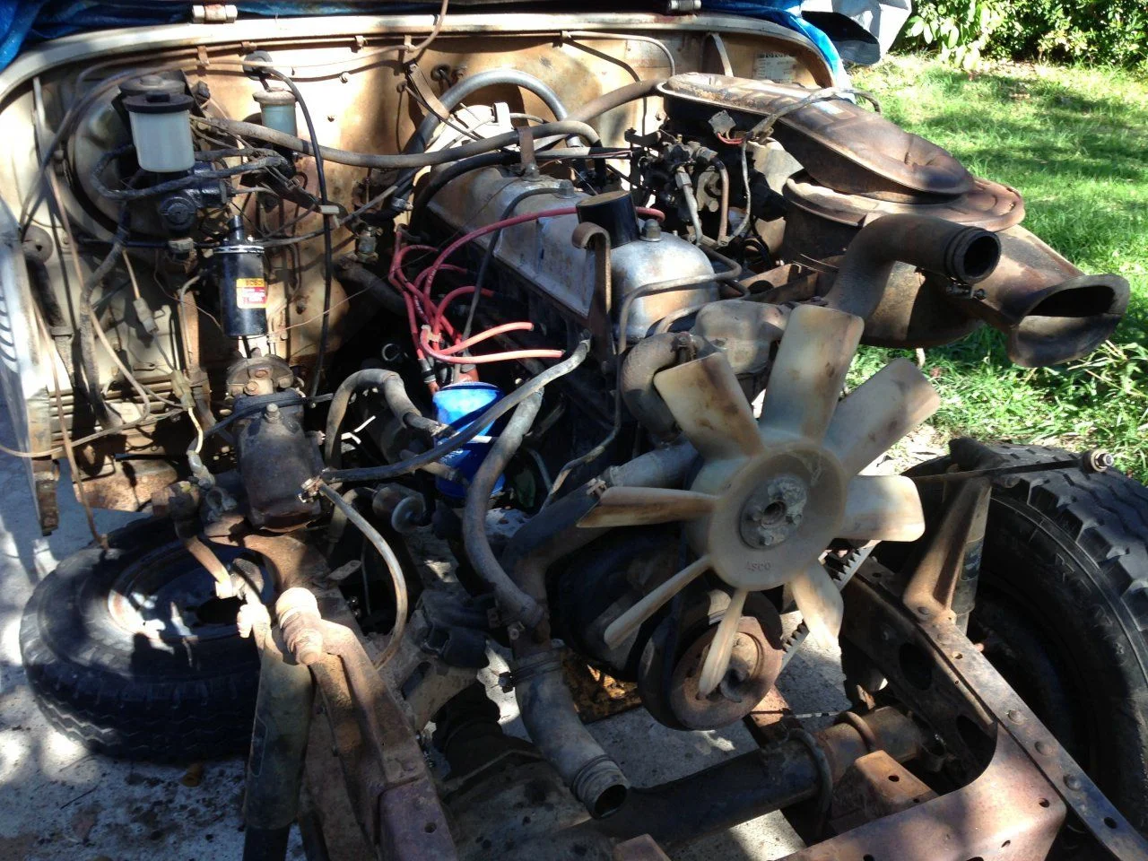

Done a few more hours today stripping the front panels. I have been very lucky only snapping a few bolts with the trusty rattle gun. I have been giving all the bolts a spray with WD40 over the last few months so it must have helped. The 2F should be out by tomorrow if there's anyone who needs a engine speak up as my shed is filling up fast so this is on the hit list for removal and it will be stored outside under a tarp.
