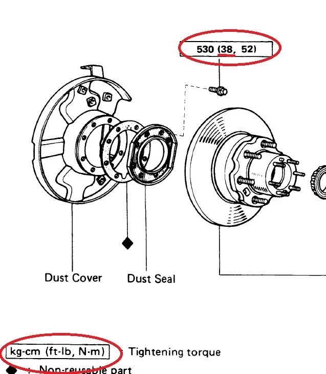

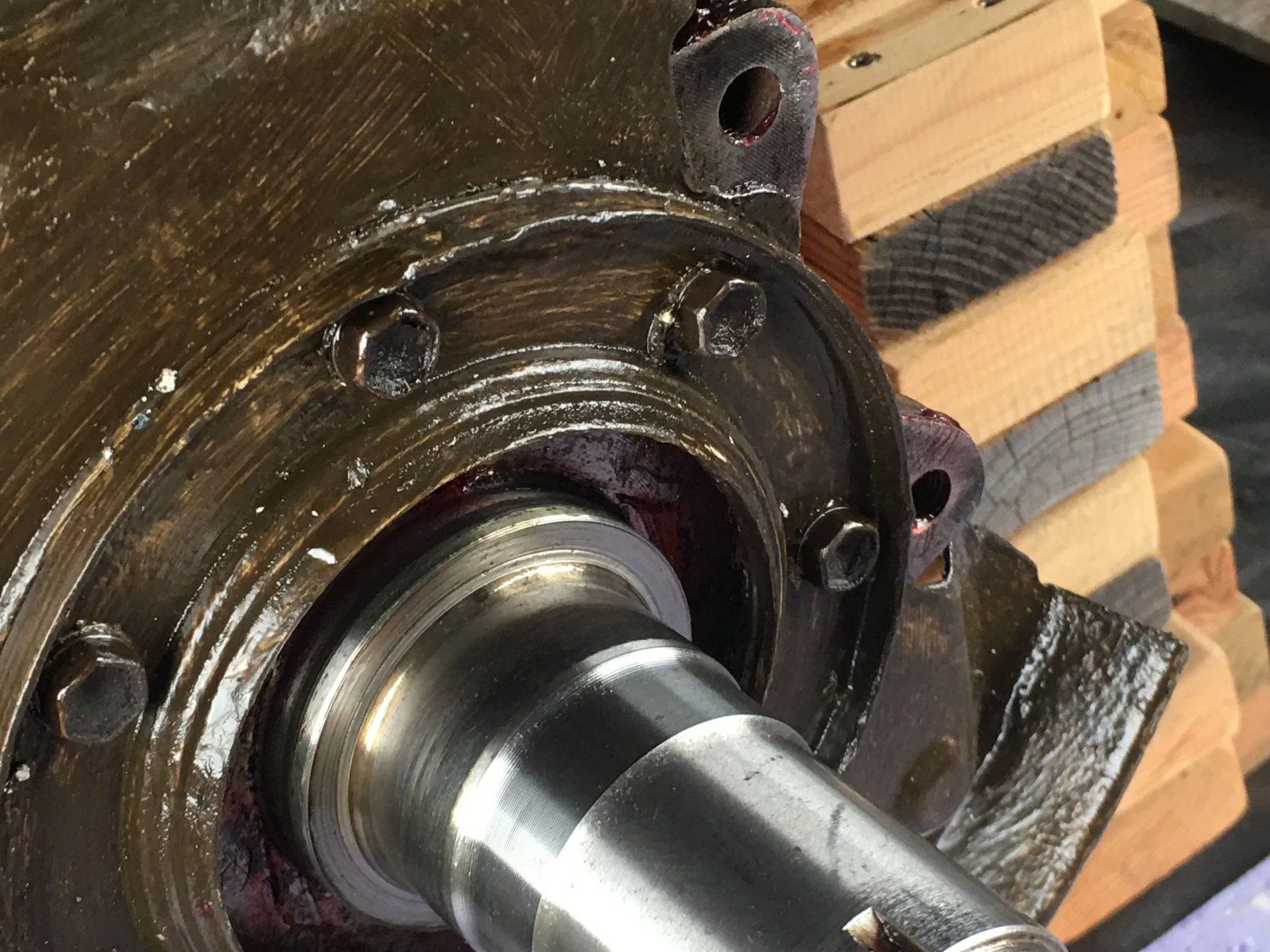

Anyone know the torque setting for these bolts? 91 4wd toy pkup, front spindle. 12mm
Looks like 38 ft-lb.

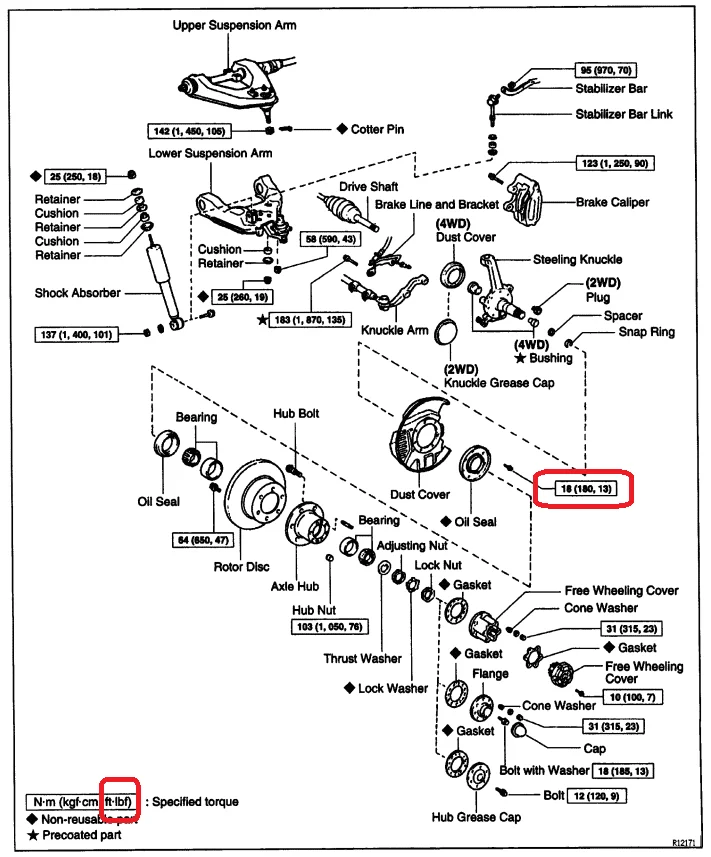

I'm seeing 13 ft/lbs for the bolts that hold the shield to the hub.
My general rule of thumb is 15-18 ft/lbs for most any bolt that has a 12mm head
