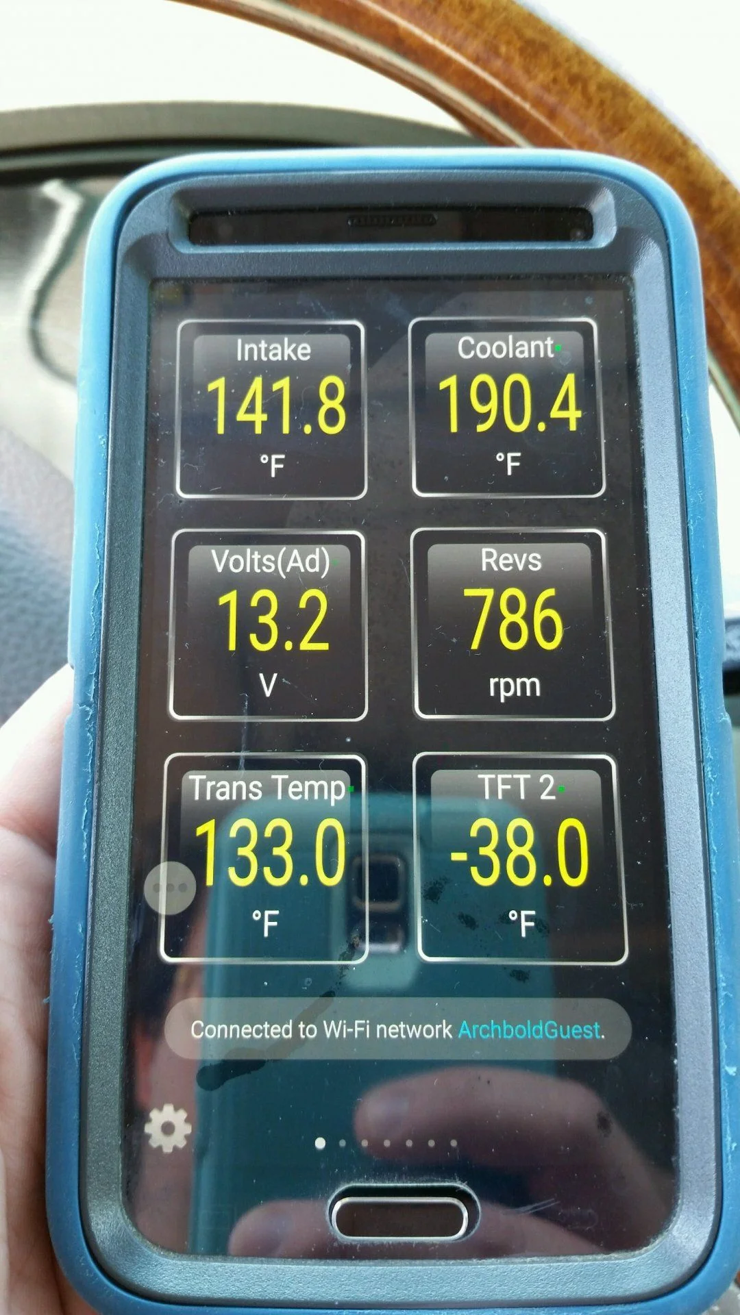

I believe tft1/trans temp is correct temp mine is around 120-140 deg f and went up with hard acceleration. Max seen was about 142 deg. TFT 2 is off and varying from -38 to 350, not sure what reading it was picking up.

Ok guys I am hesitant to say I have figured it out but I did get at least 1 number fitting with what I would expect for the trans temp. I found this code for a 2005 Sienna and it appeared to work on my 2005 Lx470. Here is the scangauge code i used as well as the Torque codes I built using the calculator recs online. Let me know what these codes do and if they work.
I hope this works. I was reading 115 deg on sensor 1 and varying from 77 to 250 on sensor. Will have more info when driving later today. This was just trying in driveway after returning from church.

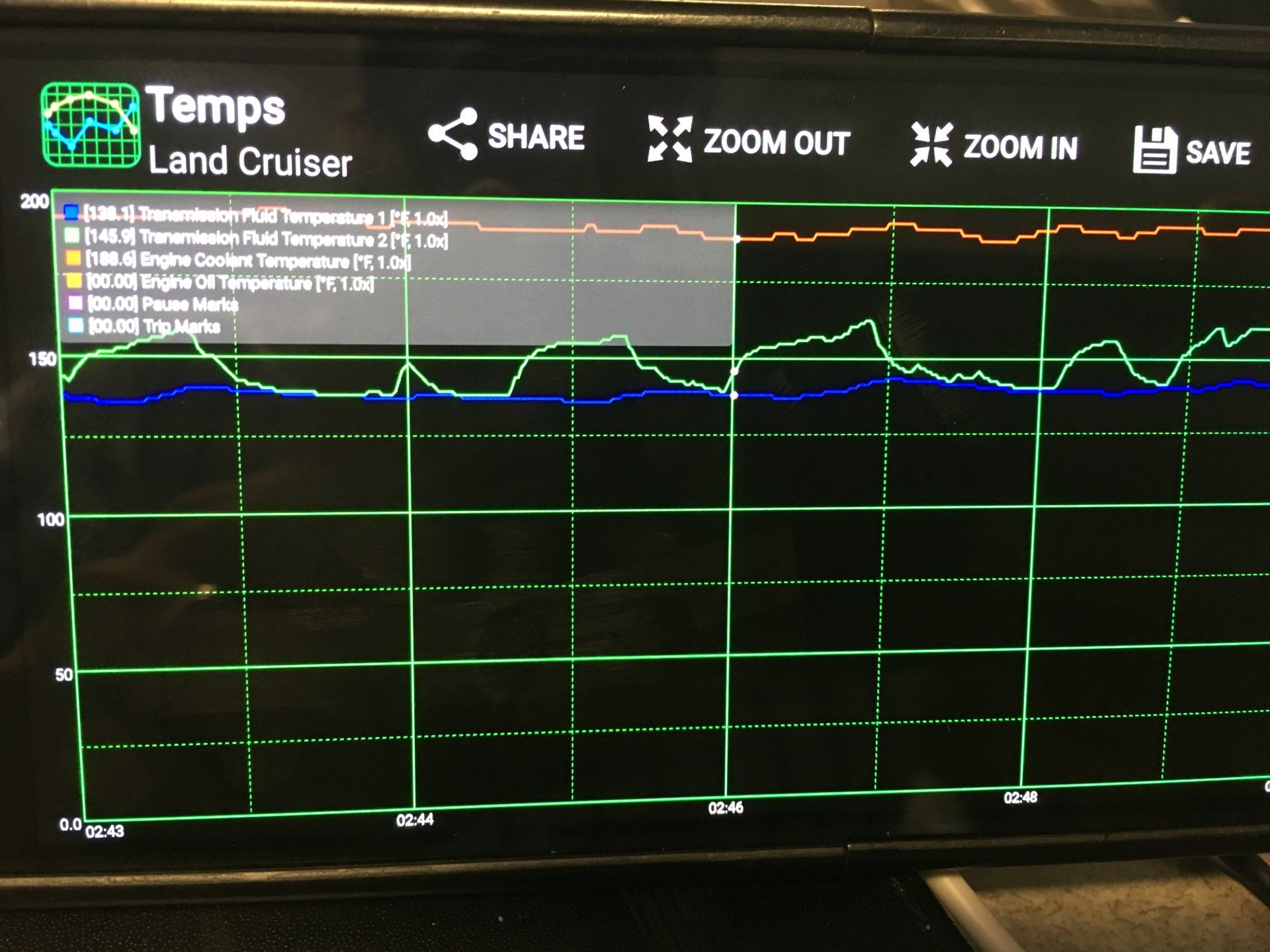

So I have two custom sensors set up. To do this from the main Torque screen click the gear icon to go to settings, then scroll down to "Manage extra PID/Sensors"
The image above includes all the particulars you need to set it up for your app. I then set up a custom real time chart with TFT1&2, Engine coolant temp and engine oil temp. Torque seems to automatically include pause and trip marks. I can't get a reading for engine oil temp, but the ATF temps seem to be displaying correctly. What do you guys think about the temps in the graph below?
looks like mine mostly. I don't get above 200 on coolant and I haven't seen above 150 on the tranny. Using the same equation as you, but only the tranny #1 temp. If I were to graph, they'd look like yours. Is that a 4 minute time frame?

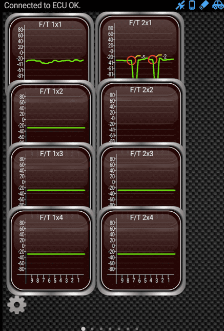

Anyone see anything like this ever happen in their fuel trims?

Veepeak OBD2 xmtr, Torque, PixelXL, 98 LC.
I would say comm drop-out but it is almost always 2x1 and 2x2 that are the problems, but once in a while 1x1. Inconsistent too, sometimes all are fine all the way to work. I have had bad mpg (12) so trying to troubleshoot, and that's when I started noticing the drop-outs so no prior experience to compare to.
I also find it odd that 6 of the 8 seem flatlined.
Ideas/things I could test?
did -30 become the new zero while I was drinking? lol sorry.
Mr Dave, something is off with the scale. Long term should be +-10%, short term +-5% give or take a few. Look in techstream. I think if you were running in open loop you'd get a light. If there are no drivability issues I wouldn't assume there's a fuel delivery problem.
I think there are only long and short term, one each per bank.
The numbers on the bottom I'm referring to
put up rpm on the graph also, then put short term fuel trim, egt pre cat and o2 voltage.
JK, I think it's great man. Amazing what can be done with 20$ these days.
15 years ago it cost a boatload to monitor and log all those sensors live.
That's a four second interval on the horizontal axis.
