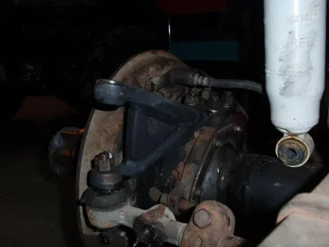

Front axle isntalled, Custom free high-steer set up with some donated parts from the Red Dwarf we purchased earlier. Still trying to figure out what tie-rod to use from the pitman to the drag-link. Having a hard time finding something that goes from an FJ60 box to an FJ40 knuckle. Any ideas?

I think that's about it for now, sorry the pics kinda suck but I was in a hurry. I'll try to get some better ones up soon.
