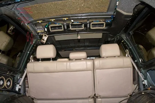

^ No Doubt, lost some tech in there too. As I stated above, I have zero interest (and I think most others would agree) in a version that utilizes the existing side mounting locations. It would be way too easy to run into it at night or just while not paying attention potentially breaking a $800 window and damaging the other parts. The only solution that would fly for me is something similar to the 60 series one where the windows open upward and out of the way. If you guys are anything like me you keep your tail gate and would probably keep these open for extended periods while in camp.
Hard to say by this photo but It looks like there may be plenty of potential existing mounting locations. That's the biggest hurdle I see making this happen.
I gotcha on the existing hinge and agree. I think it was originally thought of as a way to just cut some corners and do it a bit easier.
