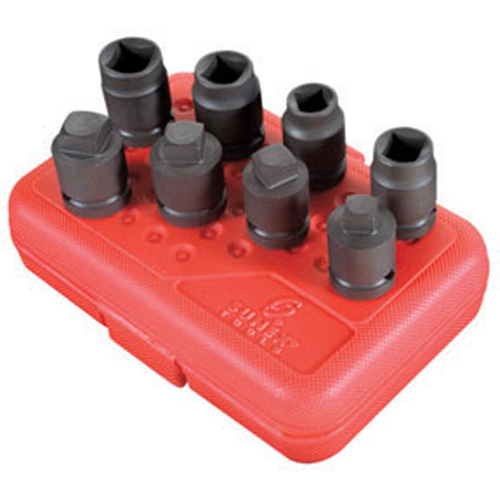

Any advice on a tool to crack the block drain bolt to flush the coolant on a 2F? This seems like a pretty good option.
A couple years ago, I did a halfway job with a coolant refresh because I couldn't get that little square 13mm drain bolt loose with a puny box wrench. I picked up a six-point 13mm impact socket, but it doesn't seem to fit the square shaped bolt. Thanks!
12 point will fit a square plug.
8 point sockets work better and less chance of rounding the corners

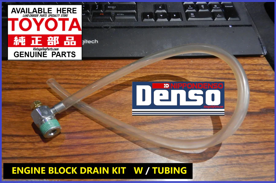

Small change, but the drain from the 3UR looks very similar with the exception that it has a spout built into it. No tube needed. Just have to use a bushing to account for the fitting size delta.

3UR BLOCK Drain looks this , and has a ODD spout that will make the use of the WIZ-KID full proof anti-spill in your face / burn your arm pits with scalding coolant ,
the use of the CLEAR tubing approach to draining the block , is simply the use of MODERN materials with a purist oem Toyota mind set approach
the use of a clear tube directly in a bucket , is green theme for out environment too :cool:
any thoughts on witch one is more F / 2F / 3F / 3FE owner operator friendly ?

i have these NEW Japan spec. OEM TOYOTA Engine Block Drain w/ Molded Tubing Kits listed now via online parts store
and
YES , it fits ALL land Cruiser F series engines 1962-1990 F F1.5 2F 3F 3FE

square plug sockets are called pipe plug sockets, they come in male and female, 1/2" or 3/8" drive

they are commonly called "pipe plug sockets". use that parameter and you'll speed up your goggle search
