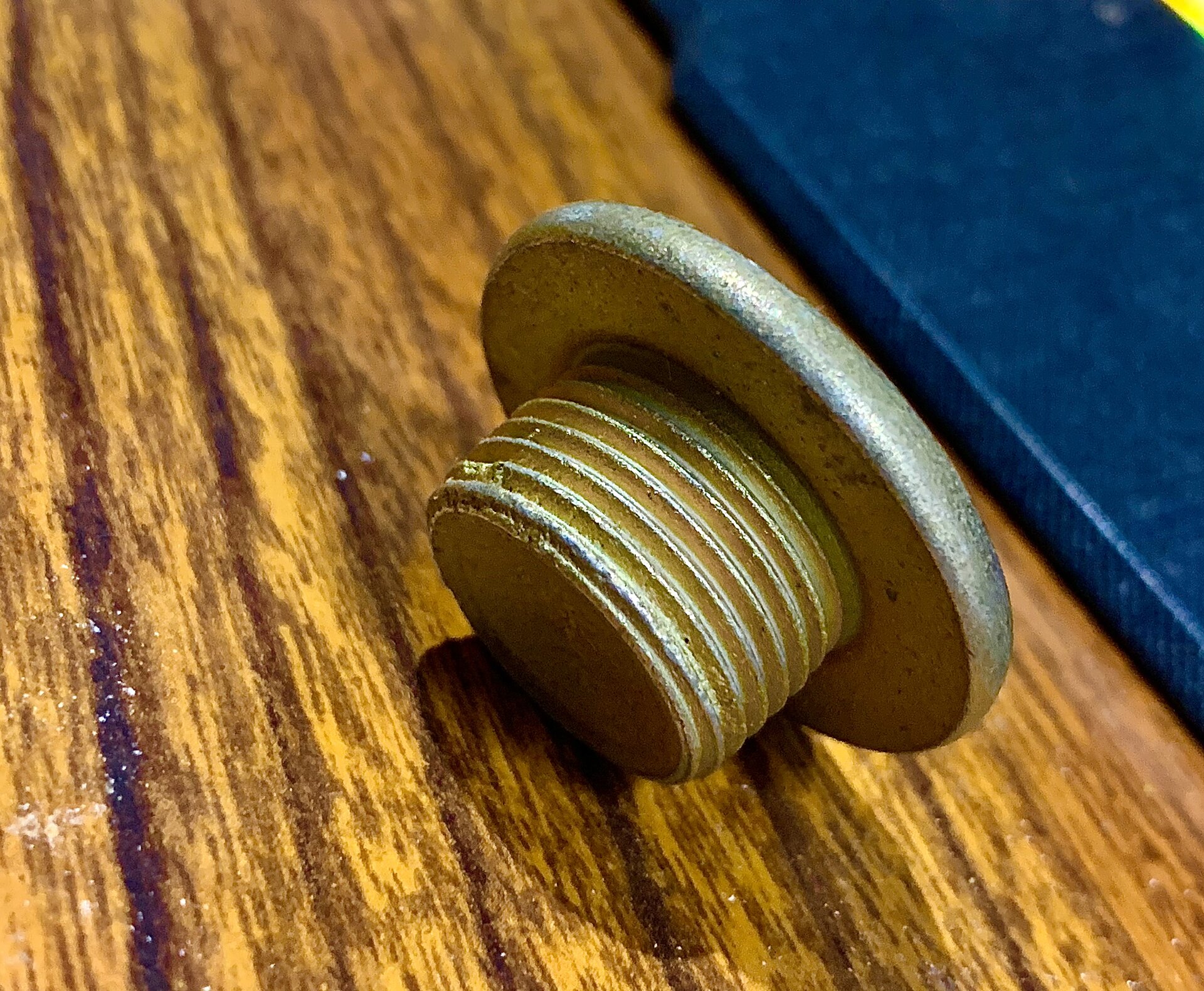

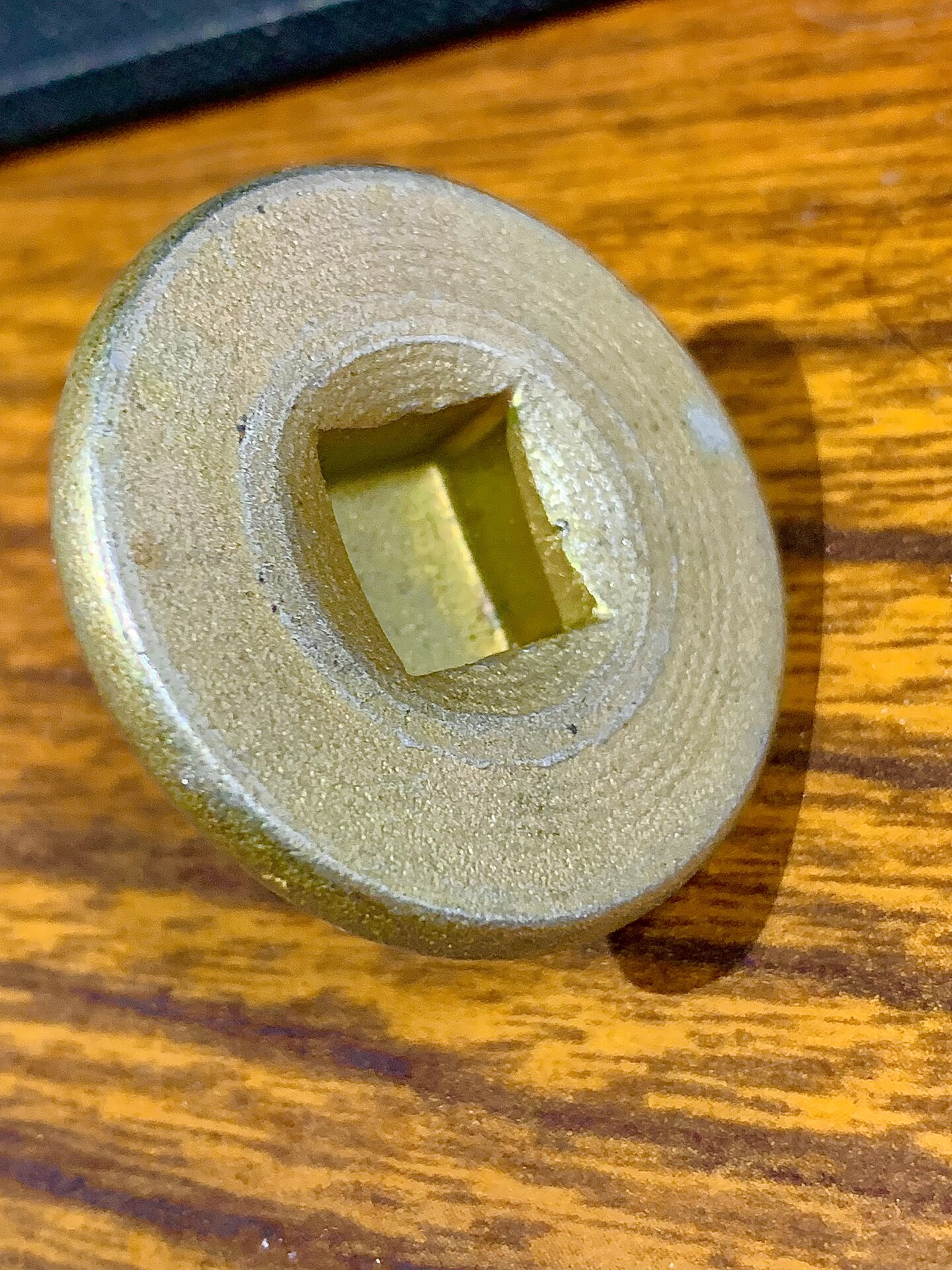

If they are flanged with a gasket or copper crush ring ,they probably aren't a pipe plug. Probably just a metric thread with a hex drive.
The theory with pipe plugs in dependent on their taper. No gasket required
i am hunting hard as we speak for a worthwhile period correct JIS substitute for the NLA / Disc. 1/79-10/85 gas tank service plug specimen oem example i have had since high school below .......
- Toyota did use the Square Female style service plugs from 1962 - the 10/ 85 HJ47 pro-date circa. era-time-line ..
- not any more I do not think ?
- recessed female hex-style like you mention above is now global Toyota OEM standard across the board …
- also , fine threads verses coarse JIS thread pitch is at play here too …
so far no luck ...:confused:
