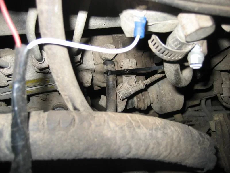

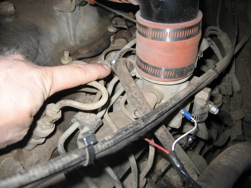

So once i'm stop again, i check the hose and it seem ok, but i don't trust the T i installed with the bad connection that came with the boost gage. So i pull it off and find a plug. I try the truck again and same thing. So i start looking around and find that the hose from the throttle body that goes on the fuel pump was disconencted. So i reconnect it and put a tierap. And that was it. What is that house for? Seriously the increase in power is mind blowing (i guess for a turbo engine).
When i removed the T for my boost gage i did a few hundred feet to test it. But i had to turn around, you should have seen the cruiser spin the wheel and lay some good rubber on the tarmac...

But what is it for?

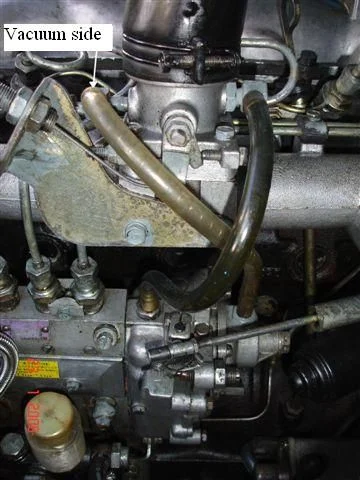

. (I say this because of where his hose (that came off) connects to his injector pump diaphragm housing. Bearing in mind that his intake manifold is considerably different to mine - so looking at it alone - I would be unsure which would be the venturi/vacuum connection on it.)
