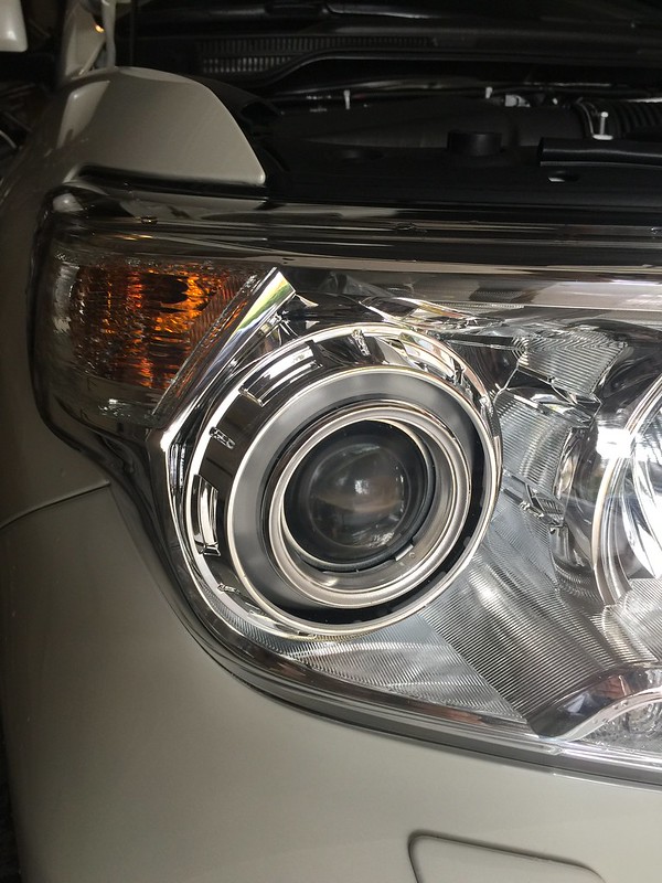

Headlights (low and hi beams) switched to OSRAM (I believe 5500) and hi-beam to LED matching the color temps..
Again from my friends at TRS
I've been meaning to comment...it's looking awesome. I still want those wheels. So, did you replace the low beam bulbs, or did you have someone do it for you? For the life of me I can't figure out how to take out the old low beam bulbs. The highs are no problem, but do you have any tricks on getting access to the low beams?

OK, so I may be a bit slow, but I am also wondering about your headlight bulb replacement. Do you have the part numbers for the Lows, Highs, and Fogs? I am not seeing a vehicle specific guide on the OSRAM website, so if you happen to have the part numbers, it would be greatly appreciated.

If I am not mistaken these are the ones I got from TRS.
31mm Festoon: Morimoto XB 2.0 LED
T10/194: Osram LEDriving Cool White

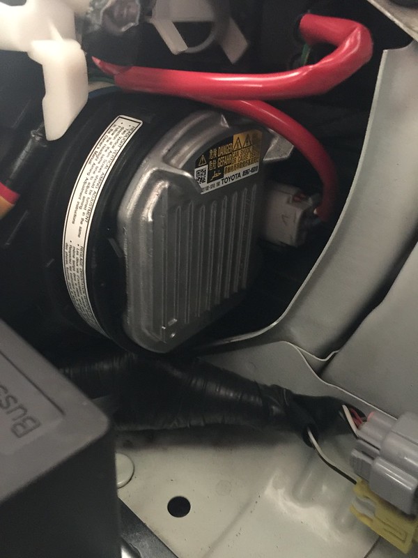

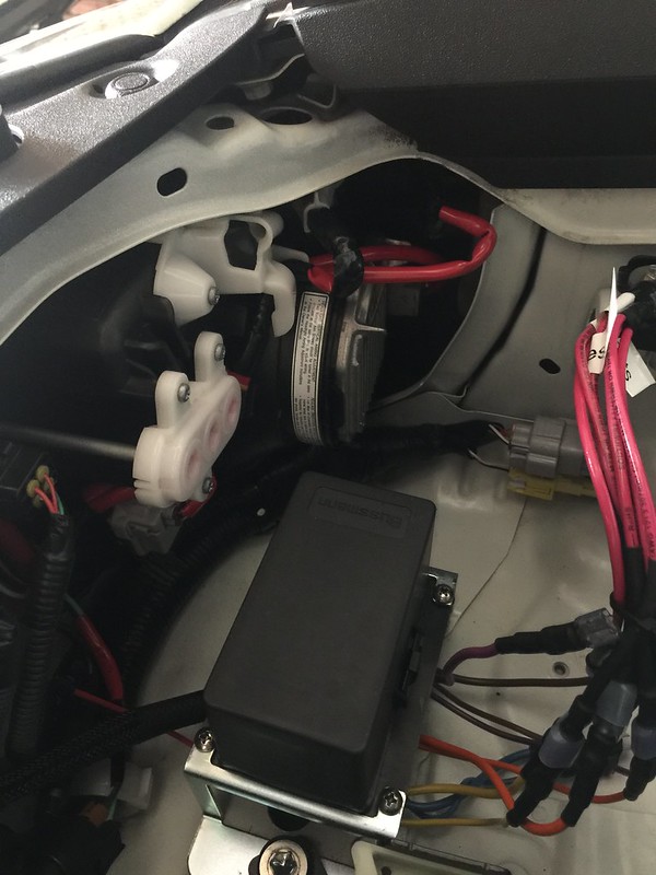

Sorry, I meant how did you get access to the low beam bulbs...not the fogs. I've replaced the fog lights, and yeah, they're a pain. I'd like to replace my low beam (the stock HIDs) with brighter bulbs, but I can't figure out how to remove the stock bulbs.
Thanks my friend, yes I did those myself with the help of Matt over at TRS, its super easy man you just need patience LOL......
Passenger side is super easy, just twist this thing counter clock wise and its out..... it even has some tabs to assist :clap:
To put them back on its just the reverse process.

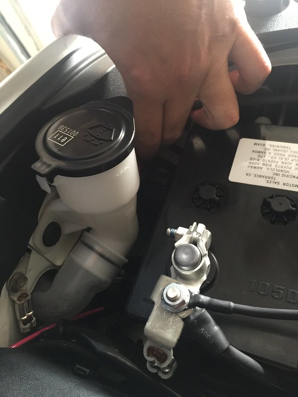

Driver side its a little bitch.... I mean a bit more complicated :rofl: ..... just remove the water spout for the windshield wiper fluid (super easy, just remove the plug and pull) ..... you have better access that way, now its probably easier to remove the battery but I didn't have the patience for that, couple scratched knuckles but got it done.

Okay, thanks. I'll have to give it another go. Mine must be in there really tight I guess, because I couldn't get them to budge...which is why I thought there was something more to it.
I hear you, I just tried it again on mine (pass side) and it took a bit of juice but it came out..... again, counter-clock wise.
