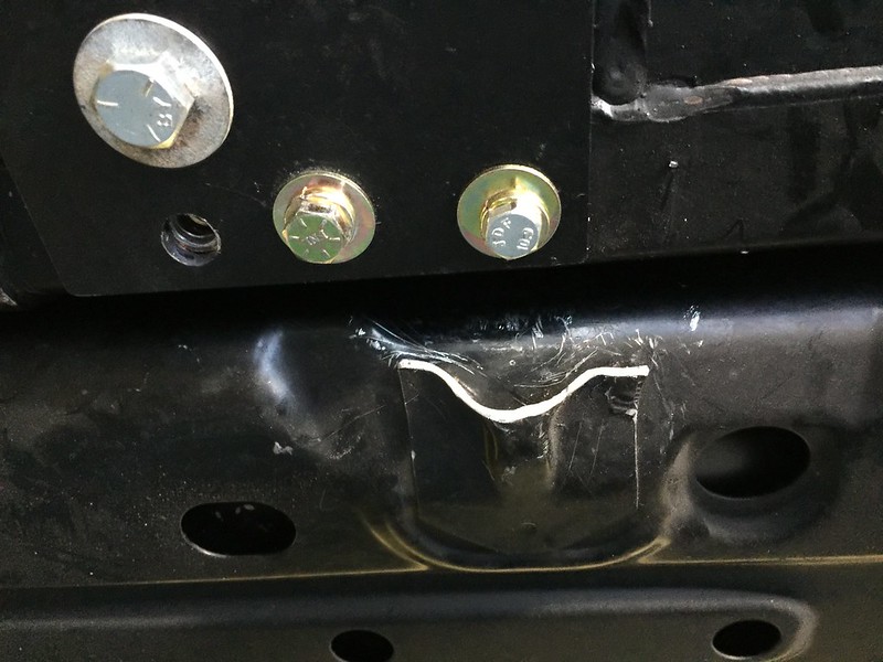

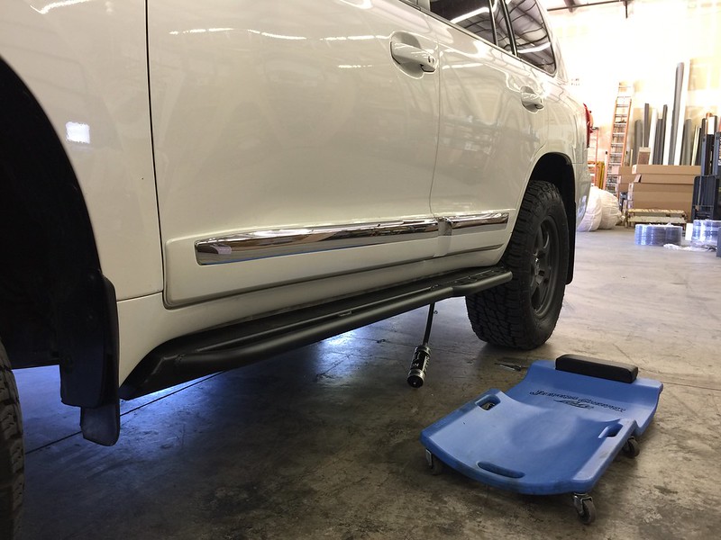

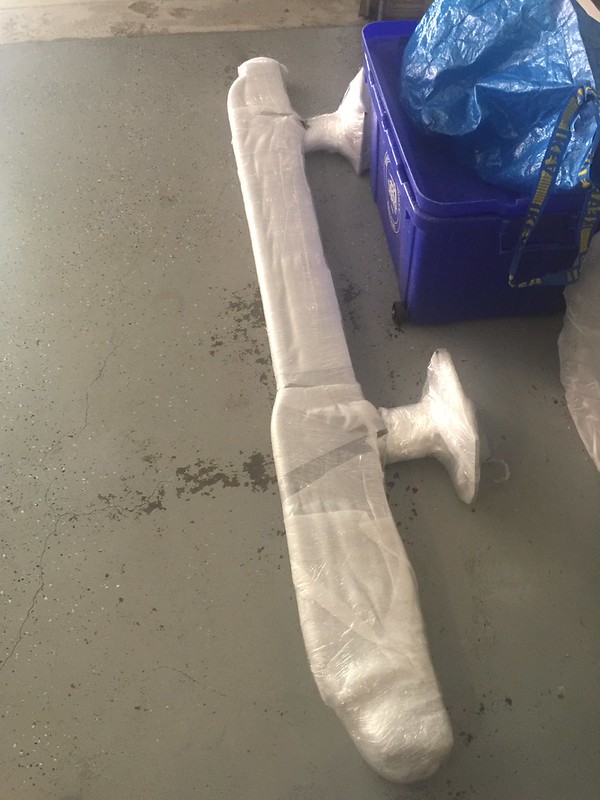

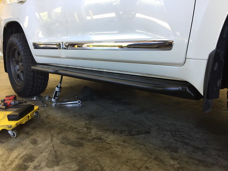

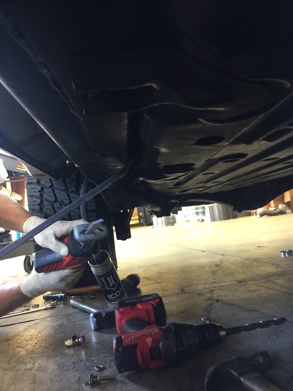

MetalTech 4x4 sliders......

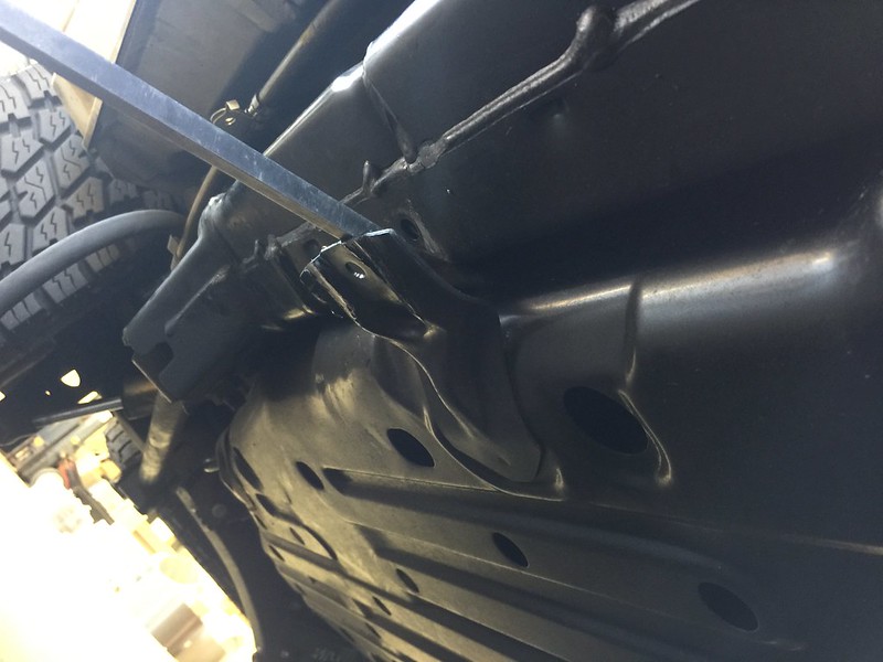

Then a little something got on the way..... :-\ you'd think this was taken into consideration.... some holes didn't align and others that were supposed to be threaded weren't, older 200's must be a bit different I guess?
Had to tap a new hole and cut that Gas Tank Skid tab.....

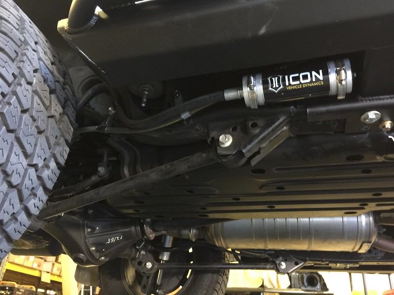

Relocating the resis wasn't bad..
Got this puppy but haven't installed them yet, when I first lifted (I mentioned before) it was sitting too high for my taste so I ordered this to drop the diff (Drop Diff Kit from Marks4WD AUS) as I had on my previous 4Runner.... but then I lowered by using the 2720's and dropped the coilvers up front so I am not sure I need it anymore...... I guess it wouldn't hurt.

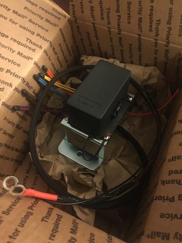

Next up, time for some electronics.... (giddy up)

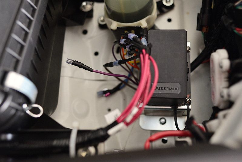

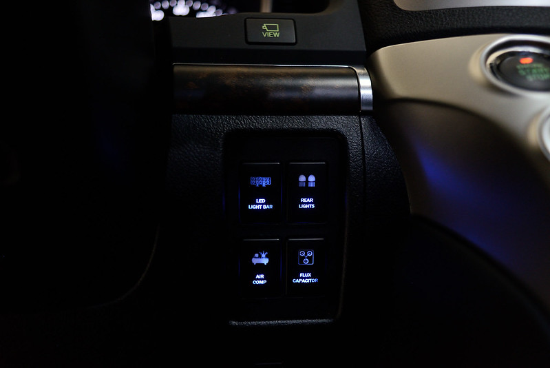

Bussman Aux relay/switch box. (by Wired Wagon)

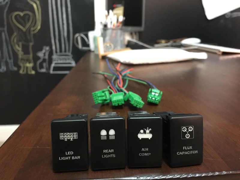

Switches by Air on Board (direct drop-in)

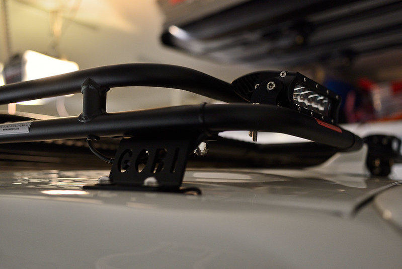

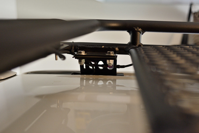

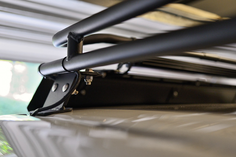

Ran the wires through the windshield channels one side for lightbar and the other side for rear lights, grounded the rack itself to a bolt on the rear hatch.

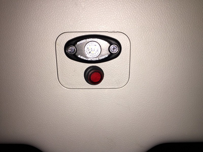

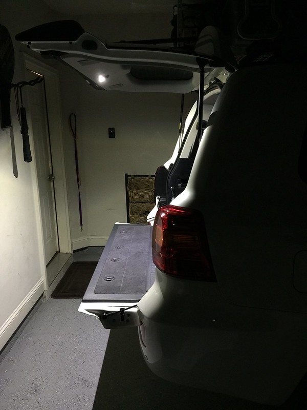

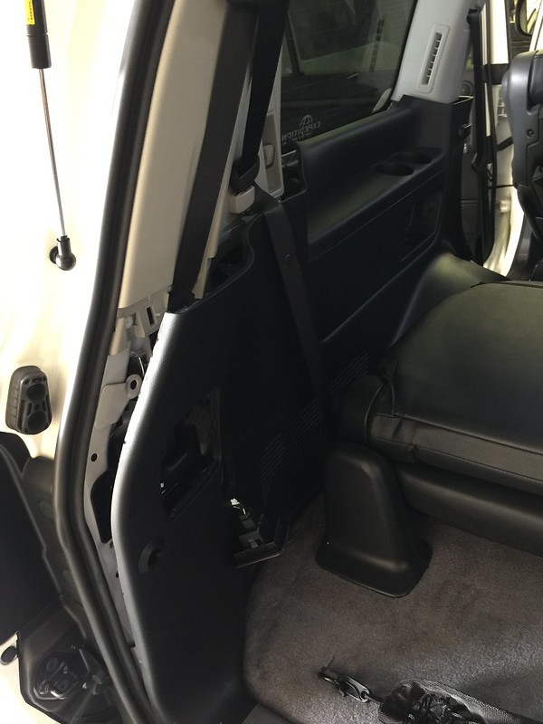

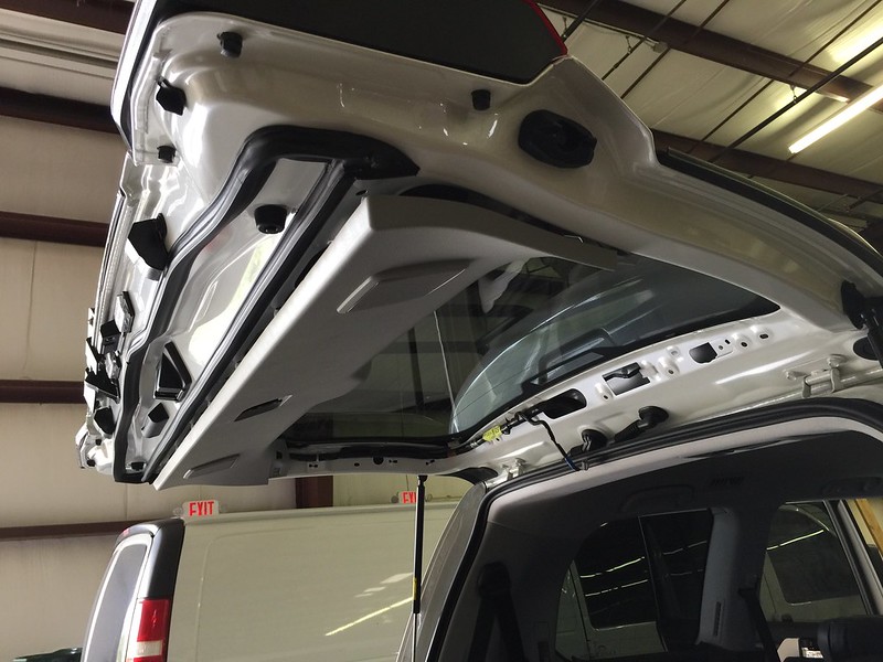

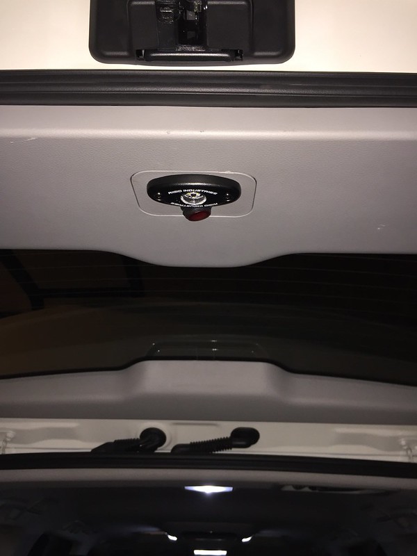

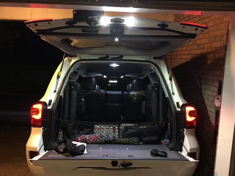

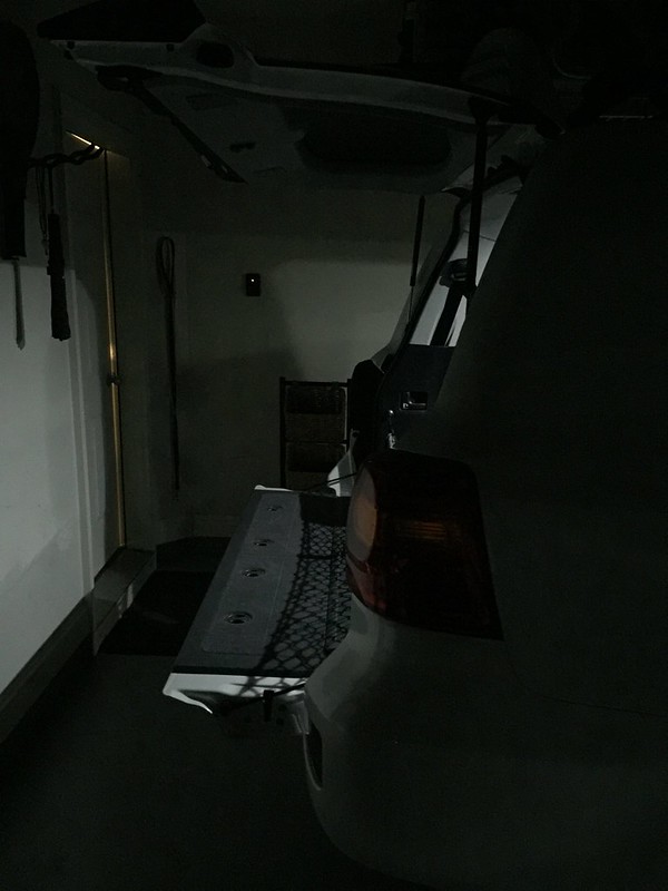

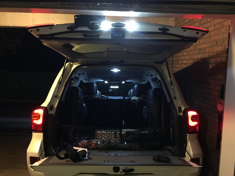

A little something I did on the rear hatch :)
Lord knows its needed on the LC (not sure why Toyota didn't think about this)
Yeah I know I need a prettier switch but that's what I had to work with at the time.

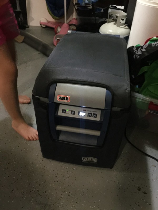

Ran it through the grummet on the hatch, down on driver side panel. Also I did run power through the driver side on the door still (straight from the batt - fused) to run my ARB Fridge. So I tapped into that same power line for this light.
Off: (with all LED's on inside)
On:

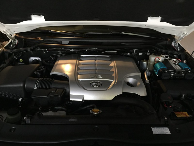

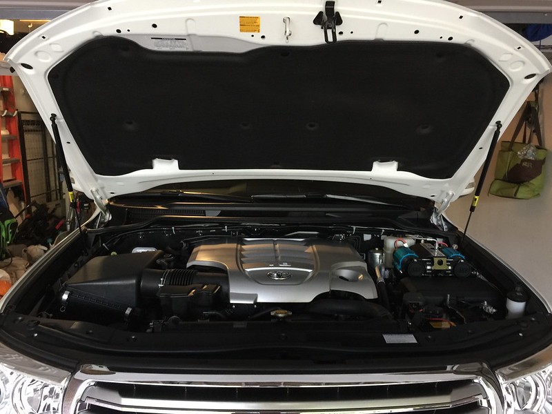

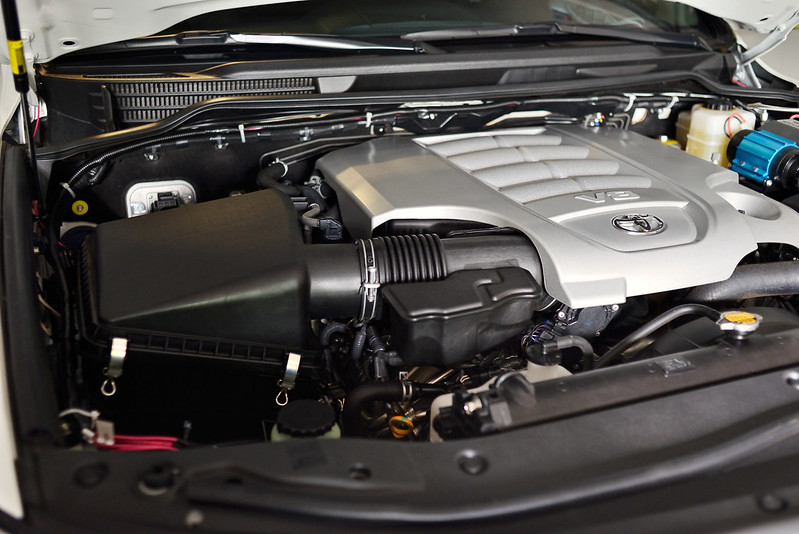

This castrol super clean stuff is AWESOME for engine bay cleaning (65% water 35% super clean mix on a spray bottle.... rinse with water before and after)
No wiping or anything, just rinse cold (or at least not super hot) engine bay, then spray this stuff all around and give it a few seconds (20 maybe) then rinse it off...... watch the grime and oil disappear.... might take a couple applications.
Leave only for a few seconds (under a minute).

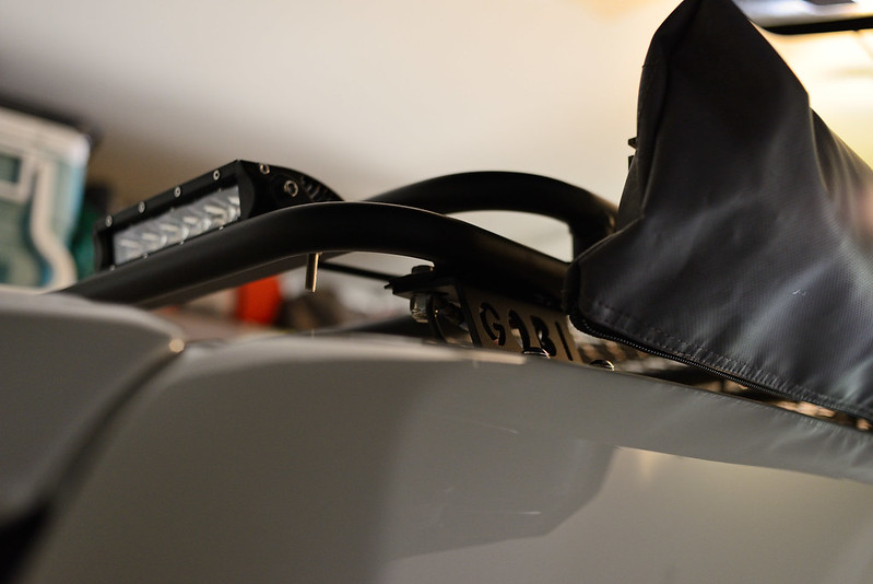

Looking good. So how tall is the LC now? It's still going in the garage with that Gobi?
Thanks @AFdude
My garage is 8ft tall ..... but the effective height considering the ledge and door overhang is 7ft tall...... and that leaves barely half inch between the rack and the garage door edge.
Can you post the exact name of the engine bay cleaner you used? I can't find Castrol Super Clean...
Looks great!!
Looks great!!
Here you go brother "Super Clean"
You can find it at Walmart or an Automotive store.
Remember:
No wiping or anything (unless yours is that bad), just rinse cold (or at least not super hot) engine bay, then spray this stuff all around and give it a few seconds (20 maybe) then rinse it off...... watch the grime and oil disappear.... might take a couple applications.
@TomasAllan Thanks for the tip on Super Clean, and perfect timing too. MAJOR wash and wax job is on the agenda for my 200 this weekend. Question on the Super Clean: it's safe on plastic (under the hood), I presume?
