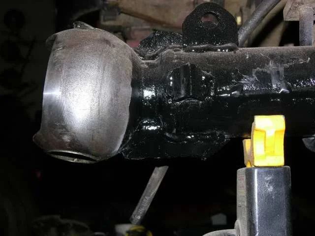

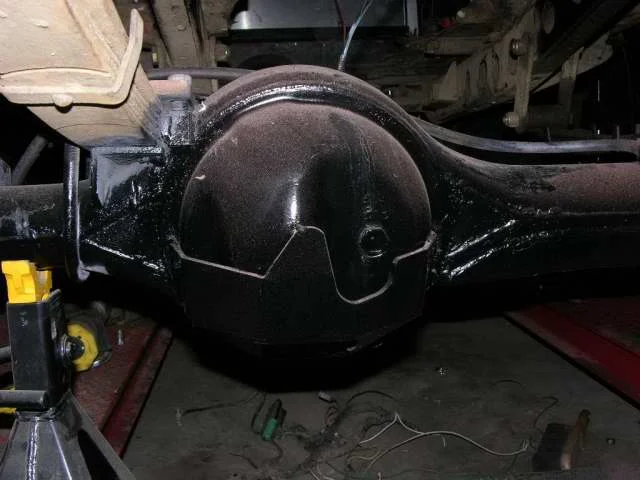

Front locker is installed and 3rd member is back in.
Allen head drain plug is in. Will build up some weld around it later.
Pounded some of the dents out of the front of the pumpkin,
need to look into some armor. you can see where the ring gear was rubbing
against the dent.
