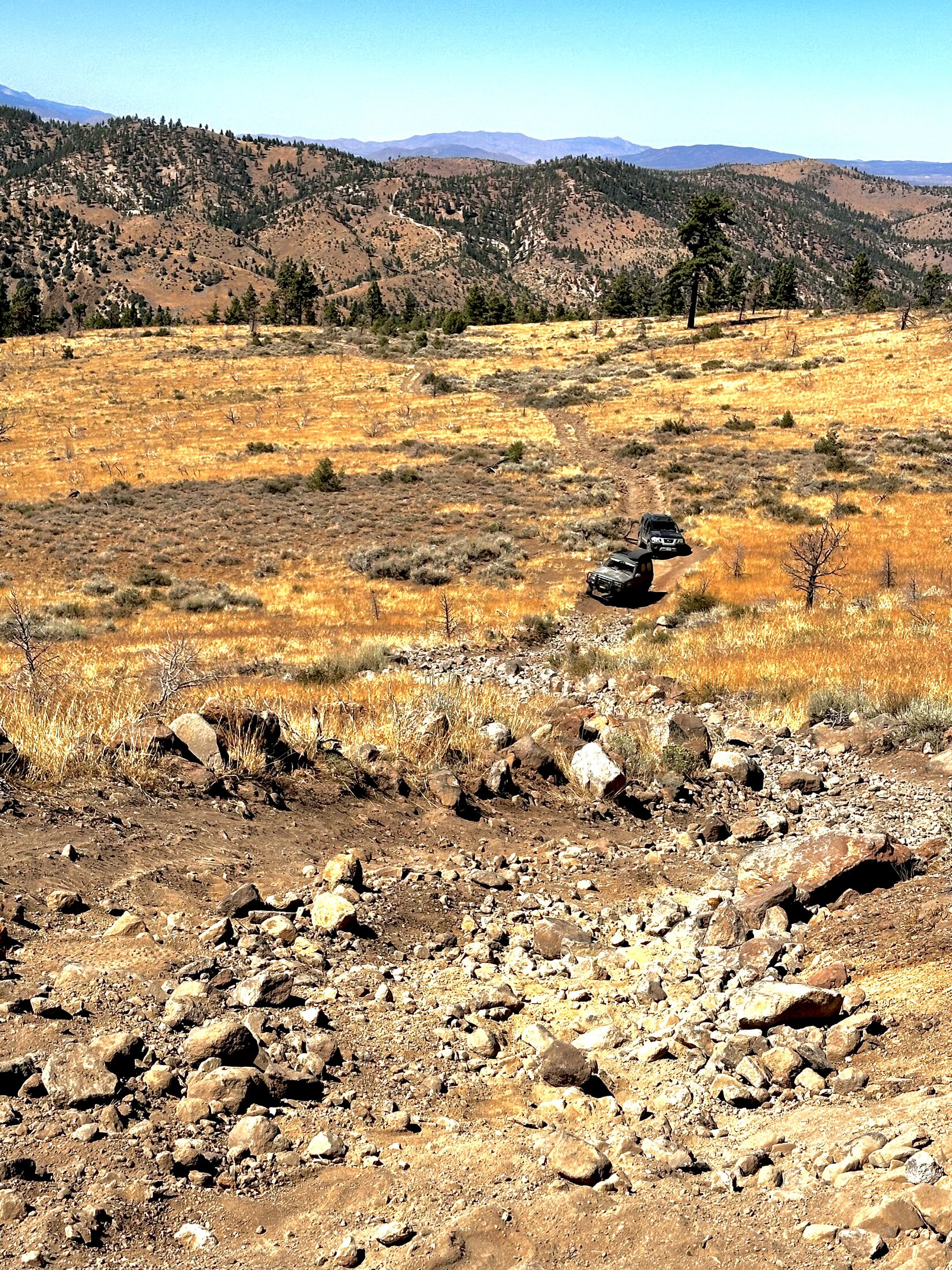

I have come to a conclusion on this debate that ive been having since I bought my 80. It is NOT to add lockers.
Here’s the deal, I think lockers would only get me into situations that I don’t want to be in, and or worse to get out of if something went wrong.
My 80 has done everything thing I’ve ever asked it to do, it usually does it better than the other trucks I travel with.
Over the weekend, a friend and I attempted the Barney Riley Road, an 18 mile trail between 395 and 89 in NorCal. We ended up doing 23 miles in 5.5 hours, and we bailed on the through run only to backtrack to the start after deciding NOT to try 4 alt routes out because they seem super sketchy or plain impassible.
Here the deal, with lockers I think I could have completed the route, but failure would have meant a roll over or reversing down a steep grade with loose boulders.
There’s no way my friend would have made it in his Xterra.
We also had the best day ever, fantastic scenery, great weather, no damage.
So yeah, nope.
Ya’ll know the drill. The camera never captures how steep something is.
