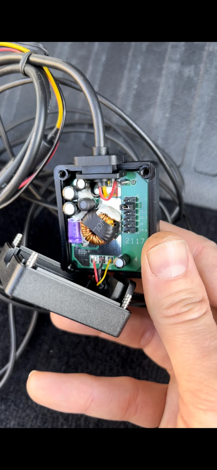

Installed the Garmin Mini 2 Dash cam last weekend. So far so good. Install was super easy. I sprung for their hardwire cable kit, which gives you a couple of nice features.
You can set a low battery shutoff voltage. Also, it connects to 12v constant as well as ignition on. Which helps to dictate the recording mode for parked vs driving.
The camera itself is super small and not visible from the driver’s seat behind the mirror. It was surprisingly easy to snake the wire up and tuck it in above the head liner. I did it on the passenger side and picked up the 12v and Ignition on from the little fuse block under the glove box.

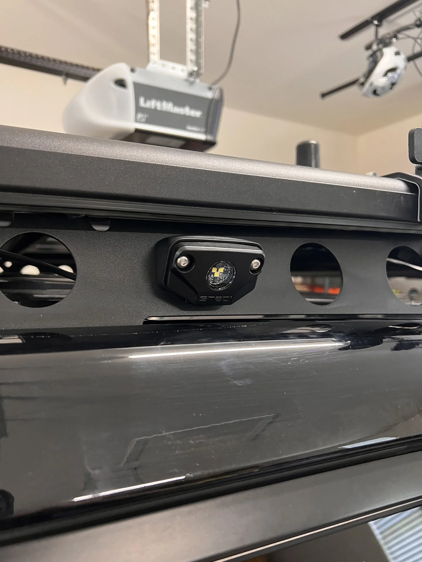

Added 4 of the Stedi 5700k rock lights in their nifty little rhino rack mounts (which could really be used in any rack with a hole).
Nice and bright.
Voltage selection jumper
Nice and bright.
Damn these are nice! I wish I'd seen these before I made my "alley" lights off my Rhino Rack.
