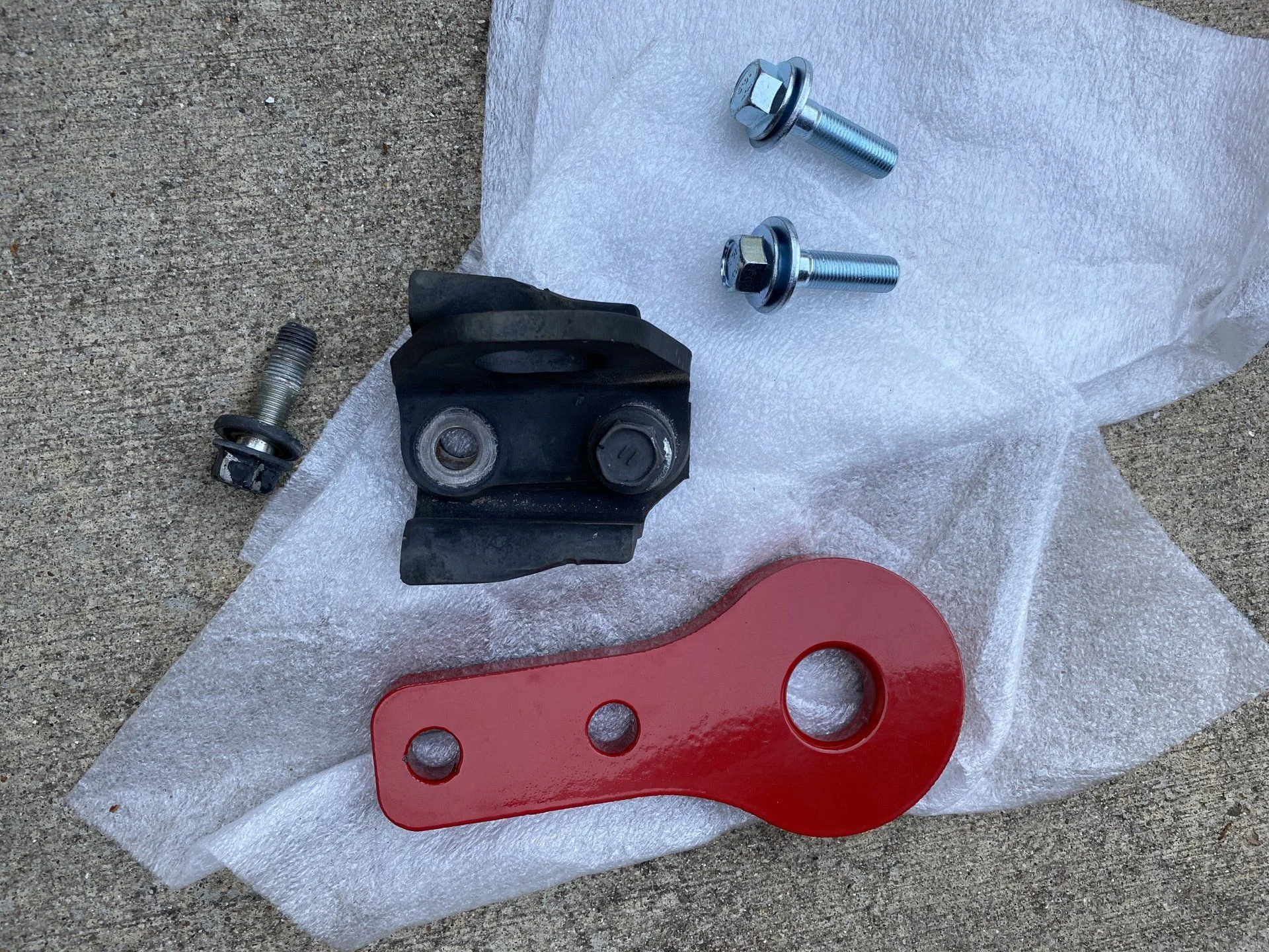

While waiting on tires started with the bolt ons: Trail Tailor Recovery Points

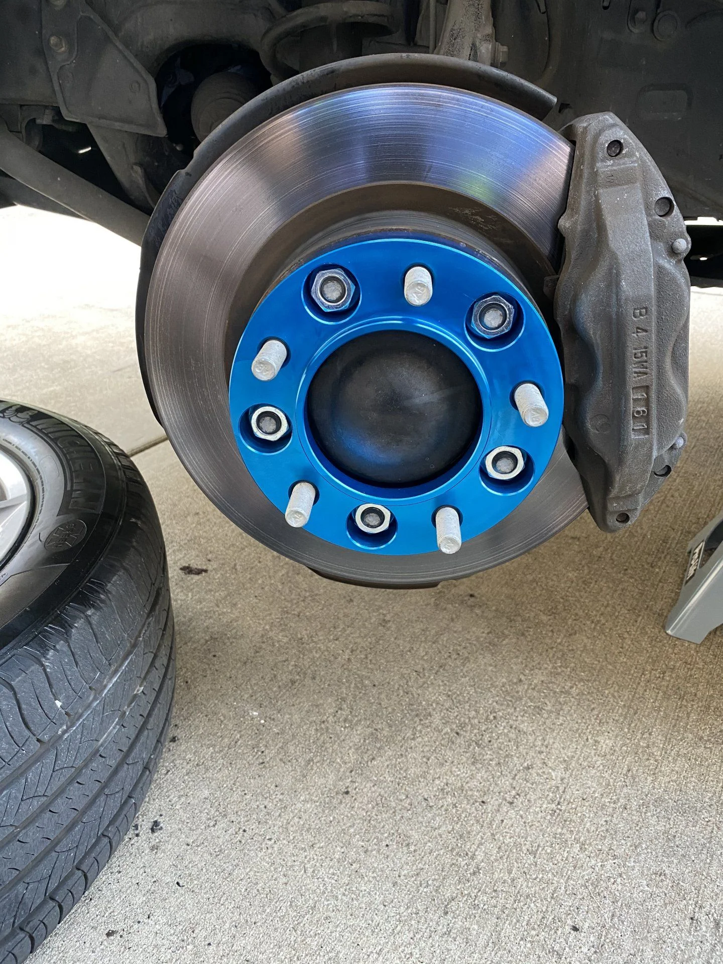

Spidertrax Spacers

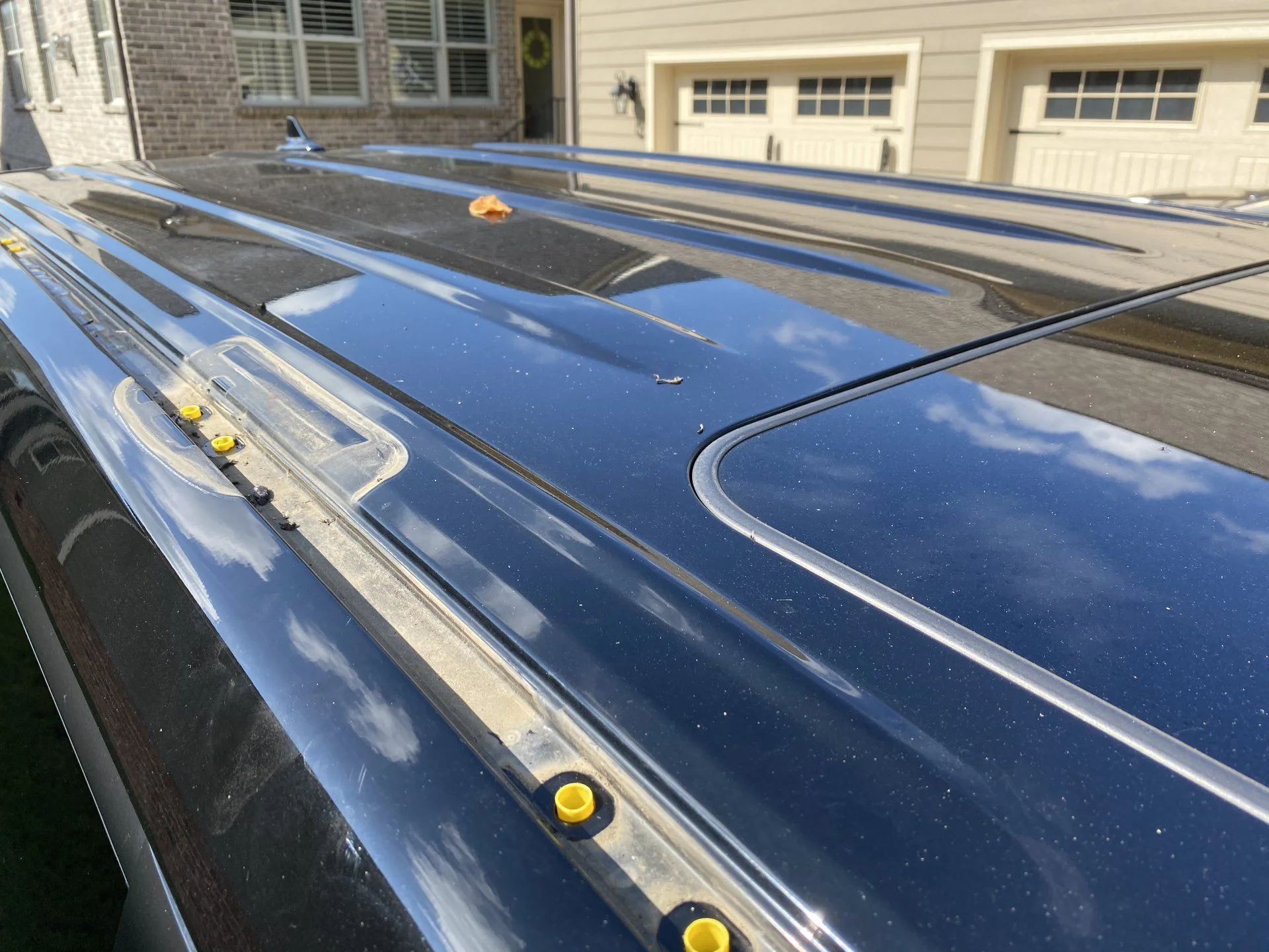

Removed the side chrome. 3m eraser wheel was clutch to get the gunk off, it was really on there.

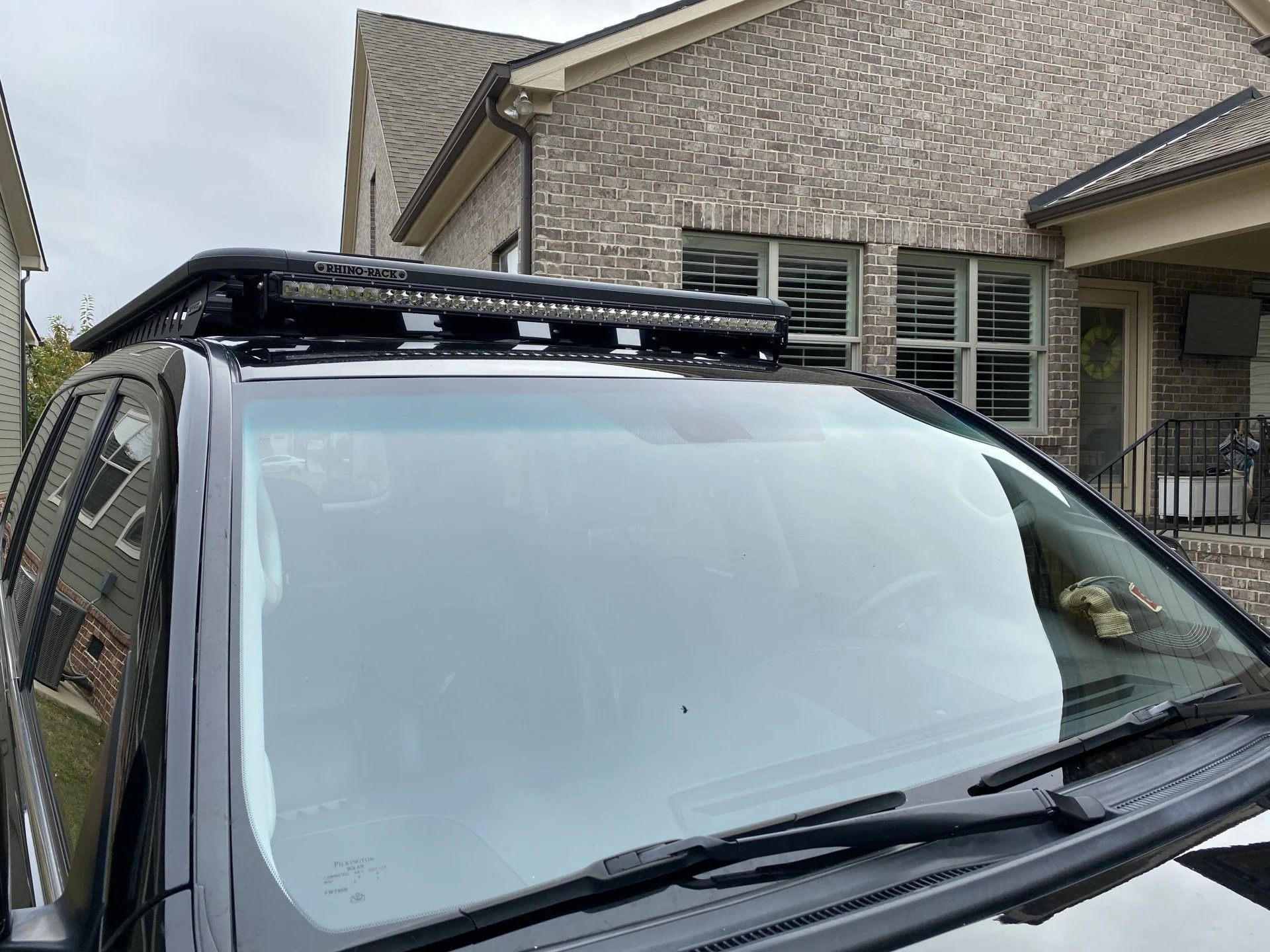

Rhino Rack

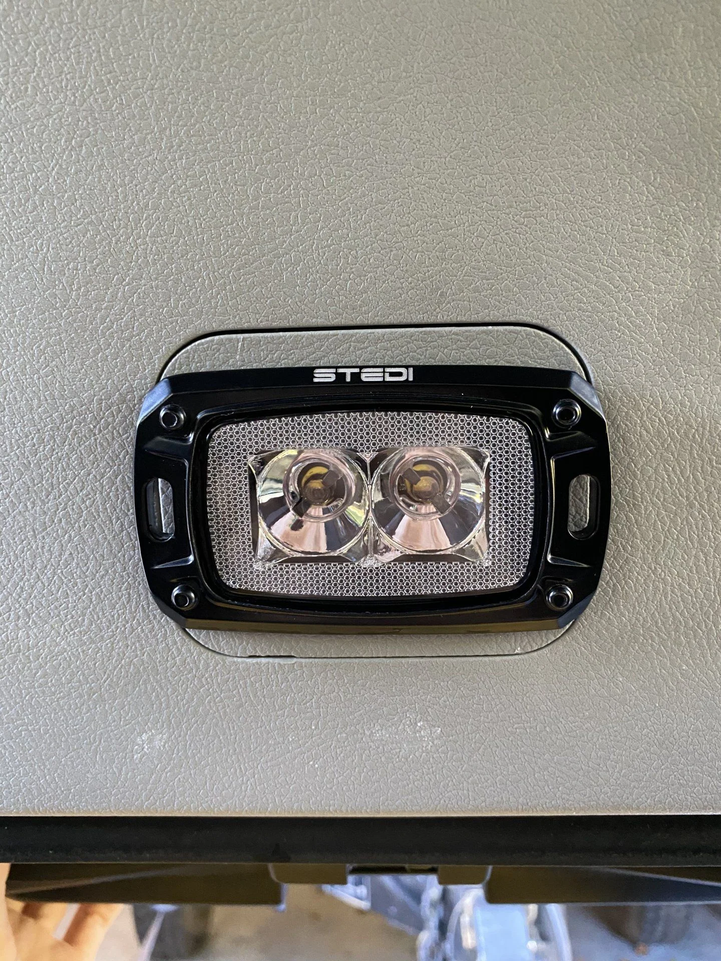

Stedi Hatch Light

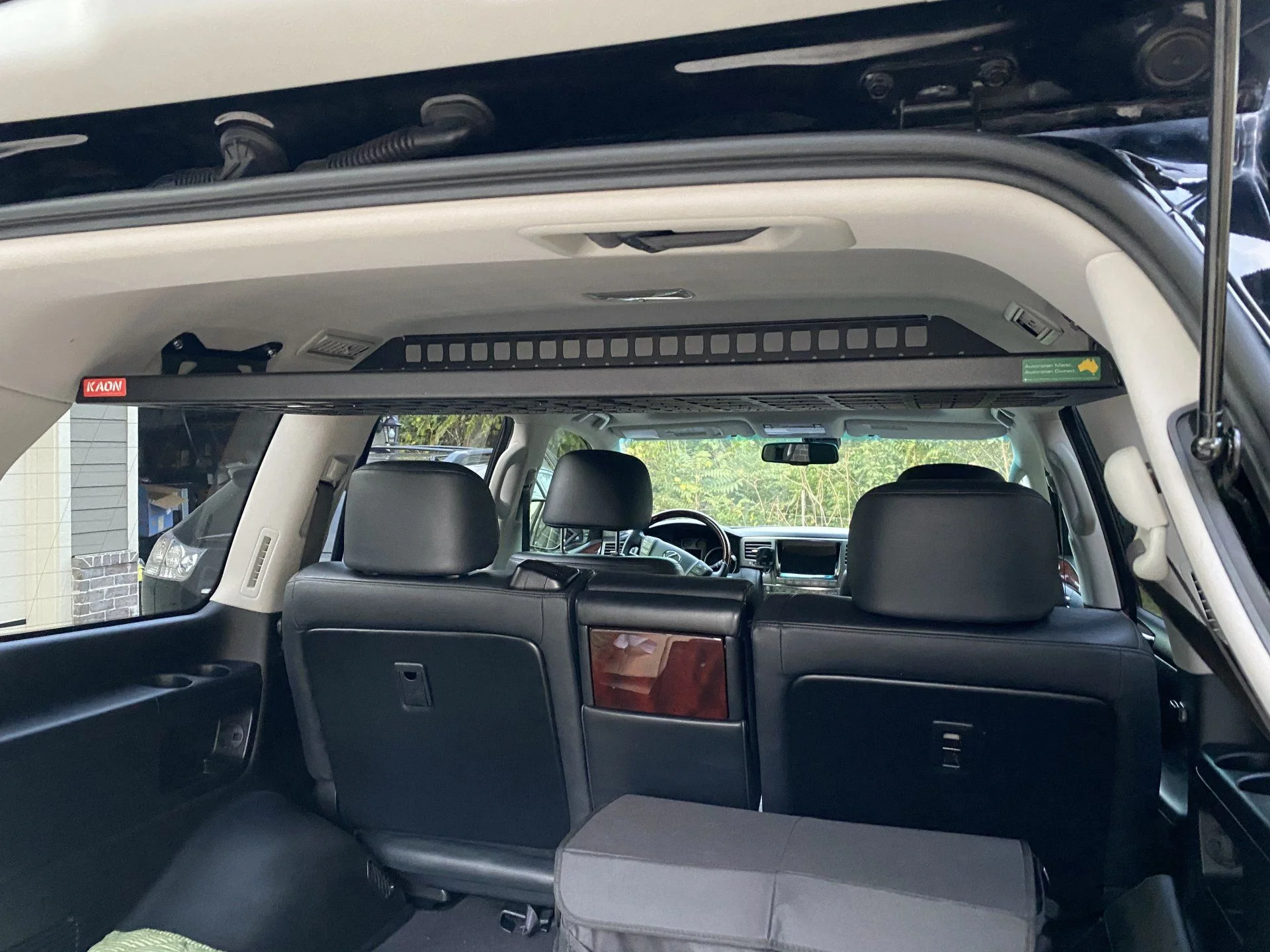

Kaon Rack

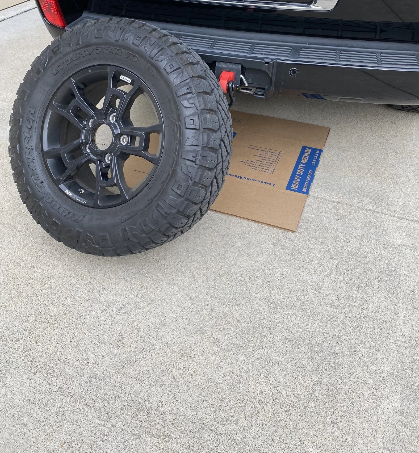

After looking for months, finally got a deal on a full size spare.

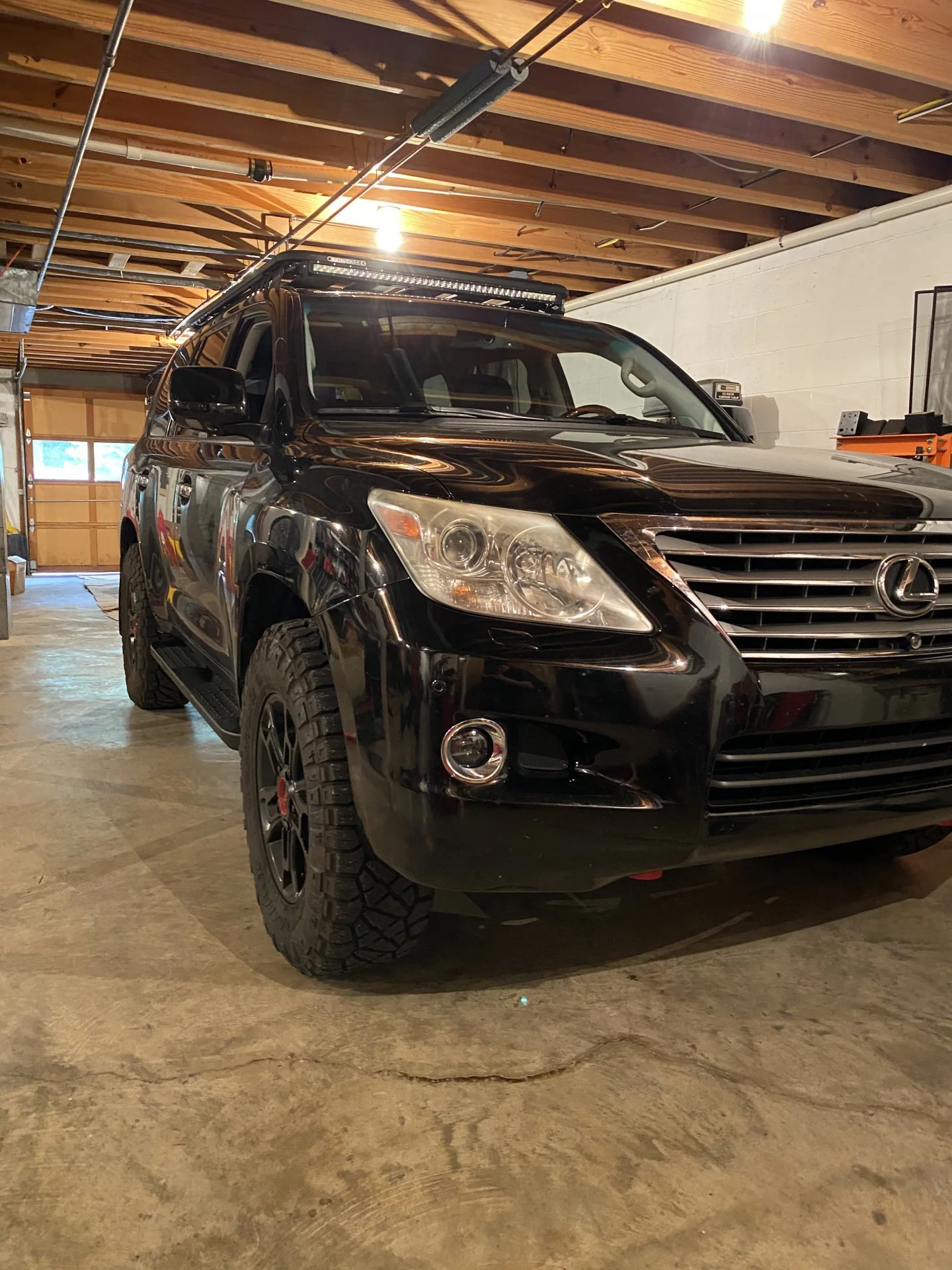

Hikari LED Headlights
Morimoto Fogs
AHC Lift and Trim
TRD BBS Pros w/ Ridge Grapplers
Rhino Rack

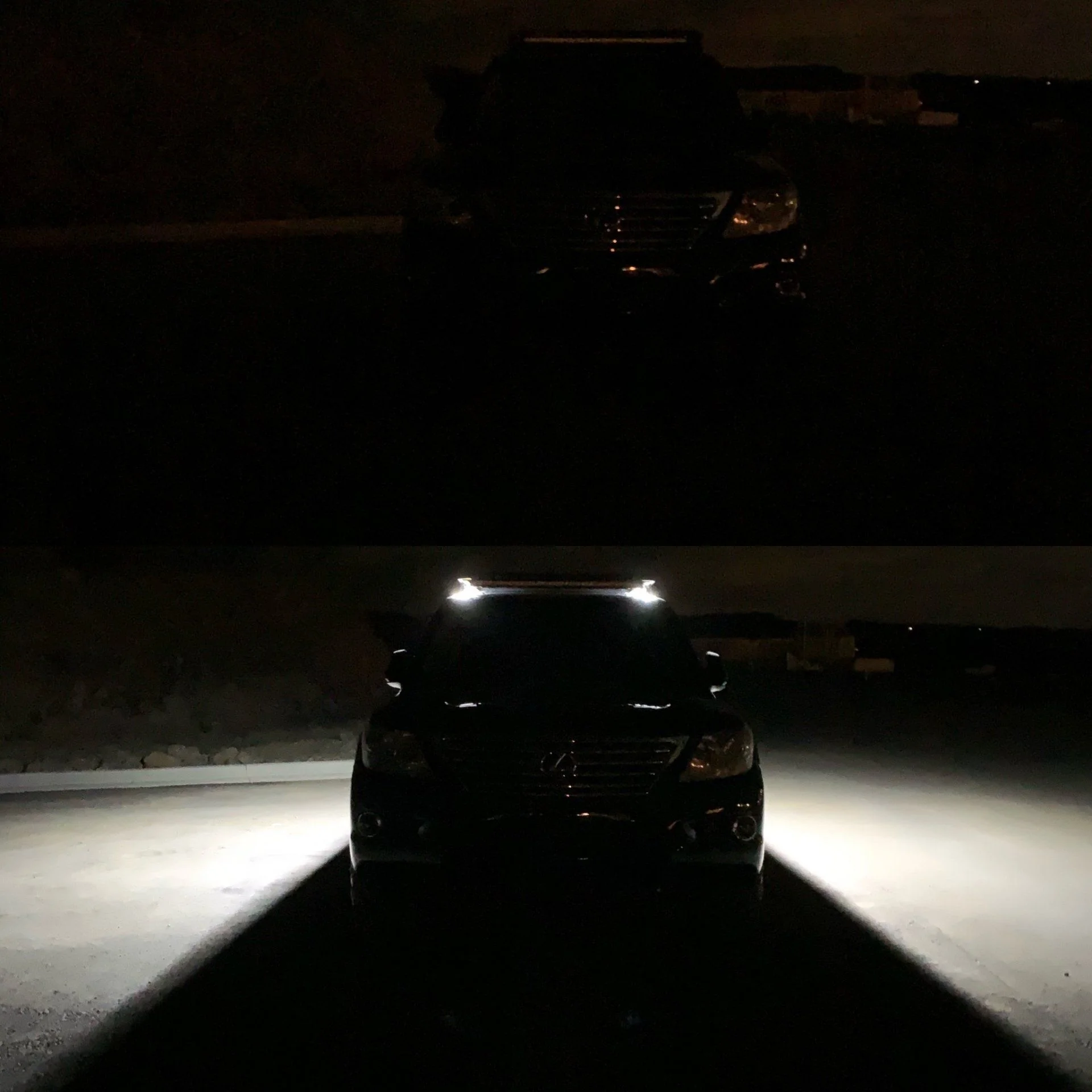

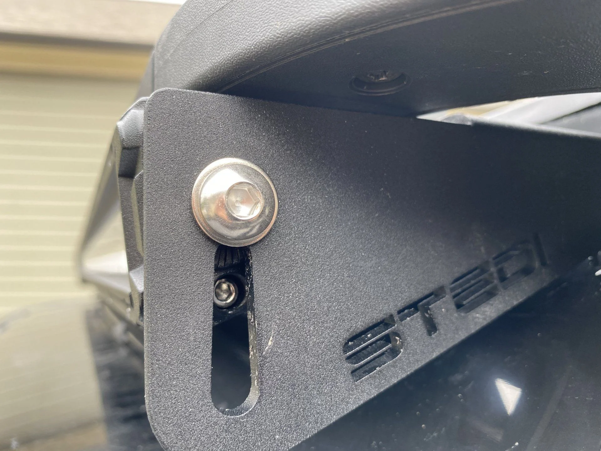

40" LED Bar
Side Strip Leds
Hatch Light

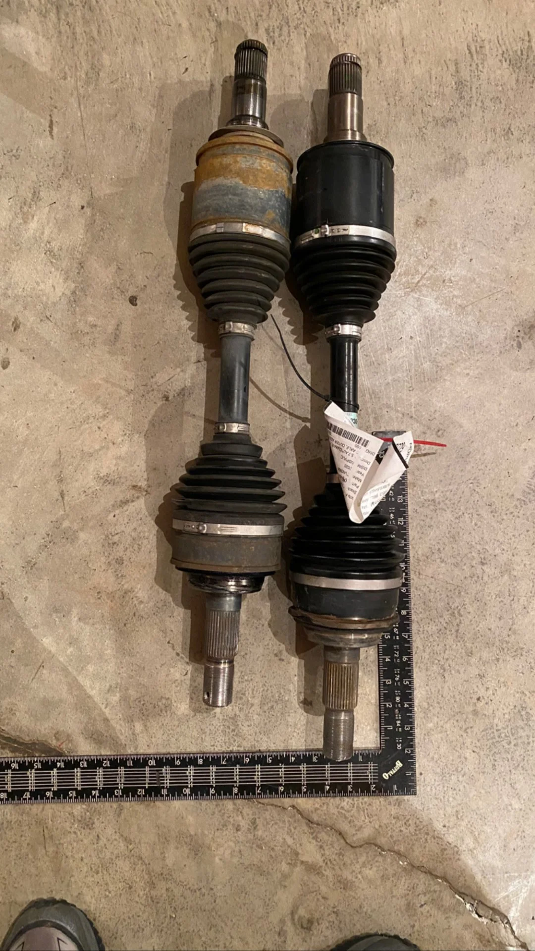

Coming Soon (I have all the parts but need a couple of long weekends)
4.3 Front/Rear Diffs

Jealous about that 5th BBS. I threw a trasharoo over the non-matching spare until I find one.
Did you wire that “glass” button to open the rear hatch?
Yeh. It’s wired to the outside handle, so it releases without the auto lift. My thought being if you are sleeping in the truck or it’s the middle of the night you can open the hatch without the buzzer and noise of auto lift.

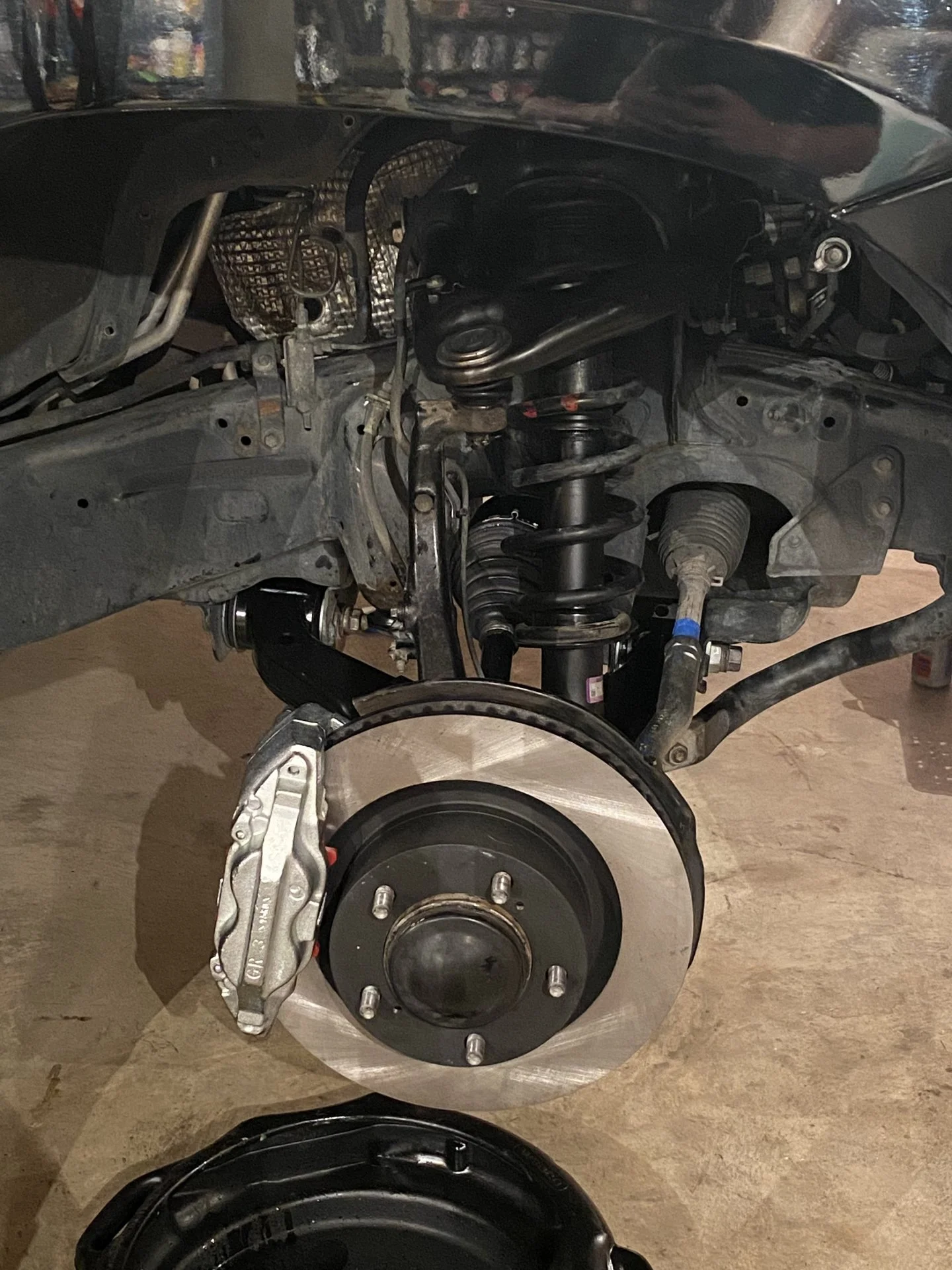

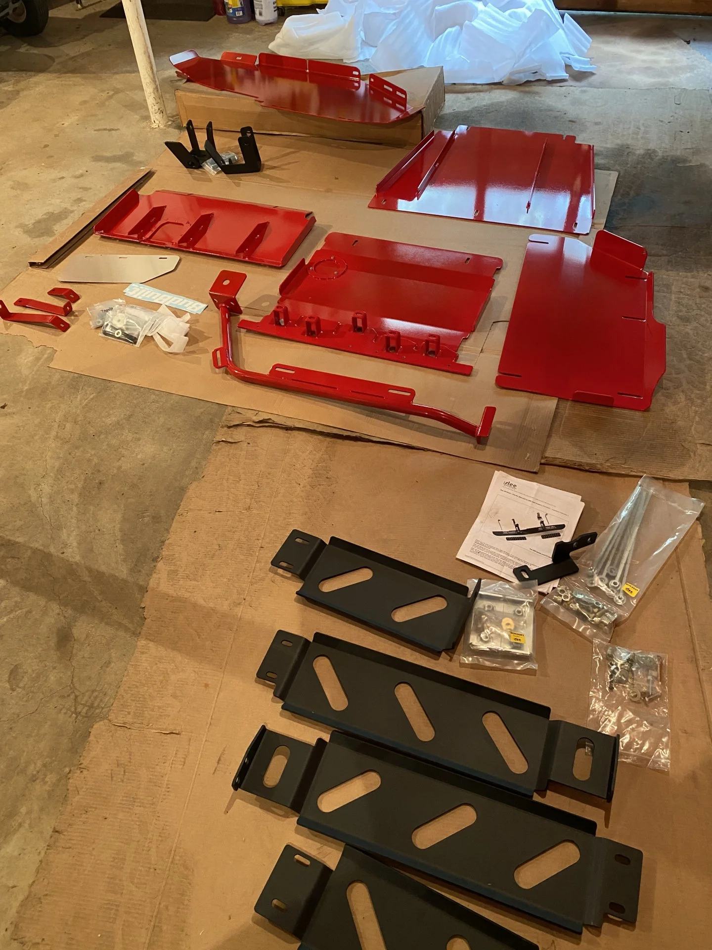

After months of gathering parts, finally got some work done over the past weekend. Sliders are on. Tundra front swap and brakes are done. Budbuilt skids are on and ready to get banged up!

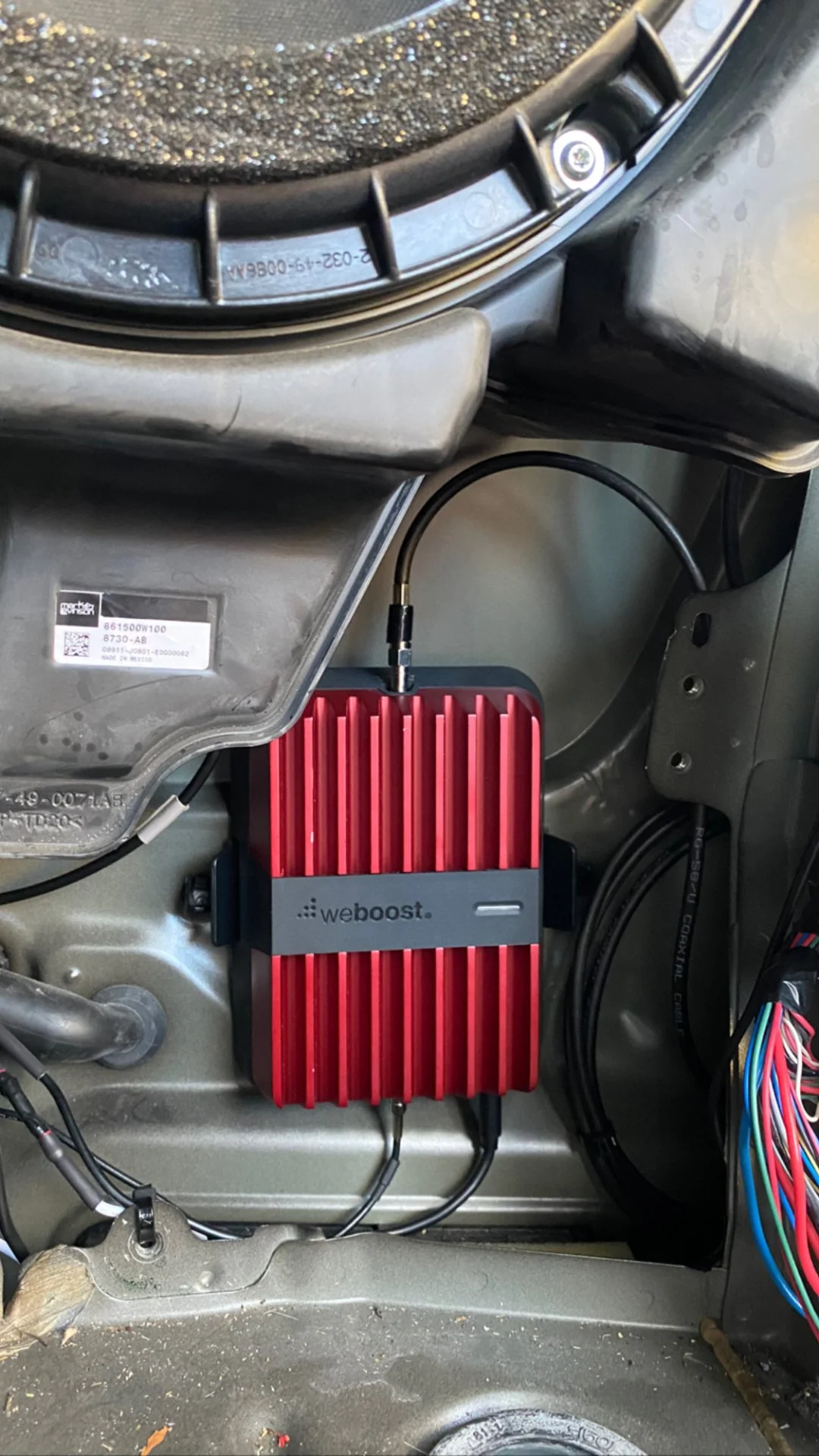

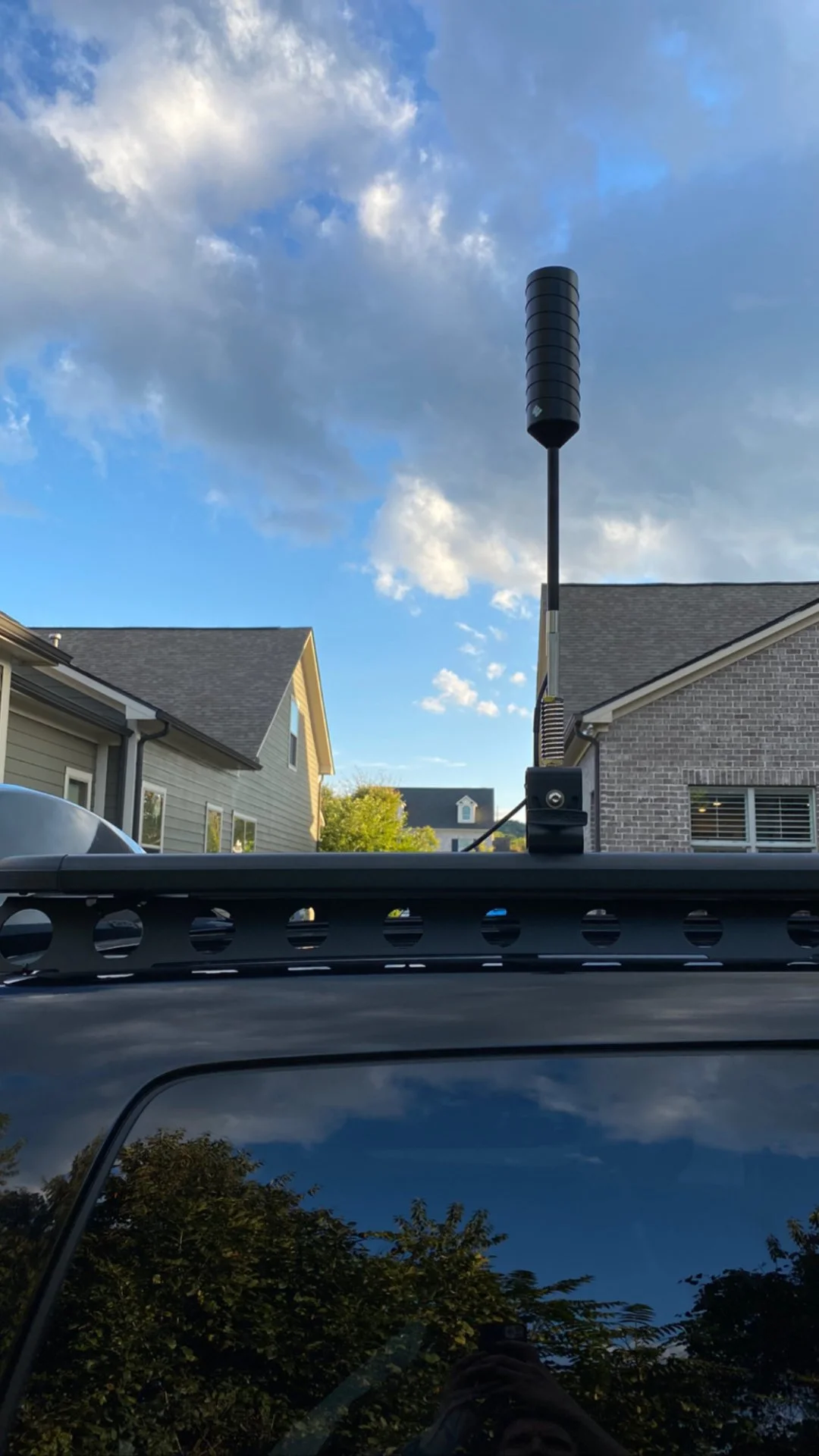

Knocked out a few little projects. Weboost, GMRS, and Voswitch

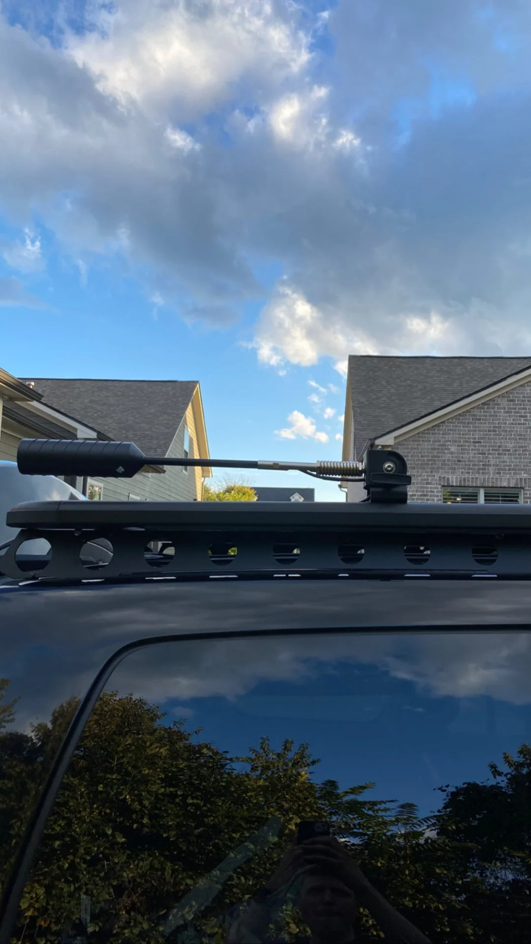

Weboost:
Mounted it in the factory bottle jack spot, and ran the antenna wire in at the rear through the hatch and down that side panel. Mounted the internal antenna with double sided tape above the passenger seat lower seat belt mechanism. External antenna is on the rhino pivot mount.
