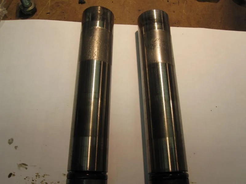

Both transfer cases have wear on the idler shaft. Not sure if these are trash or usable. The one shaft has wear on both bearing surfaces on opposite sides. The other shaft only has wear on one side. And hopefully you can see the ridge due to wear. Both idler gear assemblies passed the feeler gauge test and the thrust washers looked fine.
So the thrust washers may be out of spec after all. Check out the updated spec numbers in the later FSM on the left. I did some research and it looks like the idler shaft wear is quite common and that Toyota doesn't sell the idler shaft any longer... So does anyone have a good idler shaft they will donate to the cause? We are going to need new roller bearings also. Do we want to just rebuild this with all new bearings?
John,
I've got a used idler shaft that is in better than those and also have the idler bearings that came out of the t-case. I can get them out to you in the mail monday morning unless there is some place we can meet up on monday. Just started a new project 2 blocks from the zoo.
Tom
FYI the bearings that I have are the ones that were on the shaft. Not new ones. I noticed that Specter sells used shafts and bearings
