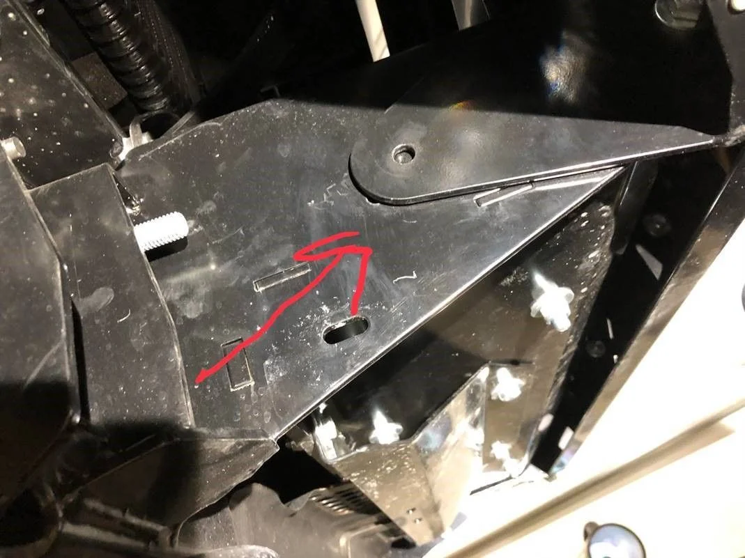

Here is the pin hole they missed. You have to fit the bumper into position which takes a lot of futzing and then drill the holes in the chassis mount where ever the buper (FPS) lines up.
Getting the shop the instructions ahead of time is a good idea. You should also read throught them and understand what they need to do so you get what you want. I've seem several T13 installs and the fitment is all slightly different. The gaps at the fenders all seem to vary. Min ened up a little wider than I'd like and they were not even. In a way it was good they had not drilled the pin holes and I was able to adjust the position and make it better. Yoy might wand a hold point to inspect before they do that part.
