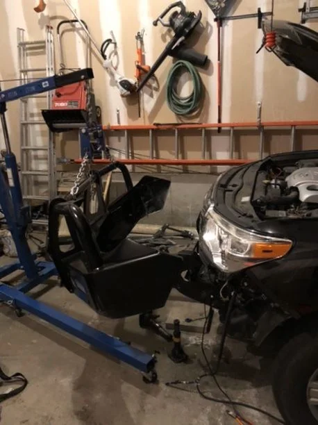

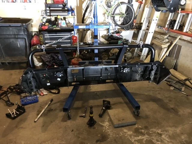

Yes he can! Though the same guy can’t post pictures that are not upside down... sorry about that.

Fun fact: I last used this engine hoist to pull the engine out of my FJ60 17 years ago.
Here ya go...

Even if they don't reimburse me, I'm not too hacked off. Stuff happens. I didn't realize how simple it really is to take the bumper part off. If I had, I would have done it a long time ago. The hardest part was pulling the wiring and head light washer tubing so that the bumper could be completely detached. I'm going to figure out a better way when I put it back so it will be easier if I ever add a winch.
I am doing it alone, and without an engine hoist. Just old fashioned humping it up into place.
Well, I did use a hydraulic jack once I humped it up to get that extra little bit of height.
