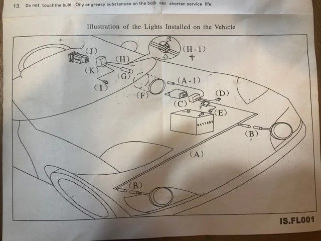

What I am assuming is that the OEM fog light switch switches the positive side and not the negative. That is what the TJM harness is wired for. If it is the other way (switching the negative side) the TJM harness will will require surgery. I've attached a pick of the TJM harness diagram. "G" is the switched positive to the relay coil that connects to A-1 in the engine compartment at the TJM relay.
If anyone can confirm that the OEM fog light switch is on the positive, that would be great and any tips on how to find and access it would be even better.

Update: Got the fog lights working. Christo at Slee helped me. Bottom line is that the OEM 7 amp fuse is not enough for the TJM lights. The easiest solution was to wire the positive power out from the OEM relay to the TJM relay on the coil side. This makes it so whenever the OEM circuits turn on the power to the OEM wire that went to the OEM lights, it energizes the TJM relay coil which in turn activated the power to the new TMJ lights.
