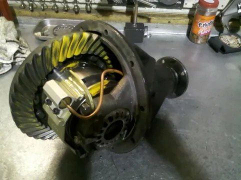

Ok, finally got the new TJM Pro Locker replacement from Mike at TJM. The installed was complete today after two months of waiting and tested the locker to see if it would lock up, well it did. Will be testing it out on the trail this weekend and will report back on how the locker does. In the first picture you can see what happend to the cross shaft that was distroyed by a failed actuator. The new actuator that Mike sent me has a prebent 90 degree copper air line which was much better. The new actuator mounting bracket was still off, so I had to grind off some so it will clear the gears and fit the center mounting bolt. The only problem I had this time was the new fittings for the air lines to the third member was a BSPP thread intead of NPT. So I had to order a 1/4 BSPP tap to retap the holes for the new thread. So far everything seems good and like I said I will report back on how the TJM Locker holds up on the trail this weekend.
Here is another picture of the actuator mounted on the bracket.
Forgive my ignorance but I don't understand why your locker copper line routing doesn't match up to the pic from JT?
JT locker
Nick's locker
:confused::hhmm:
All ARB locker copper line have the same routing so I wonder what's up with the TJM unit?
JT locker
Nick's locker
:confused::hhmm:
The picture you have is what I think is for the rear, mine is for the front. I had the same question when I recieved the TJM Locker. Why would they position the copper line on the actuator toward the ring gear? It would make more sense to have it face the other way so there would be more clearance with whatever size gear you put in. Tested the locker on a steep dirt trail today and the locker locked up with no issue.
