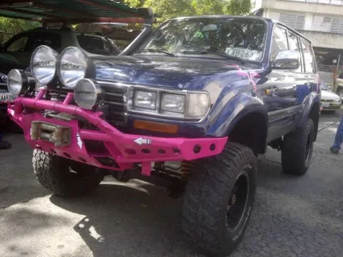

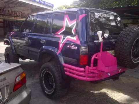

I don't see the lower valance on either of the 80's in the above pictures? Is it because of the angle the picture was taken at or were the lower valances removed for higher clearance?
just pics of a friends 80 with 7 inch ironman back in Venezuela
