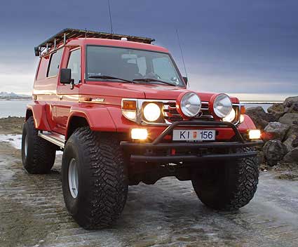

I am sure Tapage will say that most 4x4s that are usual work horses in the countryside will have smaller and skinner (but locally available) tires. People who have money to make 4 Wheeling a luxury sport have the $ for the big tires and other cool looking stuff. Tapage also said once that one of the best things for their types of mud wheeling was a complete set of chains. That tells me that most of the time even the sporting 4x4 guys down there are digging for traction rather than trying to float across the mud. If you really want to float across deep mud, then an Arctic Trucks type balloon tire set-up would be best. But they are not economical or practical for most working trucks in the South. With these 44s and air down to 7 psi, then you are floating. :cool:
That troopy would look nice minus the flares and balloons
That's where the differences come to the forefront, I think that troopy looks fantastic just the way it sits. Other than narrow trails, that beast would be unstoppable. 10' of snow... no problem, 3' of mud... no problem, 3-4' water crossing... no problem, rocks the size of VW Beetle... bring 'em on.
