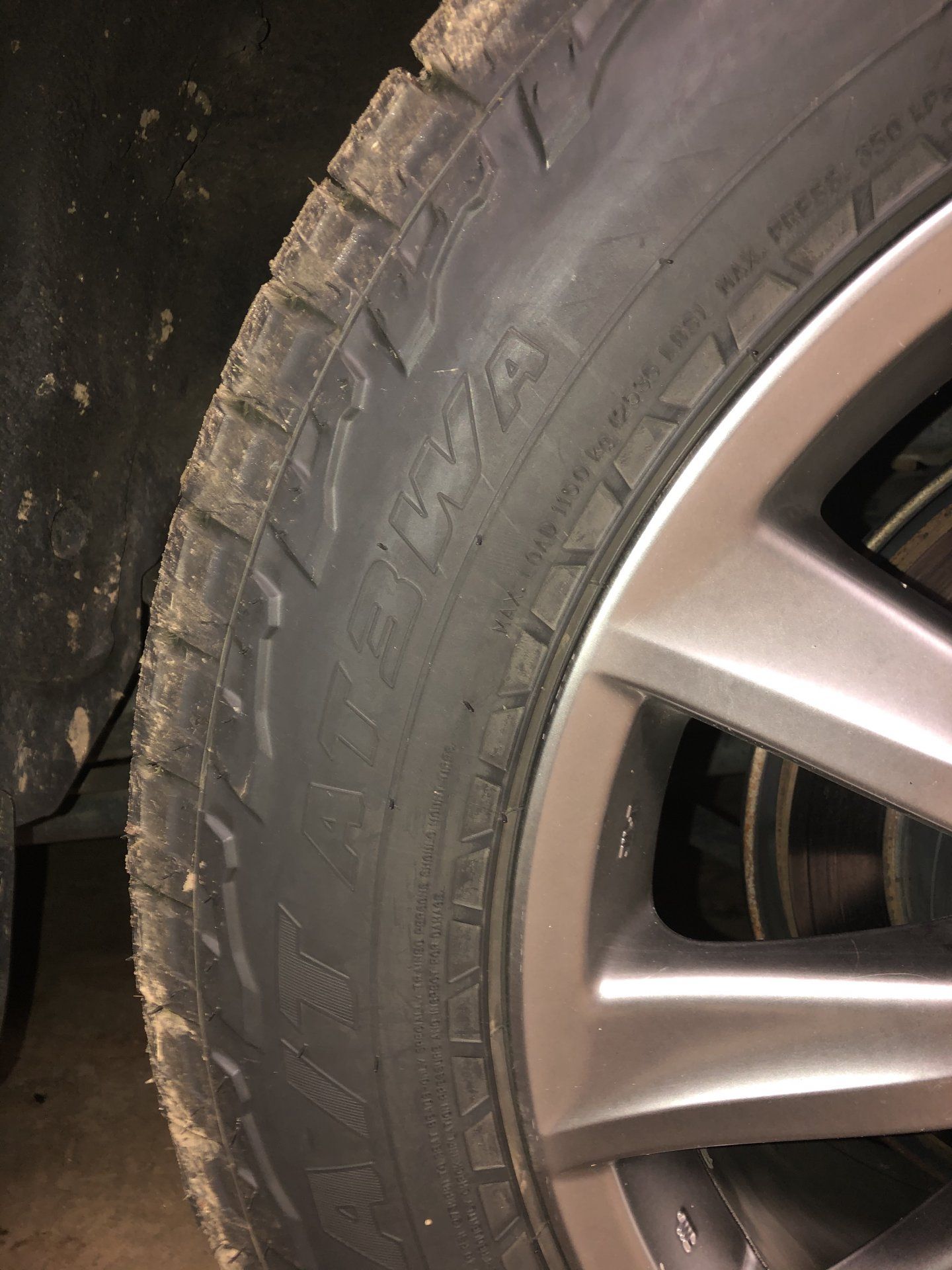

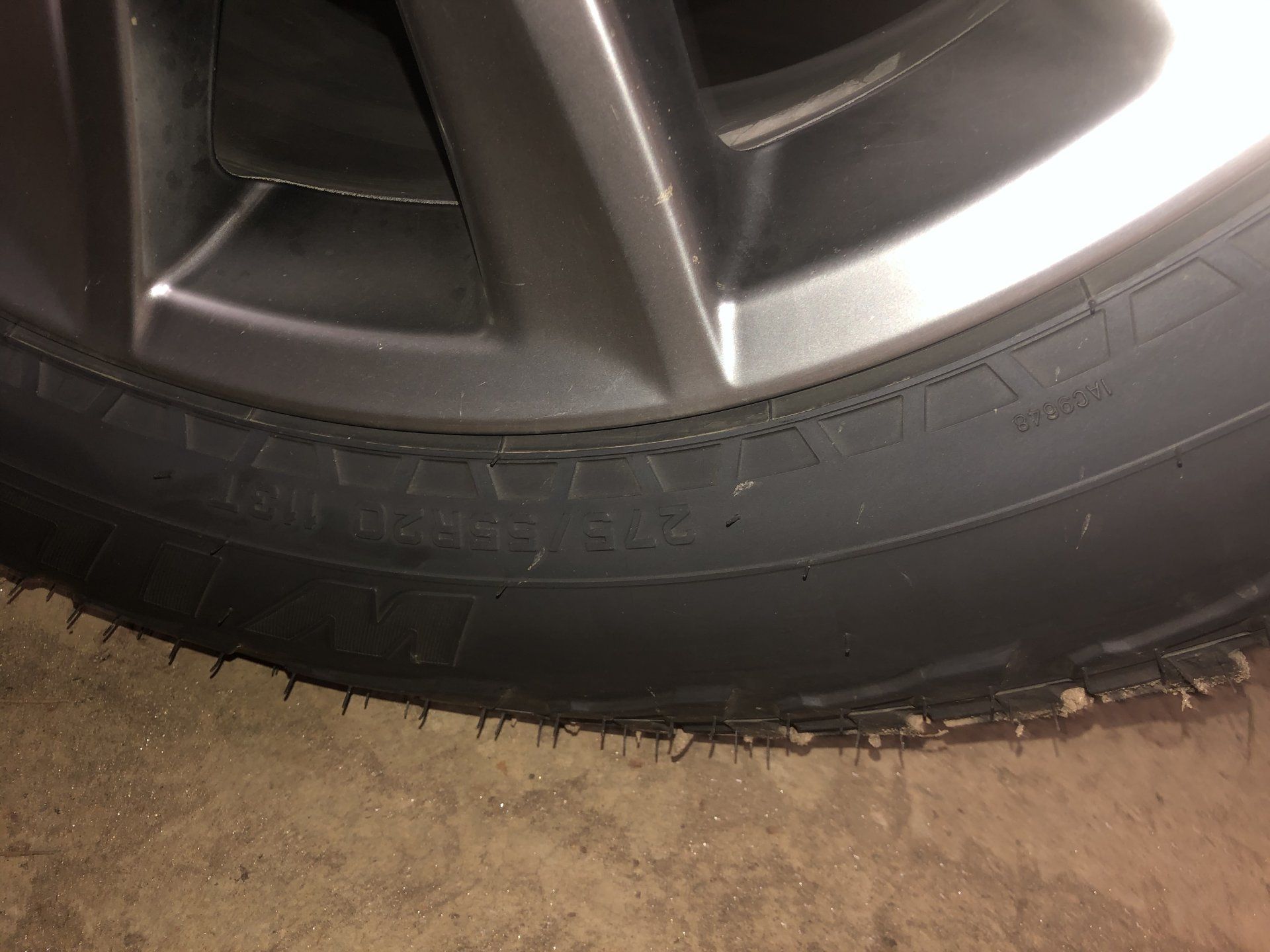

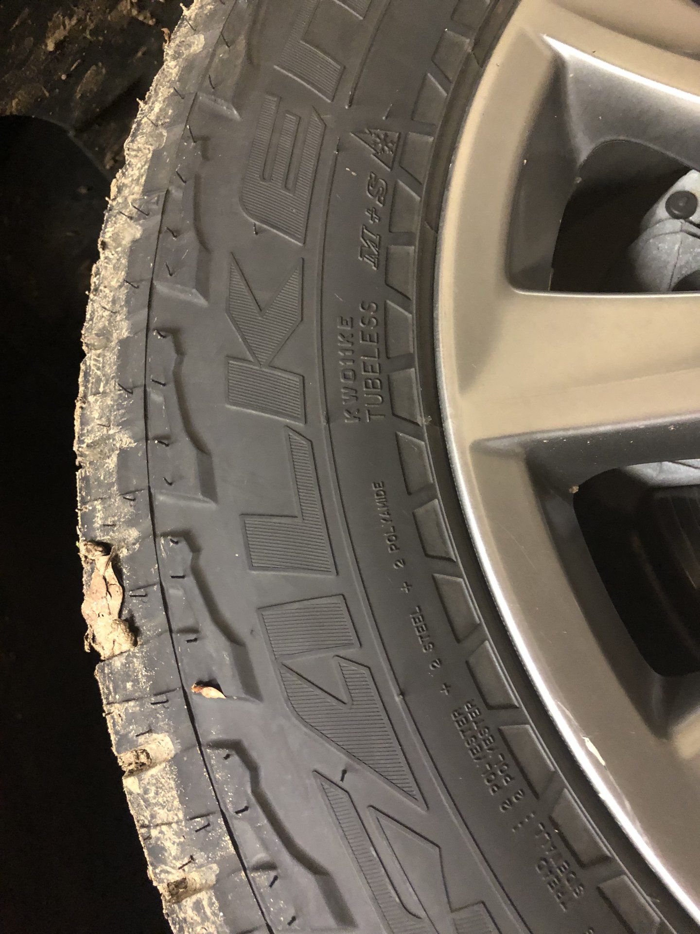

Falken wildpeak at3wa in 275/55 r20 113t on a 09lx570
Well... we are at am impasse. Falken does not make any 20" Wildpeak A/T3W with a 113 Load Index.
Could you post a link to your tire? Or take a pic of the sidewall which includes the size, Load Index and Speed Rating?
OK, I finally found the tire. Thanks for the pics, and for sticking with me.
The Recommended Cold Tire Inflation Pressure for the Falken Wildpeak A/T3WA 275/55R20 SL 113T tires on your LX570 is 33psi Front/Rear.
