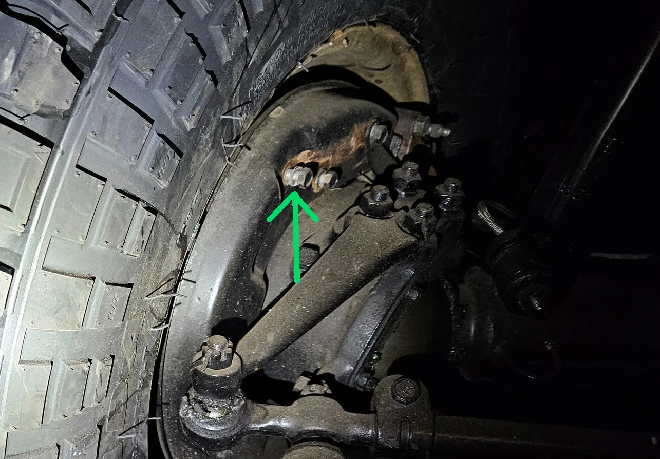

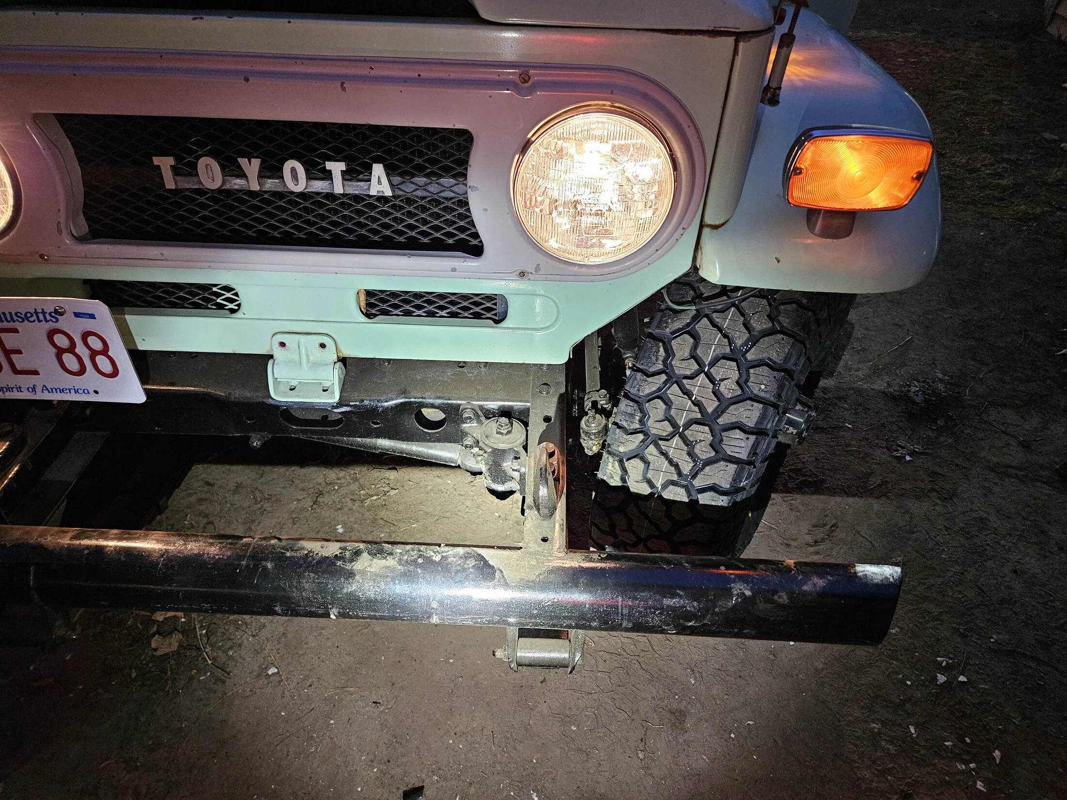

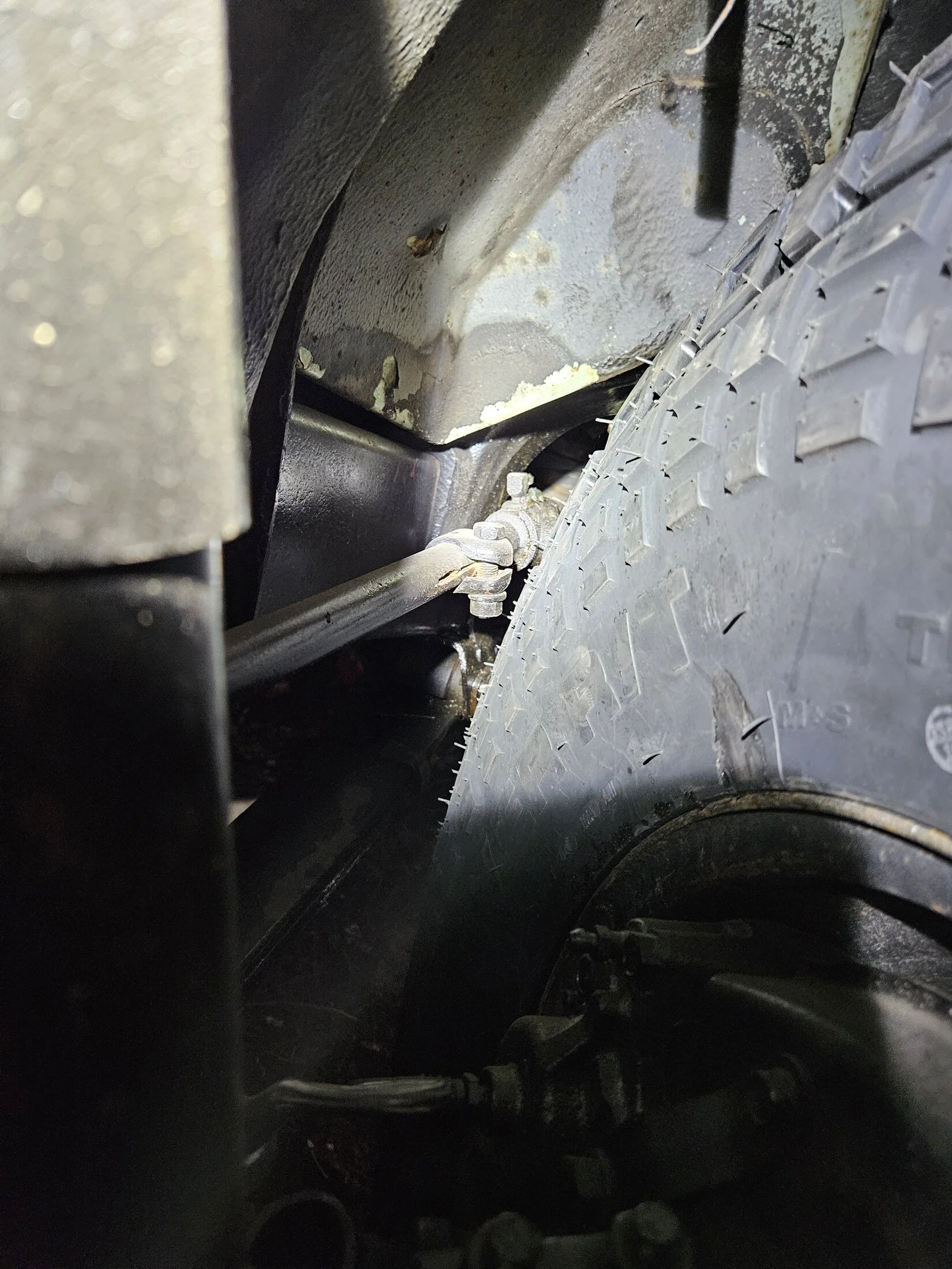

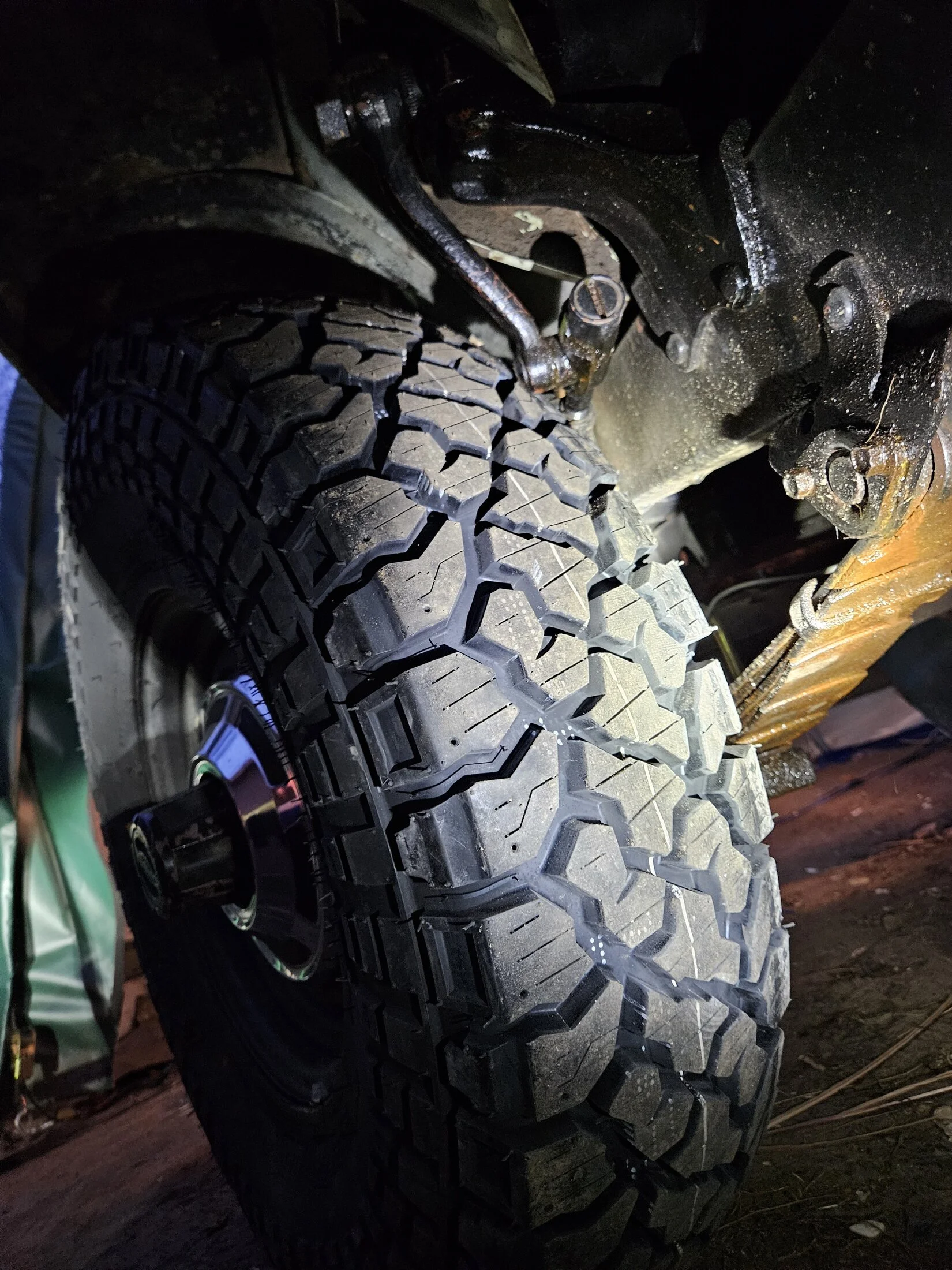

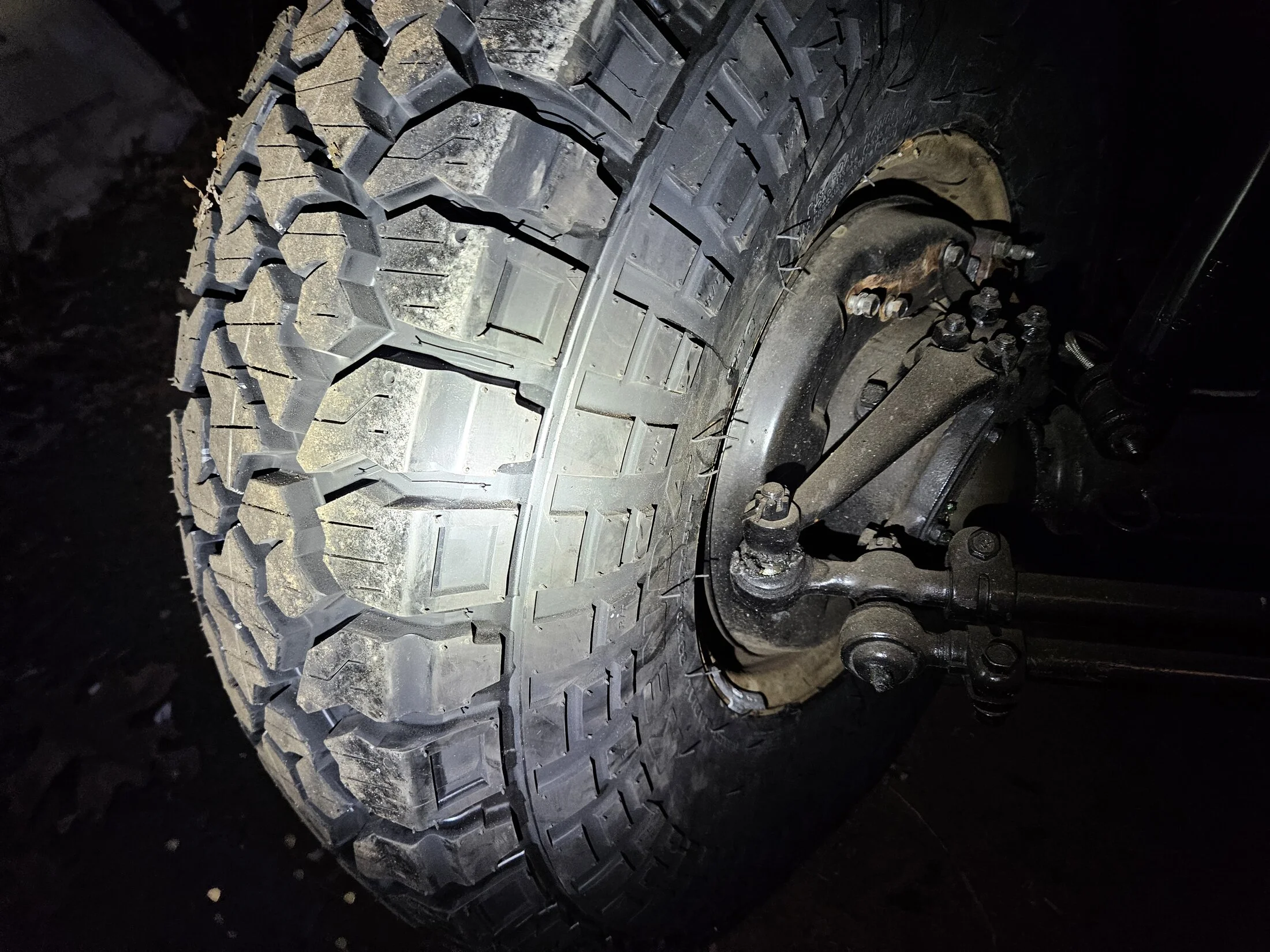

Just installed 33 9.5 15 on stock lift fj40 stock rims and tire is hitting steering components on drivers side. I will installing marks offroad lifting shackles in near future. Any idea what spacer or other options needed for front to clear. Thanks
Here
Adjusting the wheel stops on both sides, frt and back and rt to left, should fix the problem.
