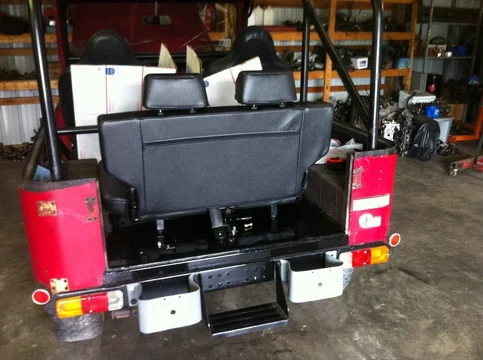

Honestly... I've never laid hands on a tire carrier of either type. I really don't have a preference, just want a spare in tow. It's just seems easier to locate a tube style carrier. Here are some measurements. Again- a 2/75 fj40.
Thanks to all
Take in mind that the carrier on the left is a right hand carrier, so if the mounting is the same then you should be able to drill new holes in the top hinge. Not sure of the placement of the latch yet, but looked close. Bolt holes are same distance left to right. It looks like you could cut the bottom off and it look pretty close to original.

. View attachment 962061View attachment 962062View attachment 962063
Your picture shows the bottom hinge near the bottom of the tub, so if the tub hasn't changed, then I would think it would work. Still a guess at this point, maybe someone has both years and they can show.
