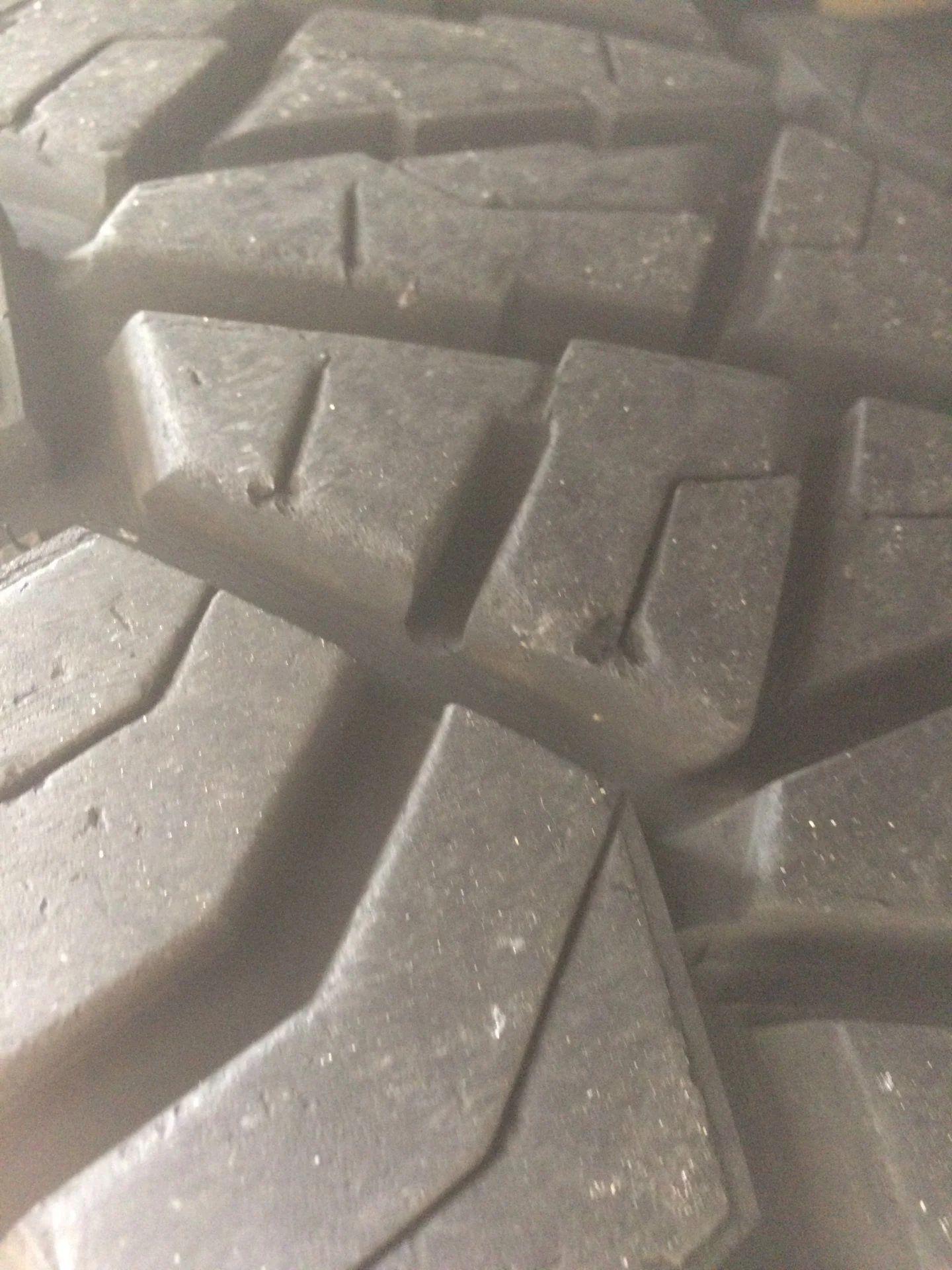

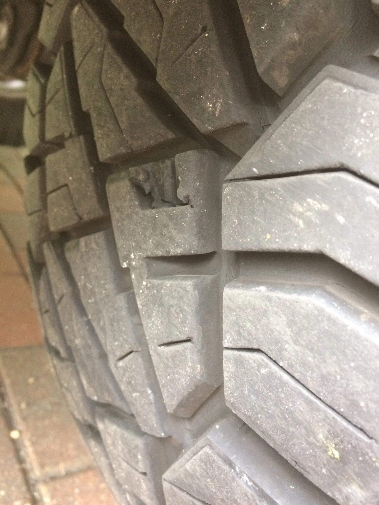

Can you take a picture of the wear you're seeing on the tires? Or can you describe the chunking/wear in more detail? Is it on the outer or inner shoulder?

Most of the chunking is minor but I definitely see one spot in the center of a tire which is large.

Thanks for the pics.
Weird chunking. Were these primarily caused by off-roading? Have these tires seen much trail use or primarily onroad?
I recall you got these tires not too long ago? The first pic missing the big chunk, if you look to the top right of the picture deep in the valley of the tread, looks to be some beginnings of dry rot looking cracks in them? Seems odd that such new tires would show anything like that?
I would take it to a tire shop to check out the balance and chunking. Loosing chunks of rubber is a sure fire way of creating balance issues. Could be a bad batch of tire/rubber as that's not unheard of.

Hmm......now that I’ve seen your tire pics, I’m even more thinking tire problem. Look at the date on the tires to check the age. That odd chunking and the cracks pointed out by @TeCKis300 could indicate old tires?
