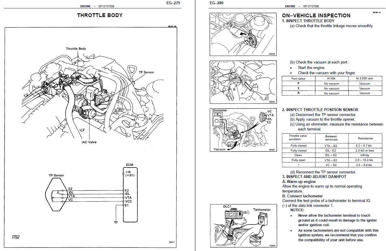

I need to go through the procedure to set the TPS in the right position, but I've moved it into different positions to just feel it out and it doesn't change RPM's or timing. Also if you have any tips on how to set the TPS without having to apply vacuum, that procedure seems out of my league and so if there's a way to do it with just a multimeter, I'm all ears. Sorry, I know that's a lot of info but I would appreciate any help on this because I'm stumped!

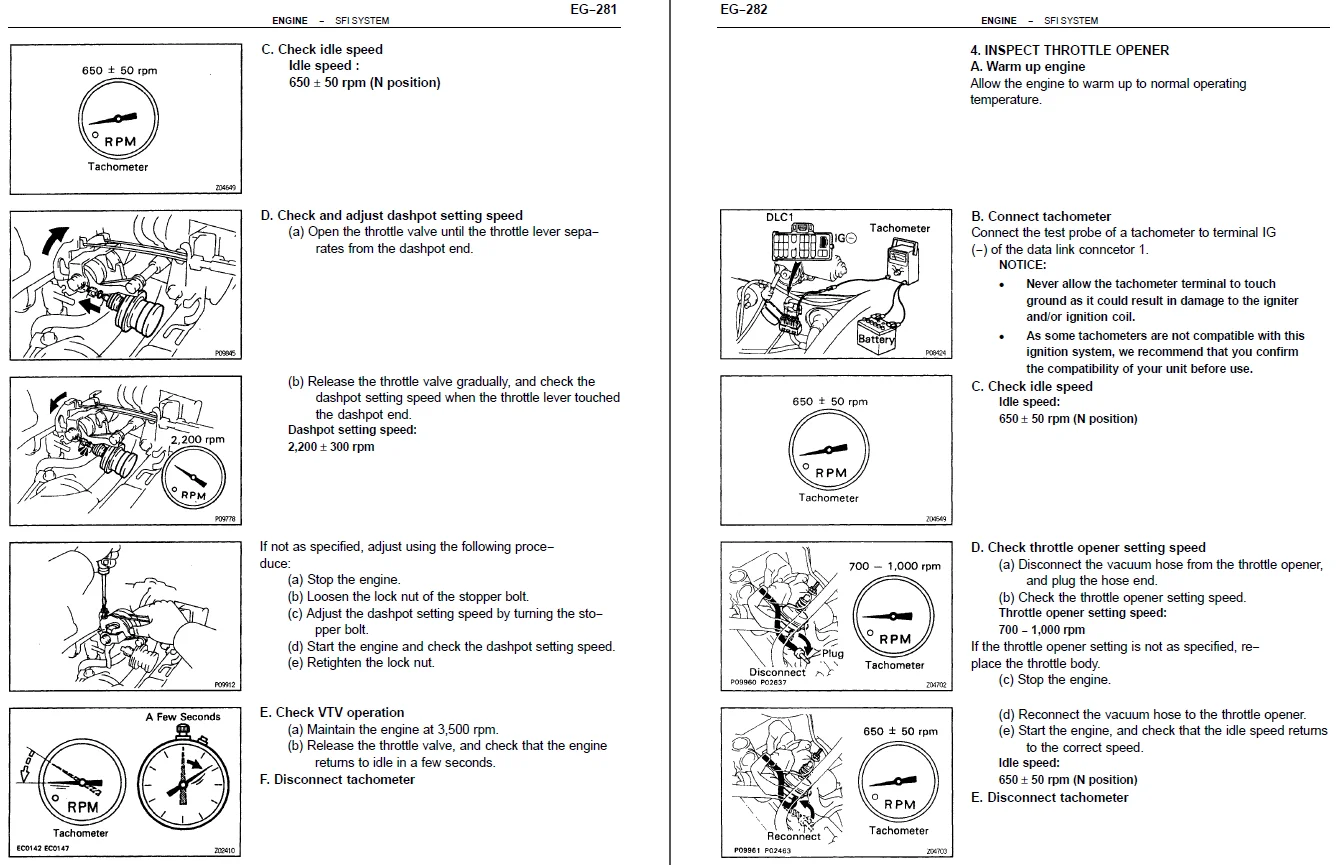

Lastly, for the TPS:
If the TPS is OK, you have to check the ECM terminals of the TPS, this is on page EG-238 through EG-239.
