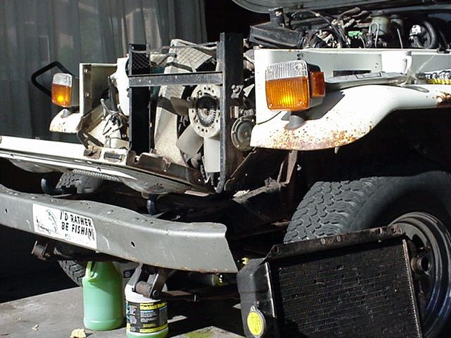

Last year I replaced my gasket, and the biggest problem that I had was removing the large nut on the pulley in front of the cover. Don't know how your set for tools but your going to need a deep socket and I believe it was 46mm. Ended up using a long pipe over the rachet handle for leverage. After a few busted knuckles, it finally came loose. As stated in the previous post removing the radiator is a good idea for better access, I also took off the radiator fan. Look in the search section for more tips. Good luck.

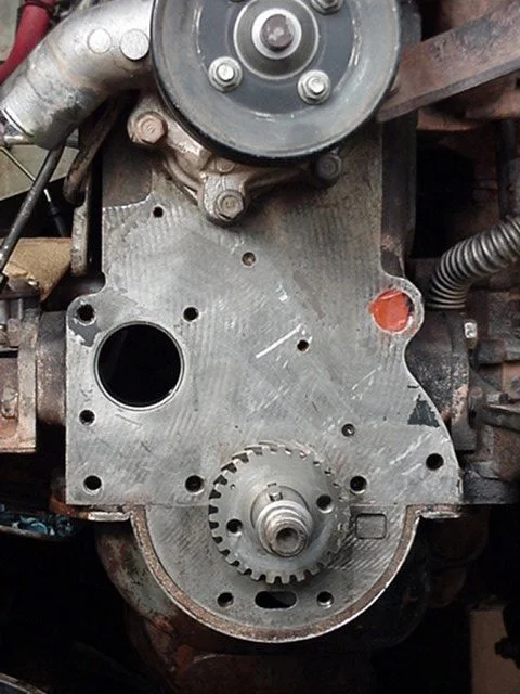

One thing I have not seen mentioned yet is that you may be leaking because your oil squirter is bottomed out on the block, effectively "lifting" the cam plate from the block and making it impossible to seal.
I had this situation on my freshly rebuilt 2F (in a '78).
I had to pull the camshaft to get that plate out.
In order to get the camshaft out, I had to pull:
-radiator
-fan
-crank pulley (read up on using starter to break loose)
-valvetrain
-side cover (to pull lifters)
-fuel pump?
-lots of misc items.
For a simple oil leak, it was a PITA...
If you go after it, make sure your squirter isn't the source of your leak!
