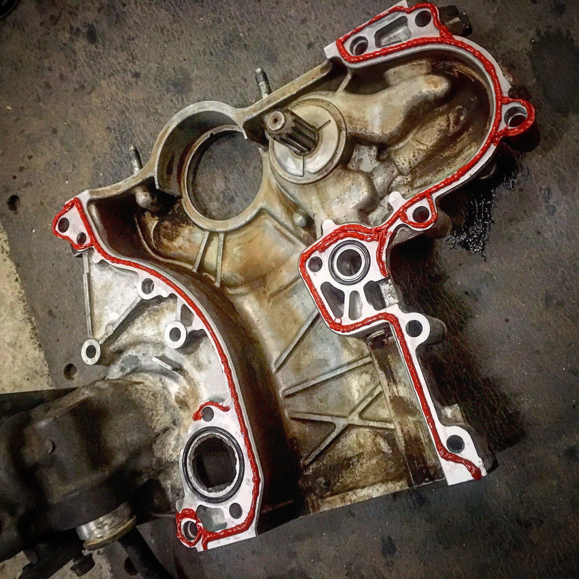

RE: 1. Are you sure? It looks like the only thing in the way up top is the 2 bolts that you should be able to access with the valve cover off. The FSM says (casually I might add) that you should remove the head to proceed to the next step but I can't see why it should be possible to do it without. You will need to move some hoses and all the same belts and drives not to mention the upper pan but, to me at least, it doesn't look like you should have to pull the head.
image-jpeg.1412164
Aside from the two tops bolts, Im not seeing here it would hang up and prevent me from getting it at it without taking the head off.

It IS possible to remove the timing cover with the cylinder head in place. I have done it. The job requires that the engine be raised up a couple inches above the front mounts and both oil pans need to come off. The job took me 27 hours. If had known then what I know now about head gaskets I would have pulled the head.
Im in a spot where I wont be doing the work myself and I really don't want to pay for a HG job it doesn't need (done 50k ago). Do you think it would be worth it for a competent shop to do just the timing cover job?
What is +/- 27 hours times the shop's door rate? Let's say it is 80 bucks an hour. That makes it around 2,100 bucks in labor.
You still need to remove the valve cover to get to at least one of the timing cover bolts. Also it is not a sure thing that the cover will separate from the front section of the head gasket without tearing it. I got lucky there.
On the other hand rear pan arch leaks are common and a pain. Pulling the pans fixes that as a byproduct. My arch is perfectly dry and has been for over a decade since the job.
But the front cover still needs to come off, so 27 hours plus how ever many for the head? or is it THAT much easier to do it with the head job?
The pans do not need to come off if the head is not in the way. One end or the other has to come off.
You need to decide if you want to go in from above or below. As far as the FSM is concerned both ends need to come off to do the timing cover.
You can fake it in a similar manner as you would by pulling only the pans.
