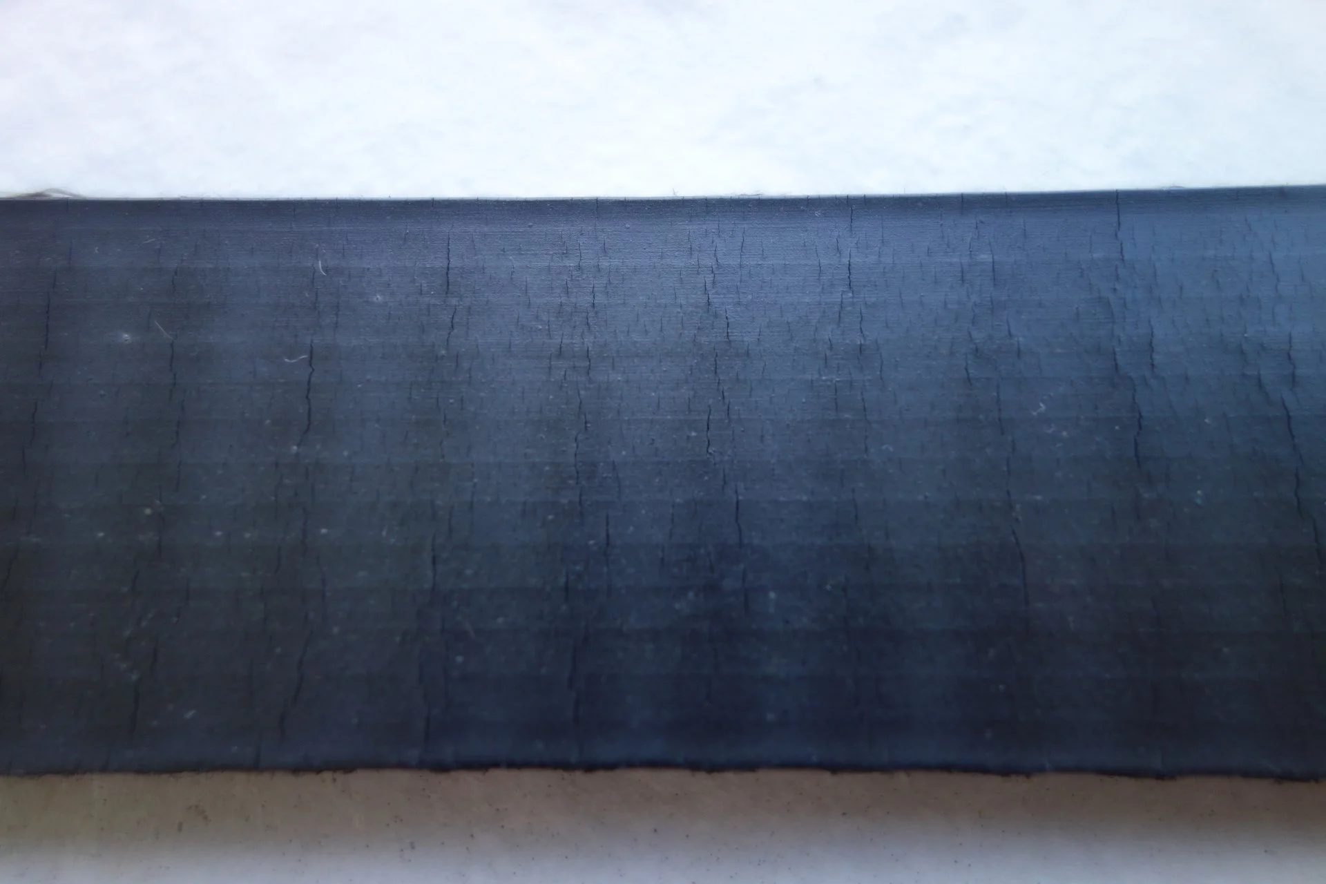

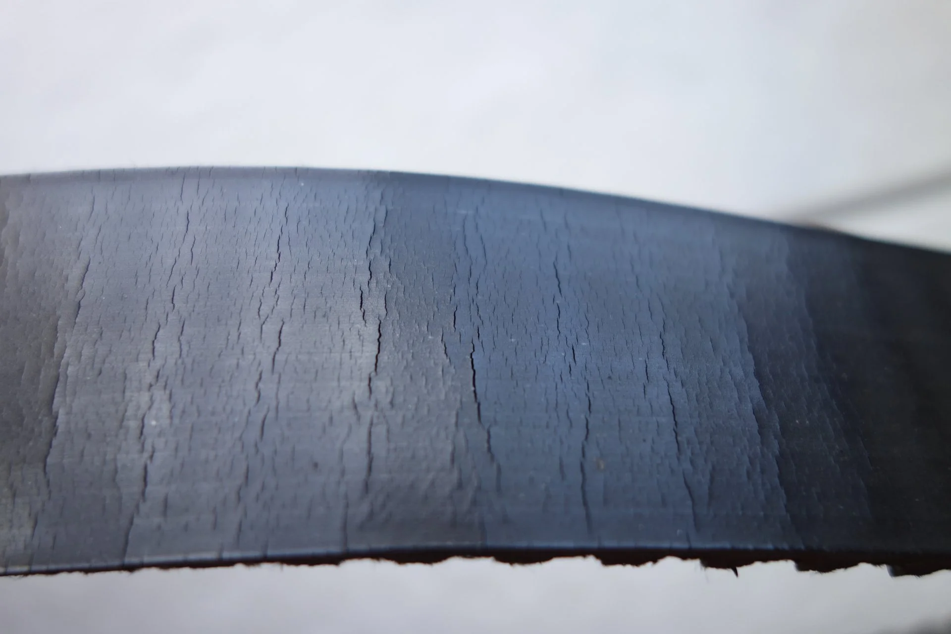

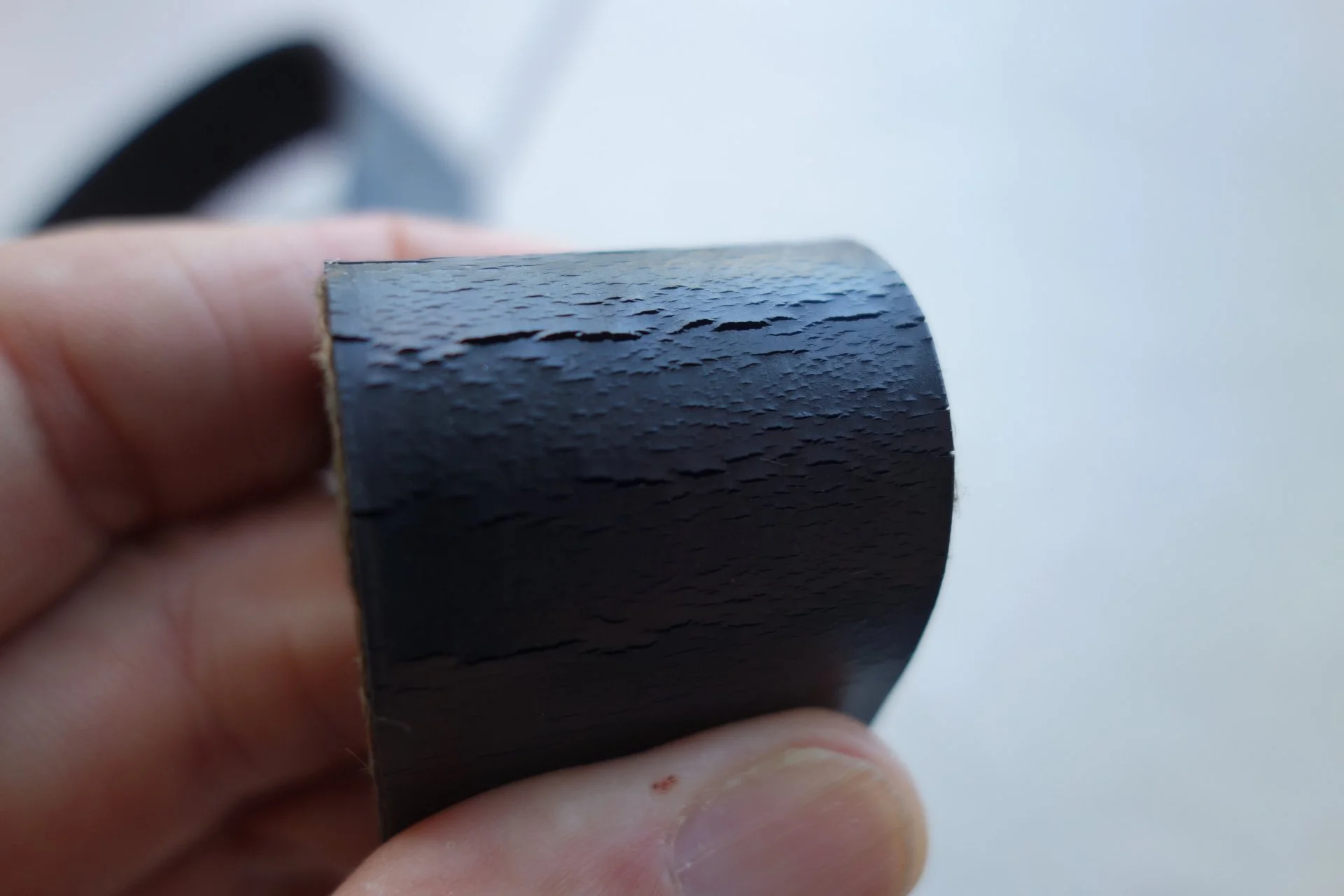

2000 Land Cruiser built in December 1999 with 183,000 miles. First time doing the timing belt. Here are a few photos. Replaced with OEM Mitsuboshi belt. Looks like the rubber has dried out a bit however after more than 22 and a half years I suppose that's to be expected. Truck operates in a hot and humid sub-tropical climate year round.

Looks like a pretty new belt. Even the few newer belts I’ve seen have those slight cracks. Your experience is the norm and my experience on all of my copies.
Nice work, it looks good to me and not surprised to see it's condition.
