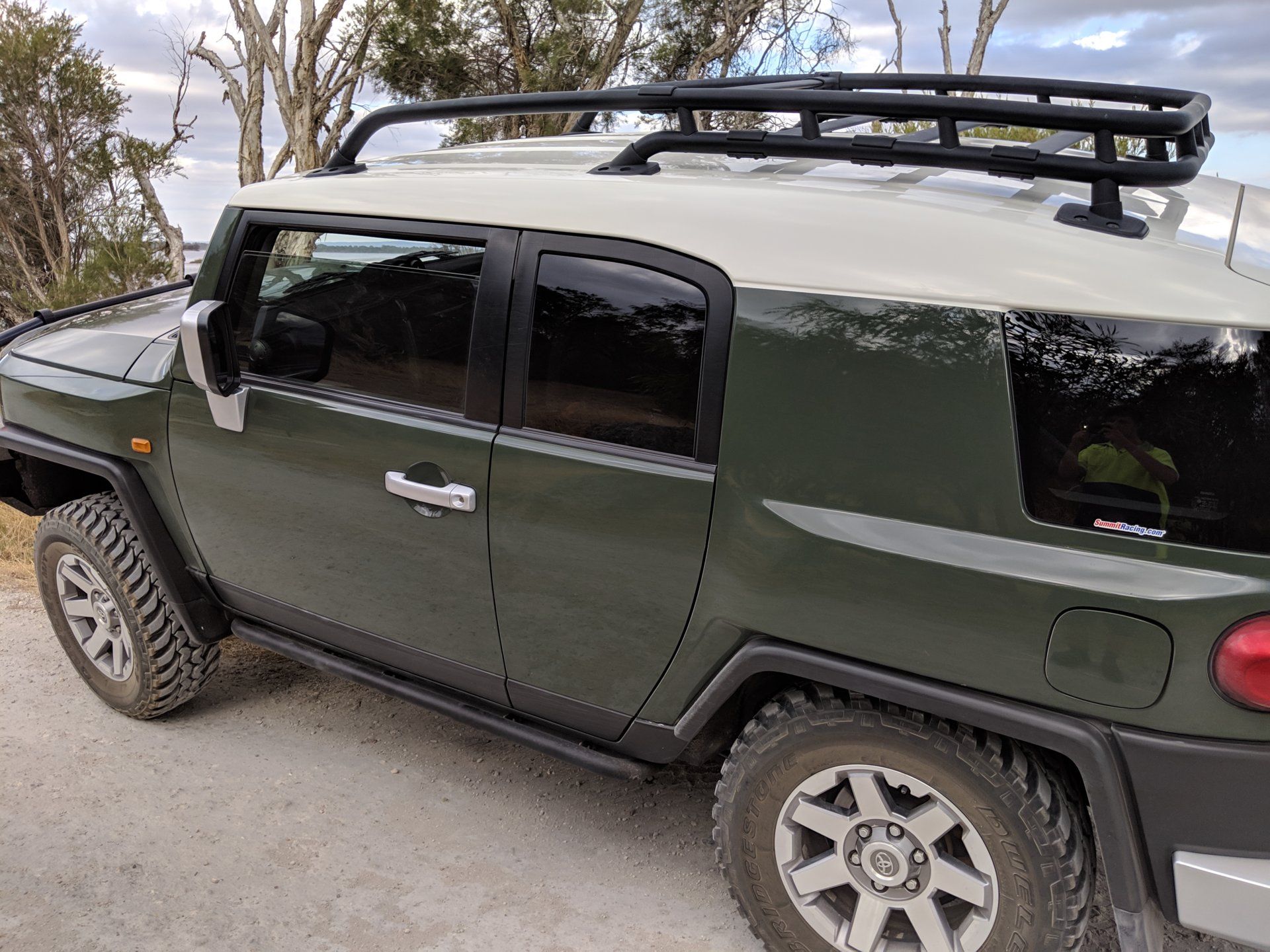

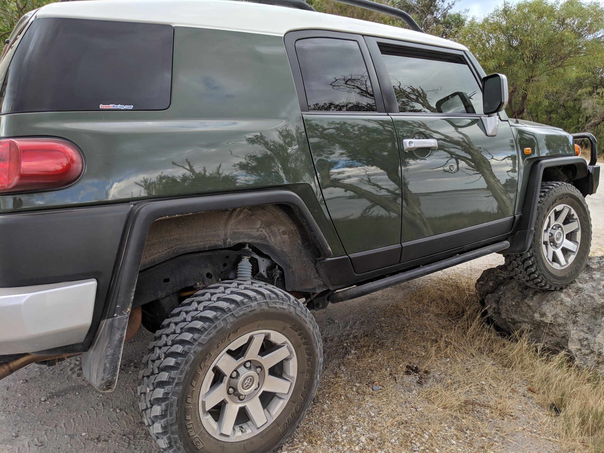

Alloy rack is on. Not the most accurate fit as i think the platform is for a 150 prado and this company just changed the mounts to fit the fj.
Will definetly be the last rack i instalinstall ny self as it was a night mare and close to 7 hours work
Did you borrow @DRANGED 's phone to take those pics?
Looks like a cool rack. 7 hours sounds painful though.
Haha no moved my hand too soon for second photo. 7 hours due to factory bolts rounding out so one we chilsed grooves into, to bang a big flathead in and uncrew it, the other was not coming out at all, needed to be drilled out and had to pull front of roof lining off. To get the threaded bracket out. The locktite was definetly working
I lost one of the nutsert-clippy things inside the headliner once. Luckily it was one of the rear mounts. Still have to empty the entire cargo area and start with the floor, to work your way up to the headliner. Not fun at all.
