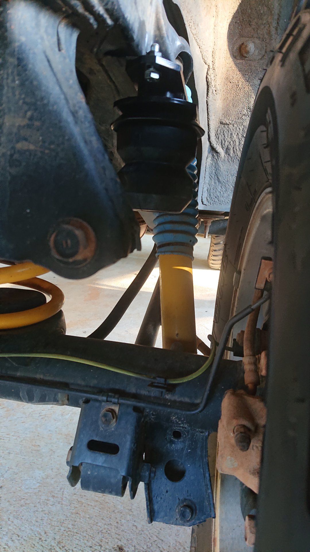

also while im here, the shocks im going to use require bump stop extensions amongst other things, im going to be using timbren bumpstops as part of the suspension upgrade, does any body know if they compress to the same point as factory stops and will require spacers or will they be enough to stop me blowing my shocks appart. need 15mm extra clearance before shocks bottom out.
so here is the first part of my suspension upgrade
bilstein b6 shocks (80 series rears)
(hilux fronts)

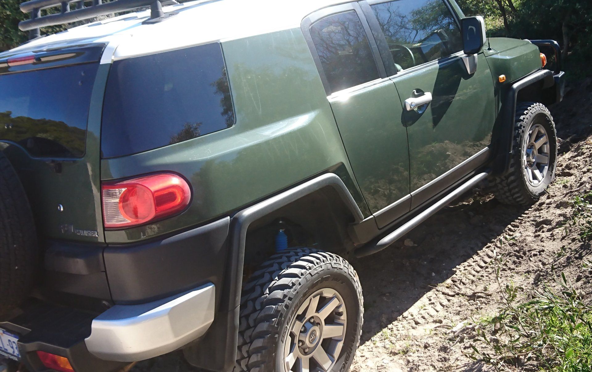

its amazing the difference no sway bar on the front makes, while it did lift a wheel for a couple of seconds over the hole on the left it only felt like a few inches off and didnt feel like the car was on any peculular angles, glad i did my research on the right bilsteins and got a 575mm open length and didnt opt for the standard off the shelf set up although annoyed i only found out after that distributor in aus here can extend them out all the way to 605mm
Rear locker mod is done and rear timbrens have been ordered, I just hope sd truck springs sees my email before processing the order as I ordered the lod carrying version accidently
Ok people can i have some expert knowledge here, i have a company that can build me longer struts then wat im currently using which have an open length of 575mm, they have told me my bump stops may need spacing as the closed length of the new strut is 15mm longer then factory.
My question is how thick would i need to make my bump stop spacers? Is it still the same 1.85 ratio or is it different as the bumps are further inboard?

Ok so the correct timbrens have been ordered as i messed up the first time and ordered the load carrying ones not the active bumps. Will upload photos once installed
