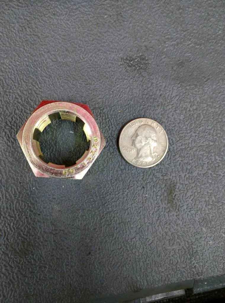

Thomas doesn't have one. Are our drain plugs really that big? He thought it was a m8x1.5. He shot me a picture of an m18 die and its larger than a quarter...
Nevermind...think he was thinking oil pan bolt, not drain bolt...carry on.
