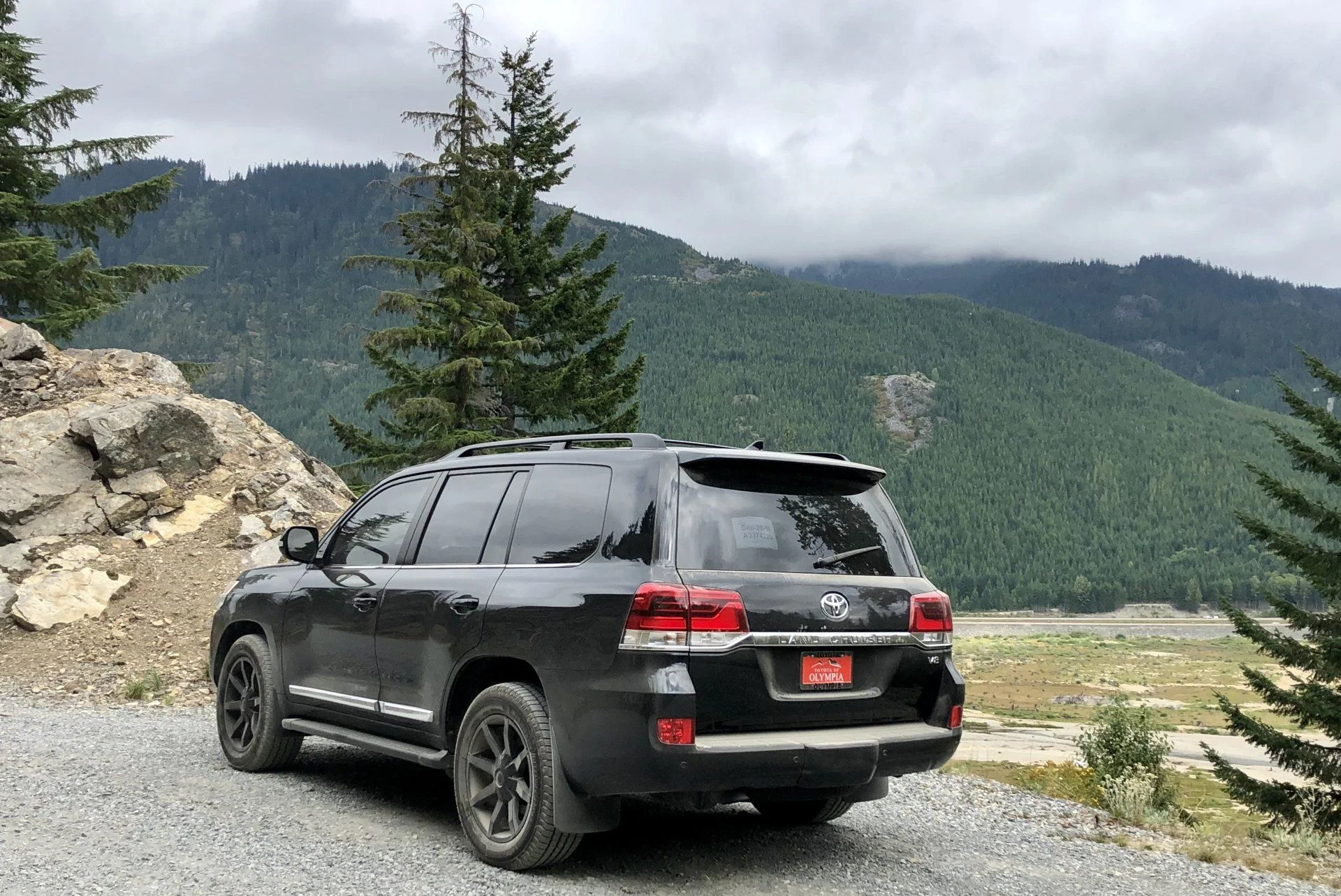

In short- Do KO2s on 20” wheels make any sense?
I’m sure this is a super loaded question but I have an existing set of 20” KMC “Slide” wheels that came on my used 2016 LC200. I’m not crazy about their quality long term but they seem fine for now. Thing is- I want KO2s as a one tire quiver for commute, off-road and snow. I just got a sidewall flat that will require replacing at least 2 Michelin Defenders and I’m debating just switching to KO2s on these wheels.
Should I just get a set and put them on these 20s? Had planned to go with 18s eventually but this is time sensitive now and kind of forcing my hand.
Go with KO2s on larger than ideal wheels or fork out for 2 new Michelins and be stuck with those for a few years?

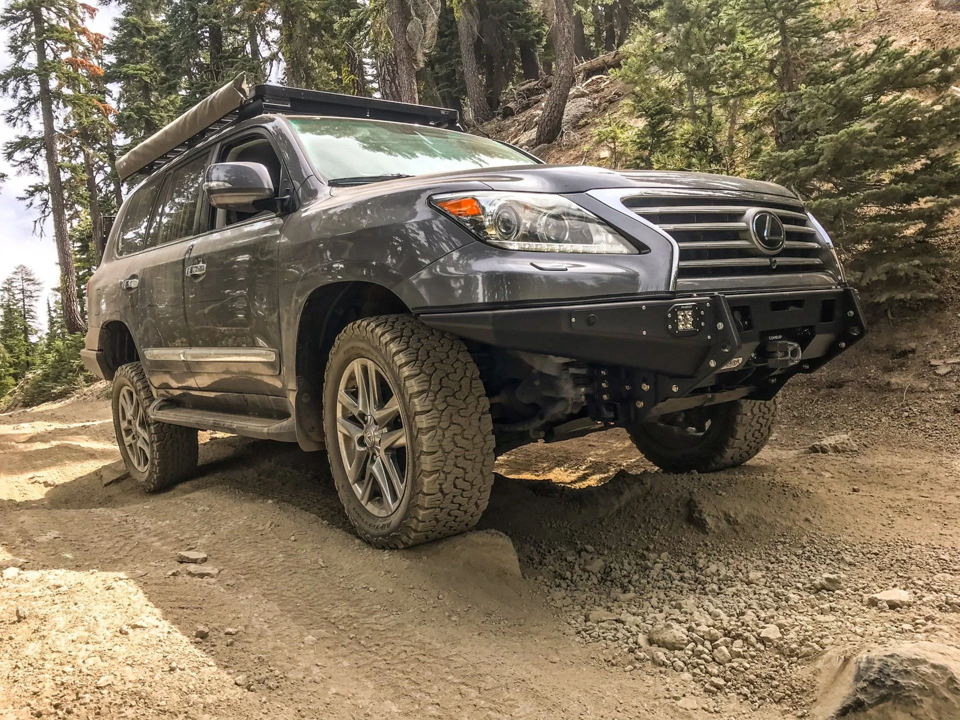

I have been reading here for a bit now. I have 20s on my LX. As a result I have watched for KO2s on 20’s. Several have done the BFG on 20s. I have (NOT BFG) 275/60/20 on my LX. They certainly have enough sidewall for some off-road work and a lot more than the stock 285/55. The OD is 33” and there’s no rub even when my suspension is set to low.
If I were you I’d either get on Craigslist and do 18’s now or commit to BFGs on 20’s for a while.

I’m running KO2s on stock 20s on my LX. I was in the same boat - had to replace tires but I wasn’t ready to commit to new wheels. I have been running mine for about 1.5 years and haven’t regretted it even though I will soon replace them. They are tough tires.
They are a stiff ride, but honestly, anything on 20s is not going to ride as good as 18s.
