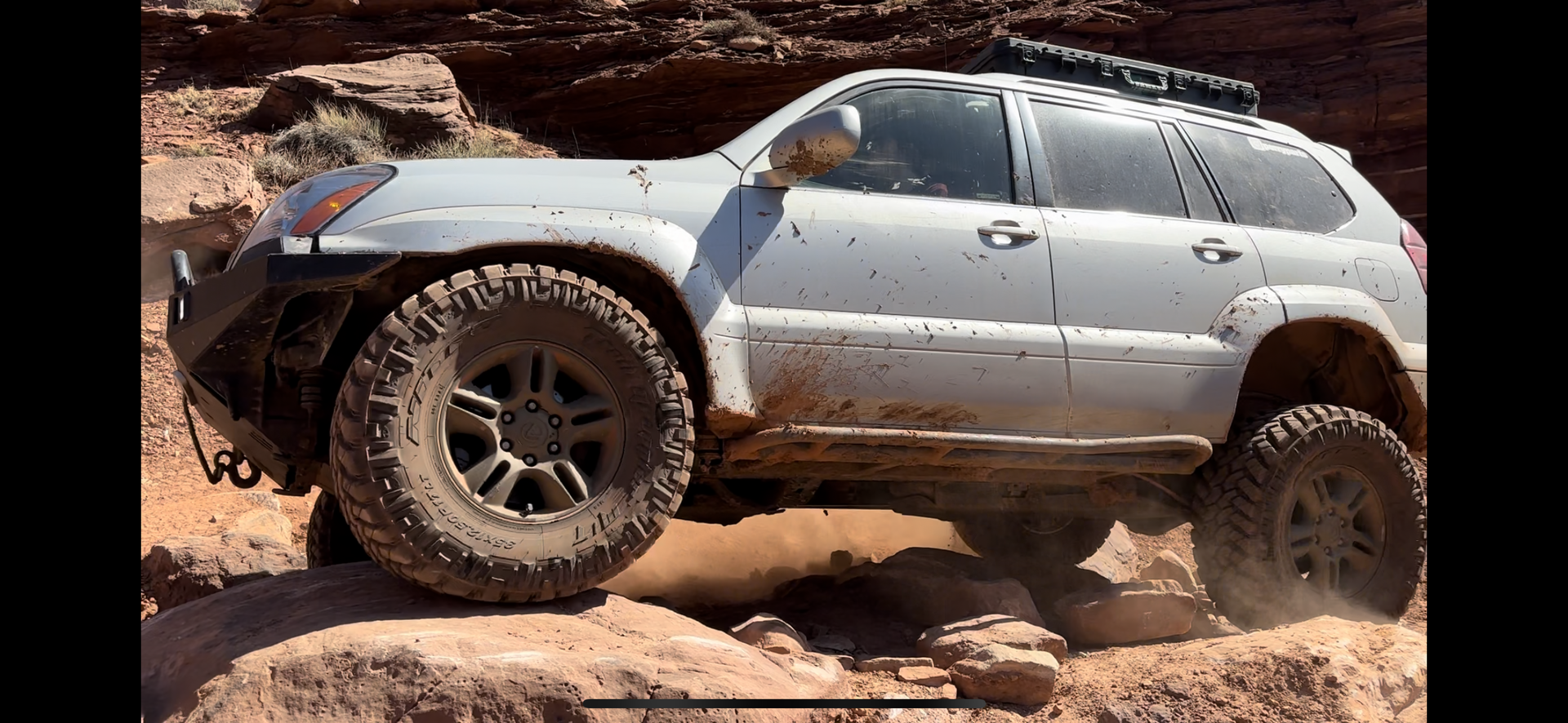

Hey folks, sorry for the delay, I’m usually a bit more on it with responses. Blew up a diff yesterday in Moab and had to limp our way to civilization!

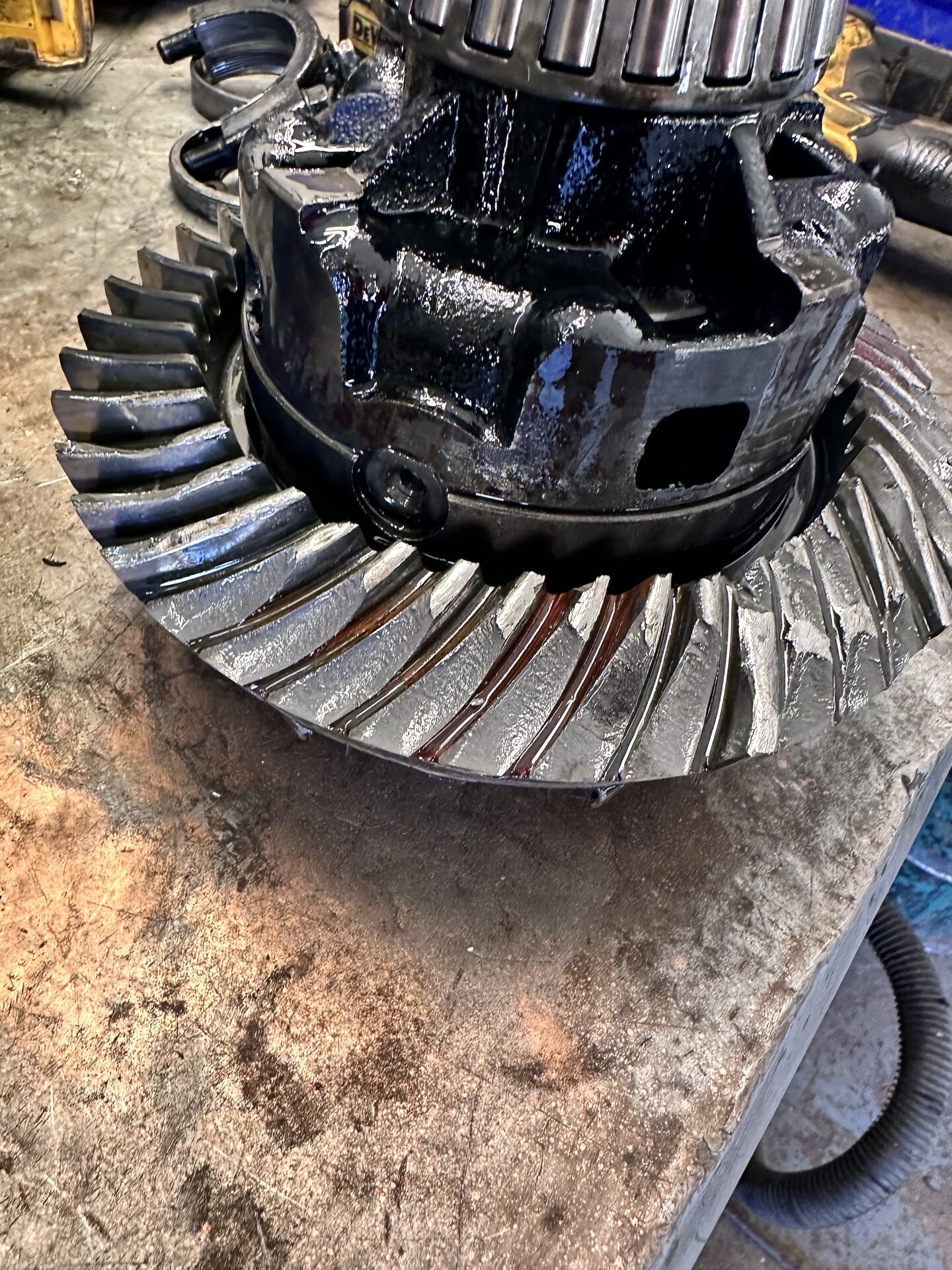

Pic of the ring gear, and where we blew it up… just because I’m amazed we got off the trail!
What trail? Rear diff with axle locked? Are the GXs semi or FF?
Still running the stock 8” diff in that GX? If so Lockhart was a bold choice lol.
Rear diff blew, with center locker on, and rear spartan locker aka lunchbox locker.
The GX is semi floating based on what I saw today
The GX is semi floating based on what I saw today.
I can only imagine how fun that was on the way out. But sounds like you made it.

@tbisaacs You know it! I needed an excuse to get an 8.2 in there. I think I have one now 😎

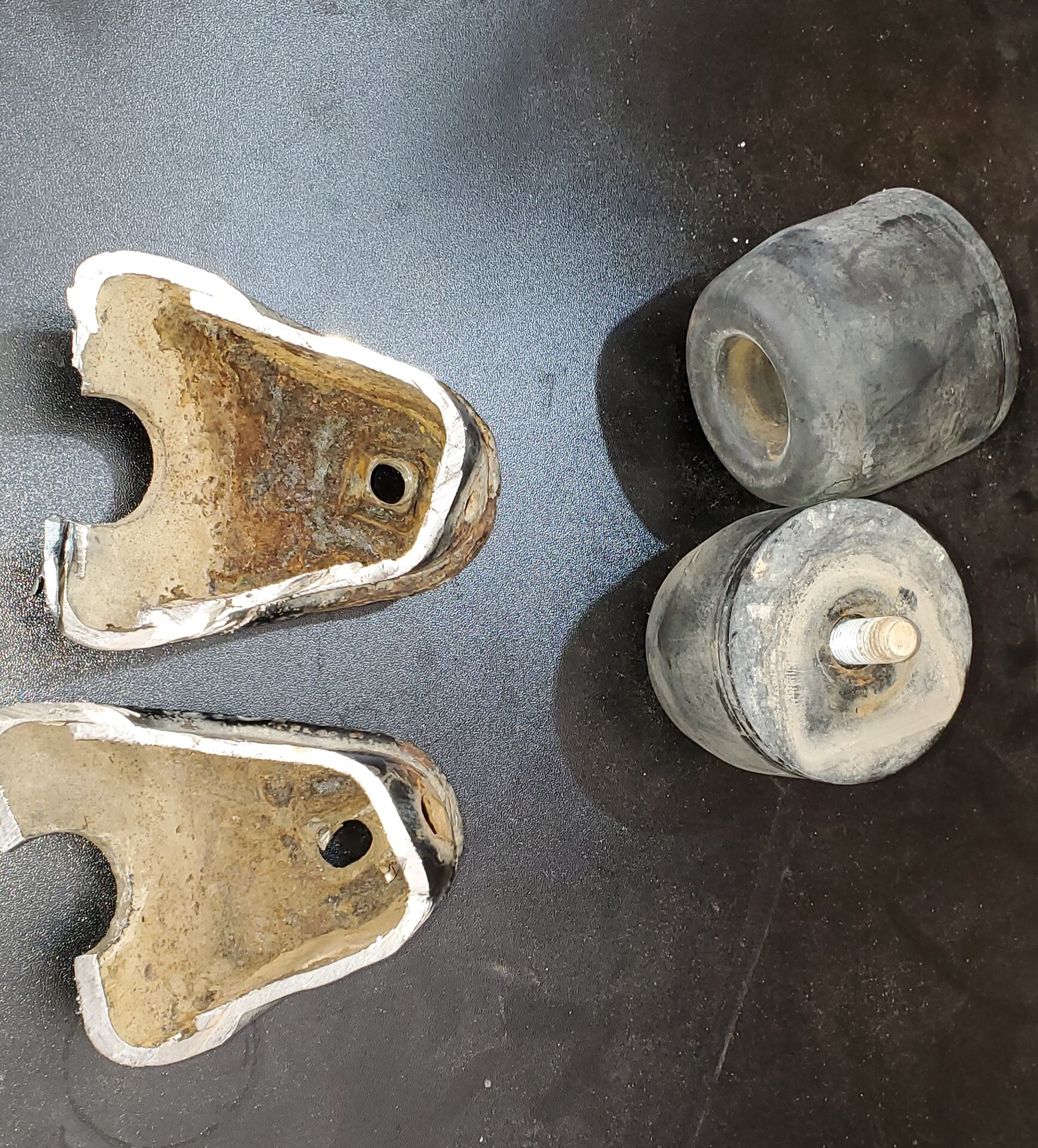

Well considering the truck isn't but three years old I am surprised by the corrosion on the end of these OEM bump stop bolts. They were a real bear to get out because of it. One project down, 19 more to go lol.
Mine are completely welded on. I gave up on the spacer i needed to install. And i never give up on a project.
Does penetrating lubricant help at all? I like Kroil or PB Blaster, but 50/50 acetone and ATF is supposed to be the bomb.

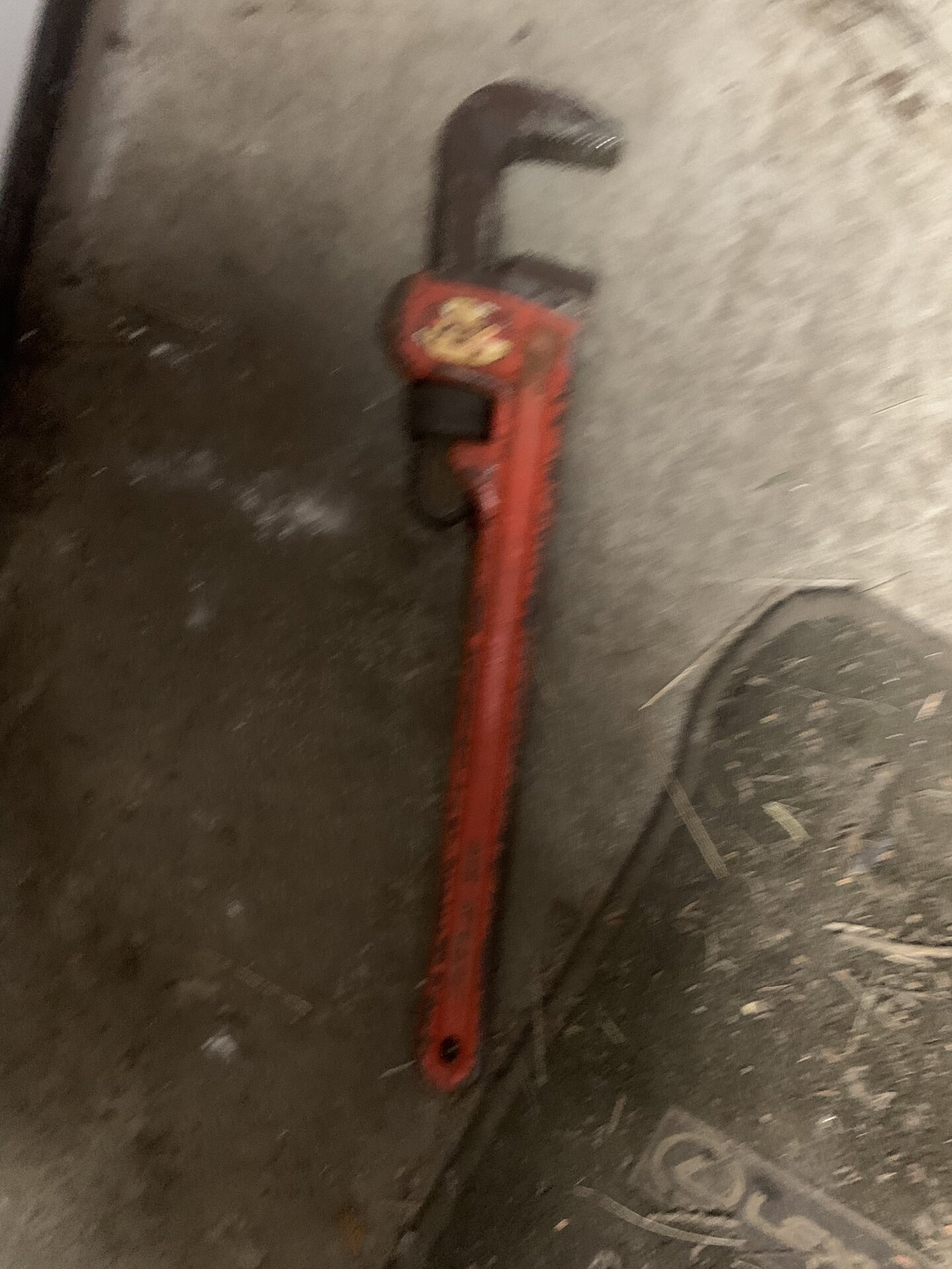

I used a giganto pipe wrench to move my bump stops. Had to grind a lot off to clearance for my Kings.

I am sure any type of penetrating lube would certainly help, especially if allowed to soak overnight. I didn't use any as I expected them to look better than that for less than three years old. These Toyota's rust on the assembly line lol.

No amount of soaking, even 3-4 days did anything for me unfortunately. Isn’t there some type of tool / socket for those things? I remember something along those lines anyway. Welding is above my pay grade.
It's close to a 2" socket, maybe 1 7/8"? I used the giant monkey wrench and it worked, just not a lot of room to swing it for more than a 1/8 rotation. For what it's worth, it took a lot of torque to get them to move, almost to the point of where I thought I was going to strip the edges or break it off. Having the larger wrench was sort of like having a cheater/breaker bar to get that extra leverage. How big or little are your musk-les?
