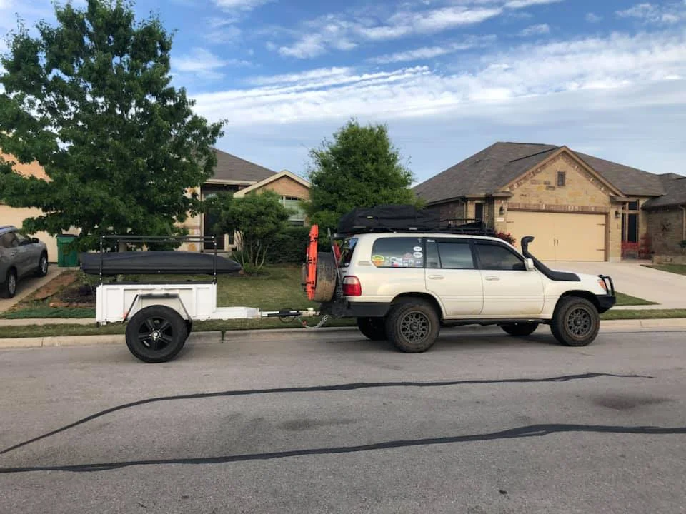

The trailer I recently bought (Morris Mule knockoff) was equipped with the Timbren 3500lb Axle-less suspension. I outfitted it with 33" off-road tires and experienced a catastrophic failure of the hub that damaged the spindle beyond repair. This occurred within 50 miles of putting the new wheels on. I had driven the trailer nearly 500 miles home on it's stock 27" road wheels/tires and experienced zero issues. The bearings rolled smooth and the grease was a bluish color. I pulled the one still-working wheel off yesterday and noticed that the grease is a grey color with a silvery sheen. Pulled the bearings and they are clearly scouring. So, the other hub is failing too.
Here's where it gets interesting and I think people would benefit from this research. Timbren offers TWO different 3500lb 4" drop axle-less options. The one I have is evidently designed for road tires and travel. It's noticeable in that it has a 4 bolt brake plate and uses a 2" square crossmember to connect the sides. It also uses a 5x4.5 hub. The other option is their HD which uses a heavier spindle and a 5 bolt brake plate with 2x3" crossmember and uses a heavier 6x5.5 hub. eTrailer and a couple manufacturers I spoke with say that the HD is the version to go with for off-road travel and heavier tires. They have said that the other version can induce flex when using heavier/larger tires off-road that can lead to catastrophic failure as I experienced. I am now faced with significant corrective costs as I must buy an entirely new HD setup ($800), hubs ($140) and adapters to convert to 5x150 ($140) PLUS have someone cut out the 2" cross-member and replace with a 2x3". I figure this $3500 trailer is about to cost $5500 or more just to correct the issue that the wrong 3500lb axle-less suspension was put on (for my intended purposes). Additionally, I'll have a perfectly fine 3500lb 4" drop standard setup that I can't use. Hopefully someone needs one for their road going trailer and I can recover a few $$.
Anyway, hope this helps others who may build their own trailers or are looking to convert their standard axle trailers to axle-less save some hard-earned cash and time. I'm literally sick over this as all that money to fix this was intended for upgrades like electrical/solar/linear lifts, etc.

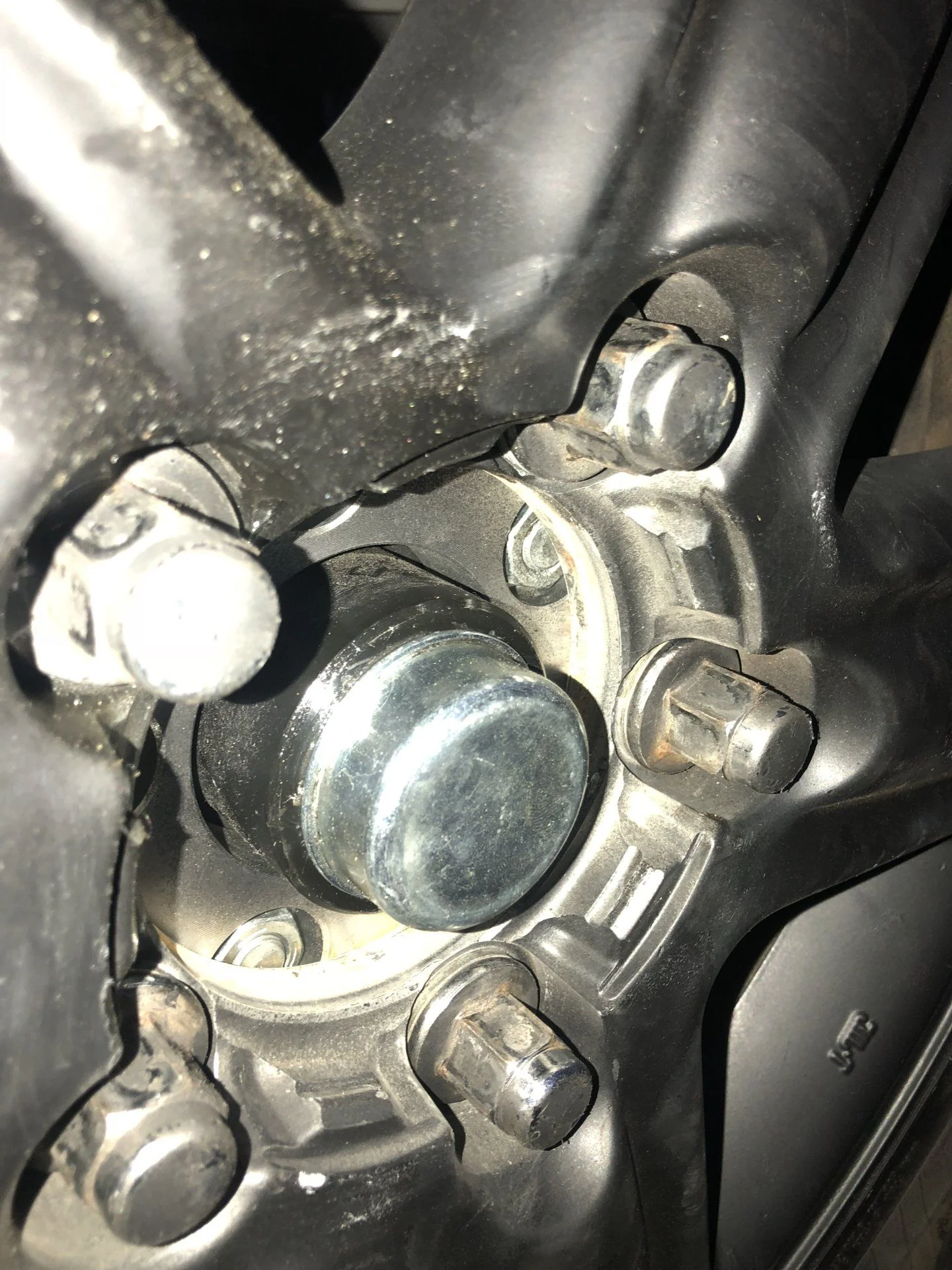

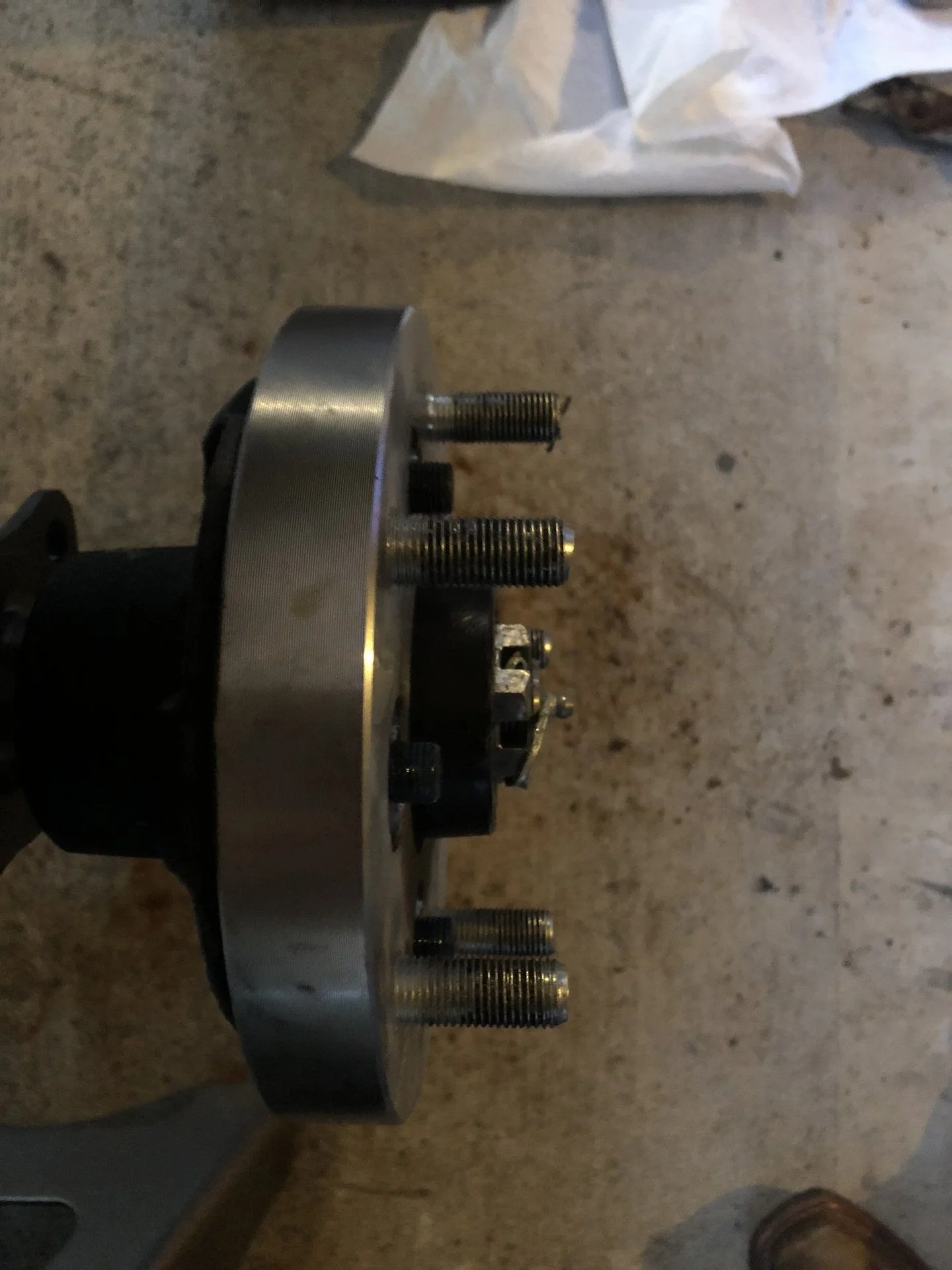

Well, got the new spindle and hub. Installed spindle and hub only to realize the studs on the hub are too long. They extend beyond the 1” adapter and interfere with installing my full sized wheel. Can I cut the studs with a grinder? Or, do I need to order a hub with correct stud lengths? Thinking of just picking up a 1750lb hub from Northern Tool identical to the other as its studs are the correct length. Now that I know the hub was originally overtightened, I’m not as afraid of using a Northern Tool hub. 2nd pic is the new hub showing studs extending beyond the adaptor. The 1st pic is the Northern Tool hub that I cleaned, regreased and installed correctly showing that its studs don’t interfere.
I'd either cut down the studs...or pound one out, take it to the local auto parts store, and find a suitable (but shorter) replacement.
No need to replace the hub (unless that's faster/easier than the above, and for only a few more bucks?).
Personally, I would shorten them with a grinder.
- Brian
yup, easy to cut them, however put a threading die or at least a nut on the studs before you cut them and bevel them afterwards. By the time you do #10, you'll be down to 30 secs each...

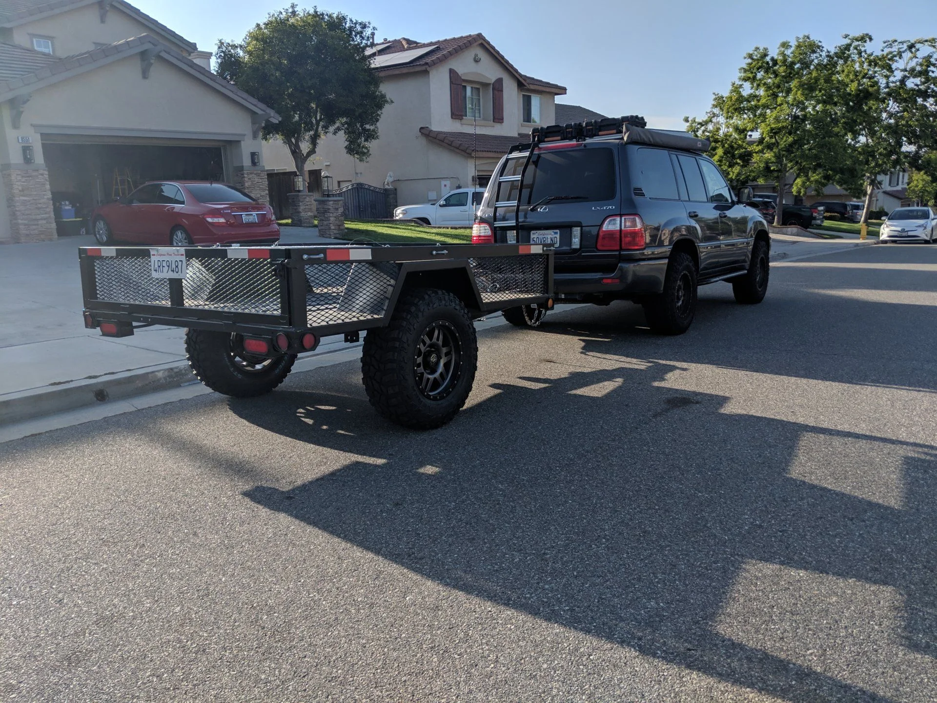

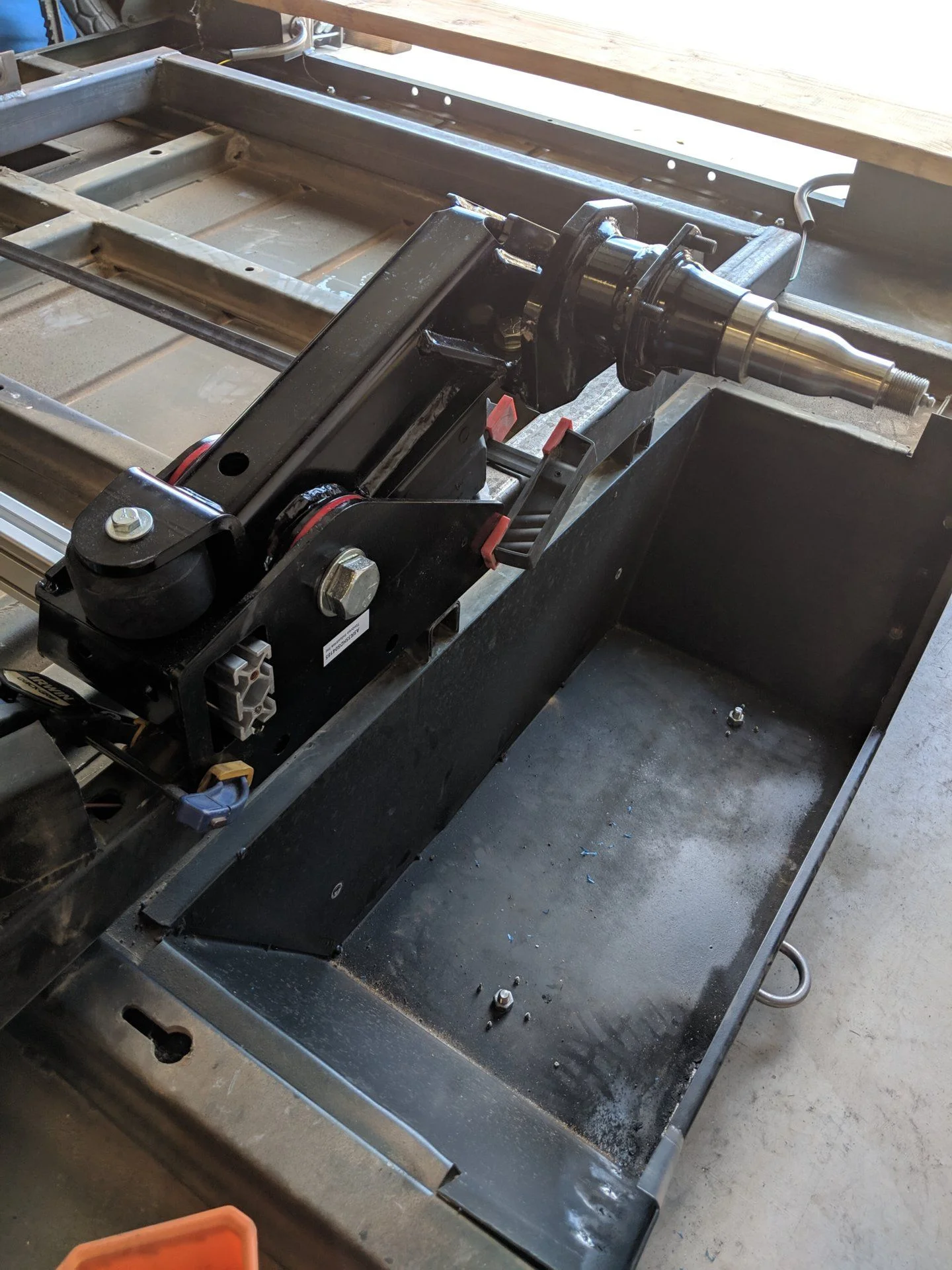

I had the same issue when I built mine. I went with the HD with off road spindles. Needed to purchase the 12" brake kit because the 10" is not compatible with it. I also used 2" wheel adapters that are 2 piece. This was to clear the lug bolts so that I did not cut them. I have a 25mm offset on my wheels, which match up perfectly with the 2" spacers.
