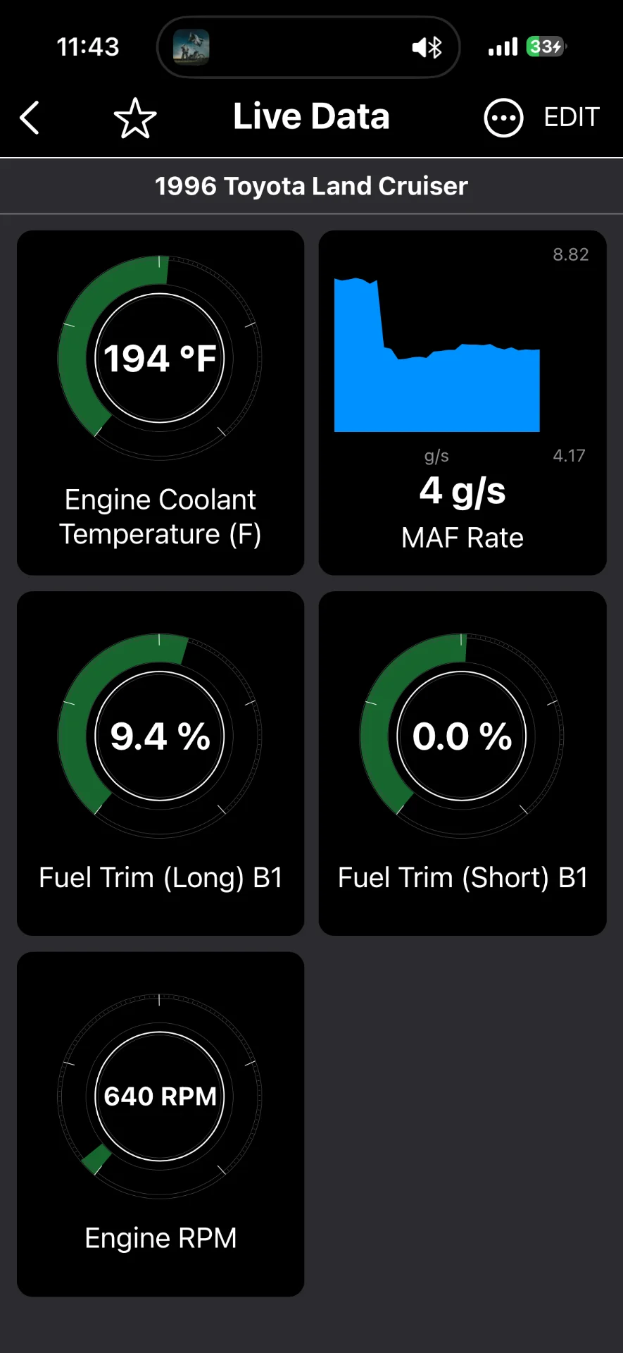

Cleaned the MAF. The fuel trim long is slightly lower (maybe). Also filled up with premium which helped decrease pinging. Most of the day had little pinging and in the Texas heat in the afternoon the pinging came back a bit worse on a highway run.
This is idle. Will try to get the engine to reproduce the pinging and capture the numbers at that time.

15.6% long term fuel is a lot. I suspect you have fuel injector issues, and some of your cylinders are running very lean.
yea fuel trim is pretty damn high. what's your calculated load at wide open throttle? does it ping at all then?

The first thing I would do is verify the timing accuracy as mentioned above. Then, I'd yank the injectors and send them out to be flow tested and cleaned if necessary. Generally fuel trims can max out at +/- 25% before a check engine light turns on. The ~15% means the computer is able to "correct" the fuel trims, but it's adding quite a bit of fuel to do it. If you have one or two cylinders with partially clogged injectors, those cylinders will be running lean, while the other will be slightly rich.
I believe the FZ engine has two banks, so there should be a bank 1 and bank 2 fuel trims.
