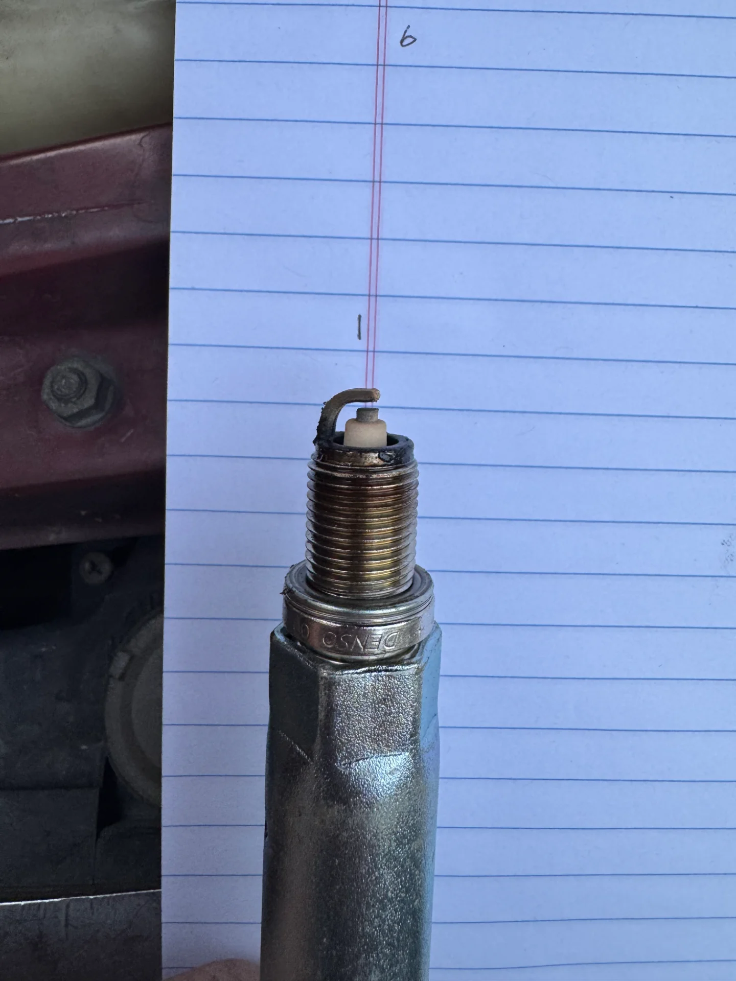

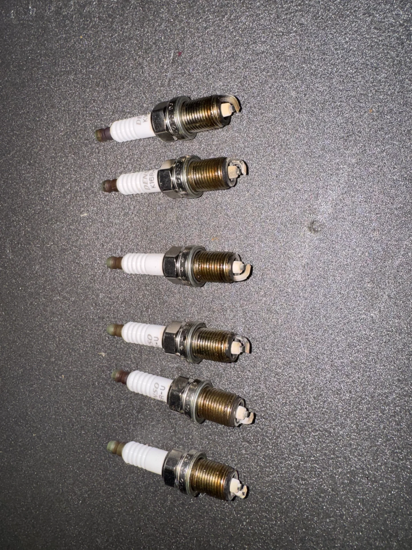

Sometimes upon start up, when idling for a bit then pressing the gas. When getting into motion there’s a some smoke at times at the very start. Top to bottom is 1-6. Also I believe the burning oil has killed my cat I replaced a few years back. Code P0420 is on the dash. 1 year old 02 sensors.

Given what I see in the photo, the plugs appear good

Hard to tell from the photo but are the plugs covered in ashy deposits or just discolored?
White-ish deposits, I’m thinking it’s running hot/burning a lot of oil (which it is) or it’s too rich. Looks like pretty good carbon build up too.. What’s your read?
That one doesn’t look terrible.
Lots of ashy deposits usually mean misfire and/or burning oil. You know you’re burning oil so…

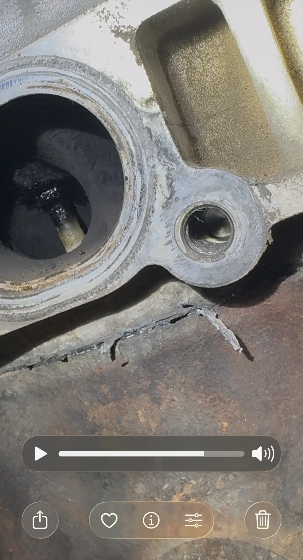

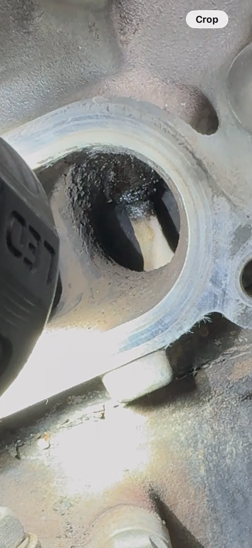

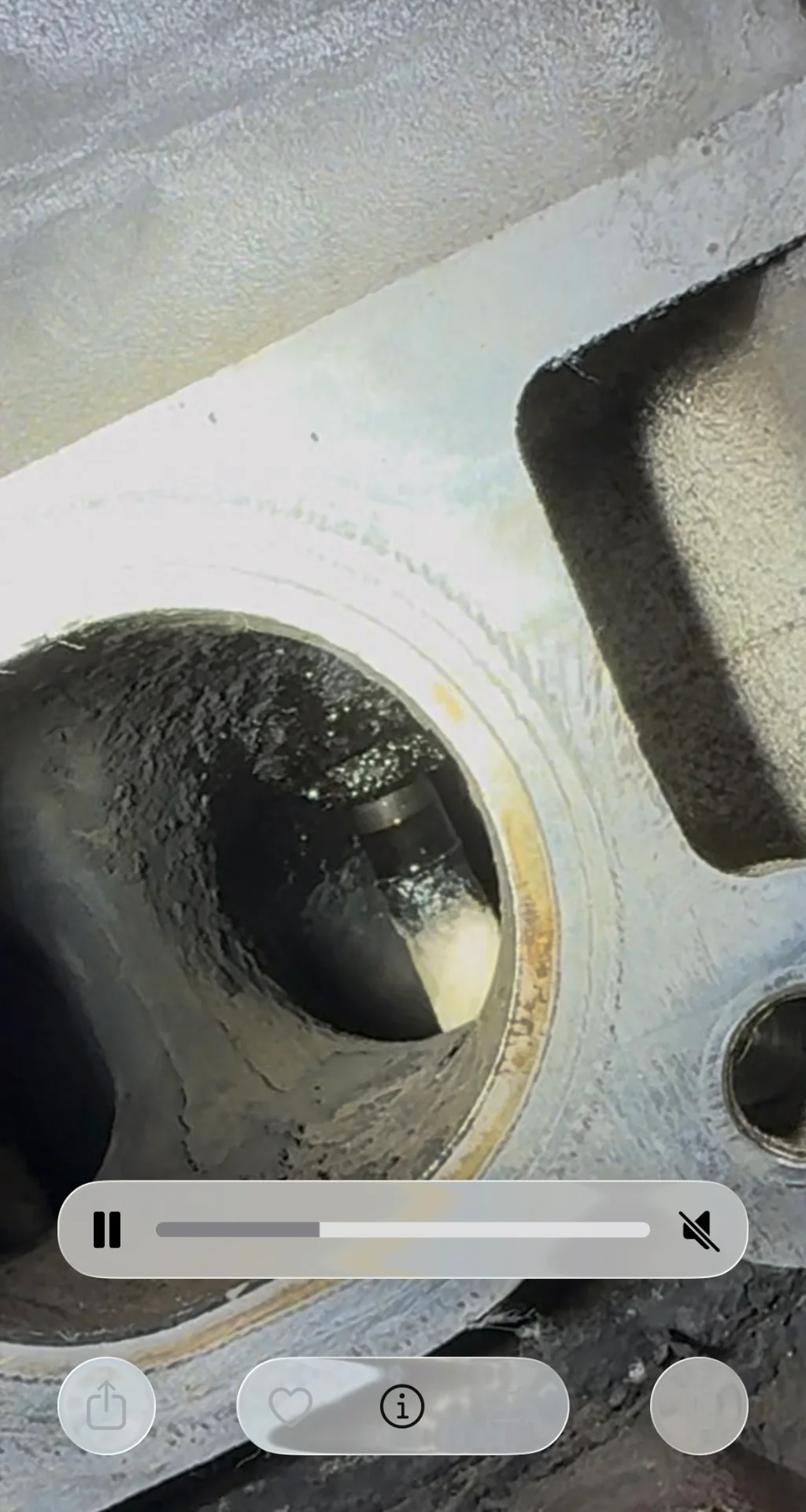

3 degrees using a computerized timing light to check. Here are some pics of my exhaust side valves when I did exhaust gaskets a few weeks back.
Based on the photos of the valve stems and when you are seeing smoke, the valve stem seals are definitely leaking.
Have you verified oil pressure with a test gauge? If that and a leak down test don’t point to rings I’d be confident your problem is stem seals. At 300k it’s probably ready for a new head gasket and full on head refurbishment.
