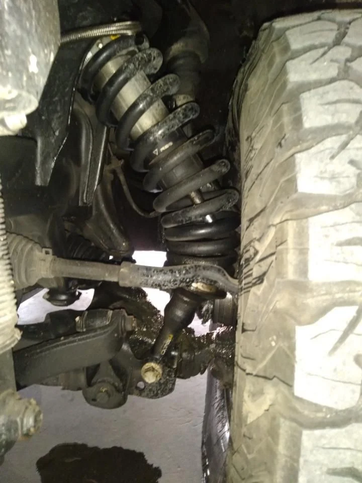

I can tell you I have been pretty frustrated with my BP-51 setup, and those yoo-hoo's over at Toy-tec. I'm also driving a 2013.
