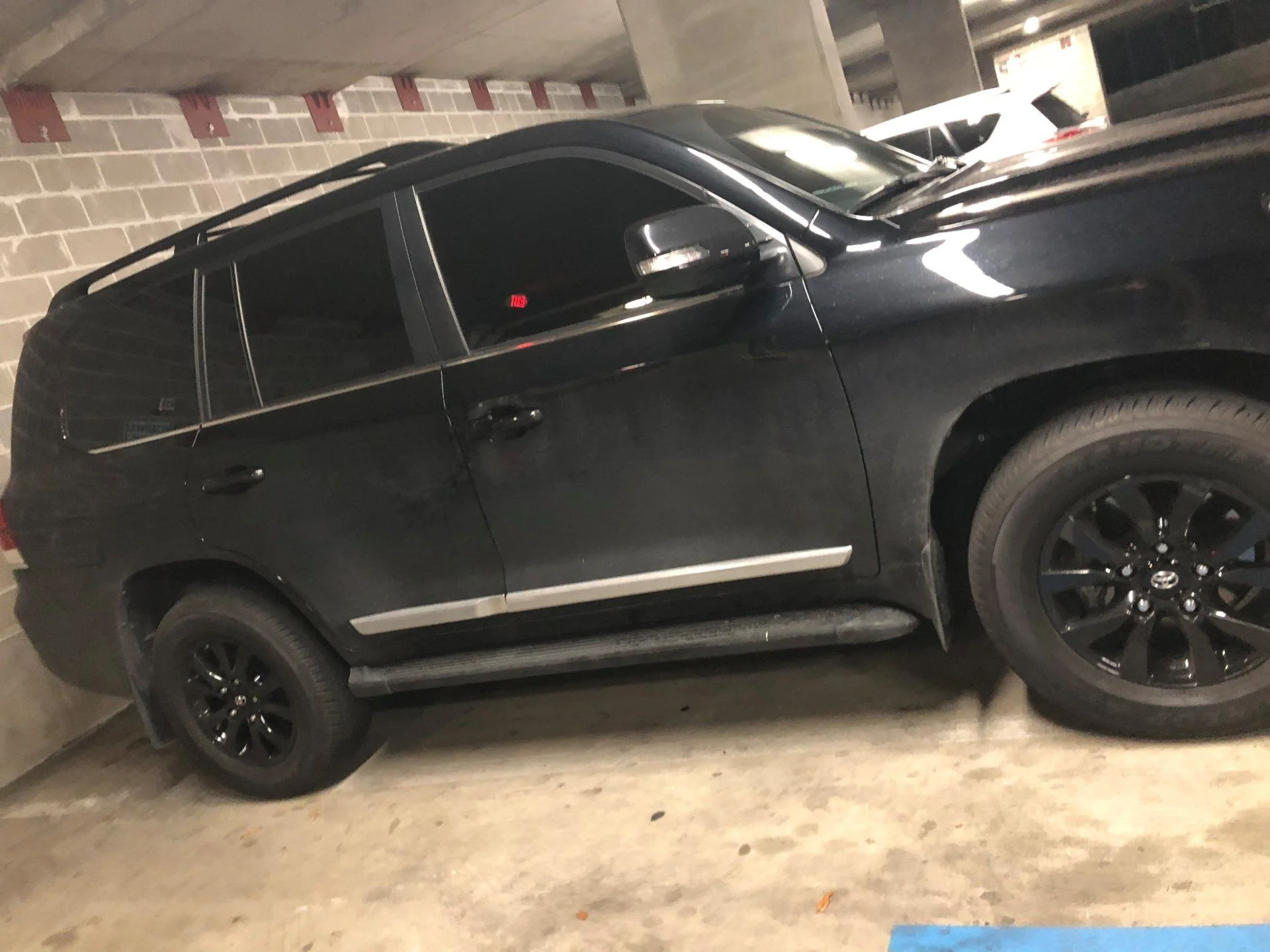

Hello All,
(Excuse my in-experience) I live in Houston and recently bought a 2017 Land Cruiser. I am about getting ready for some upgrades. I want to prep the car for off-roading mostly overland trips. I have a list of things I want to do, but I thought I'd start with suspension and tires. I kept the original 18" wheels (powder coated them Black) and planning on going with OMU BP-51. The reason I am looking at the BP-51s is that I want the ability to adjust the suspension for offroading/hauling/on-road driving.

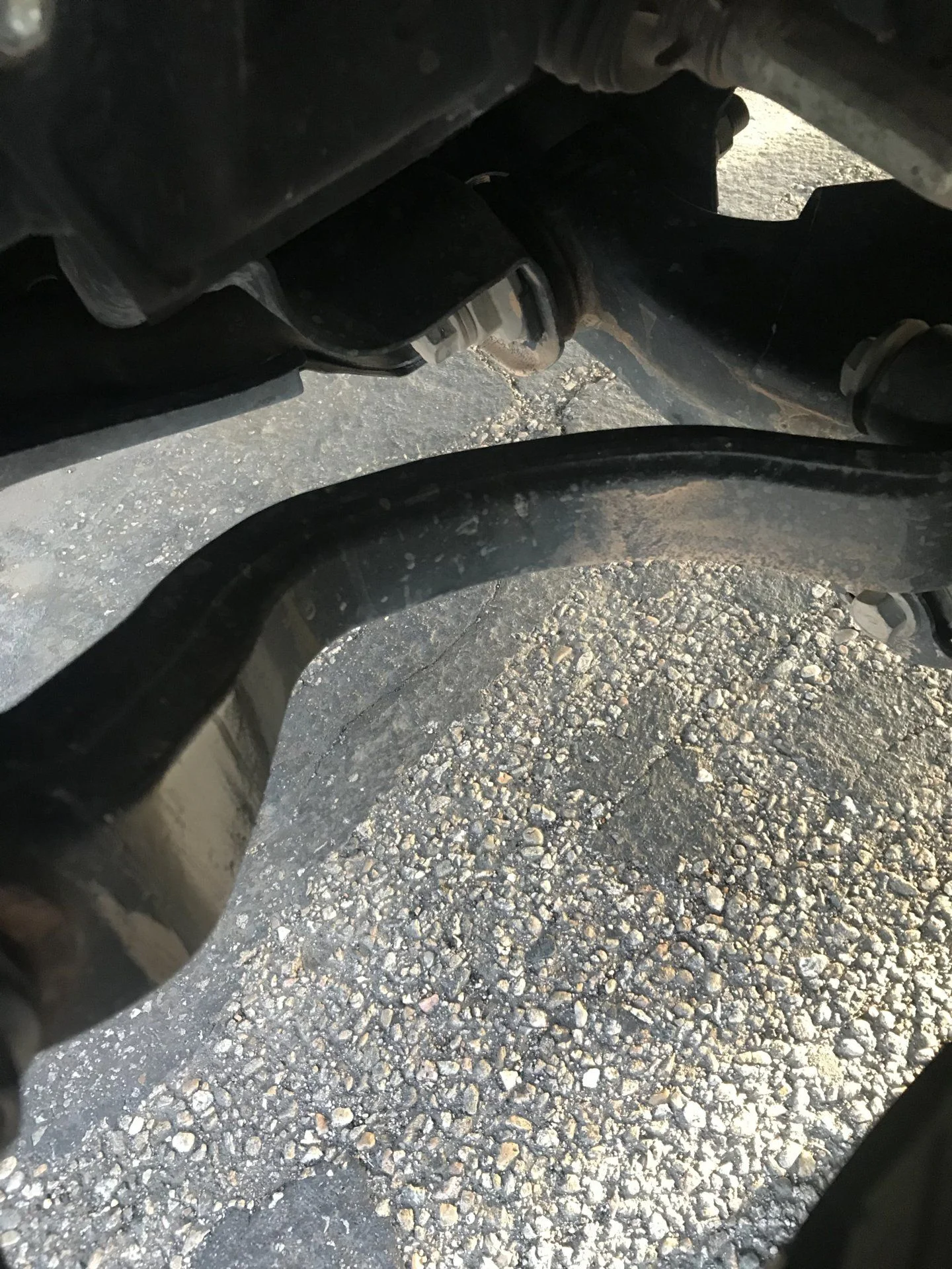

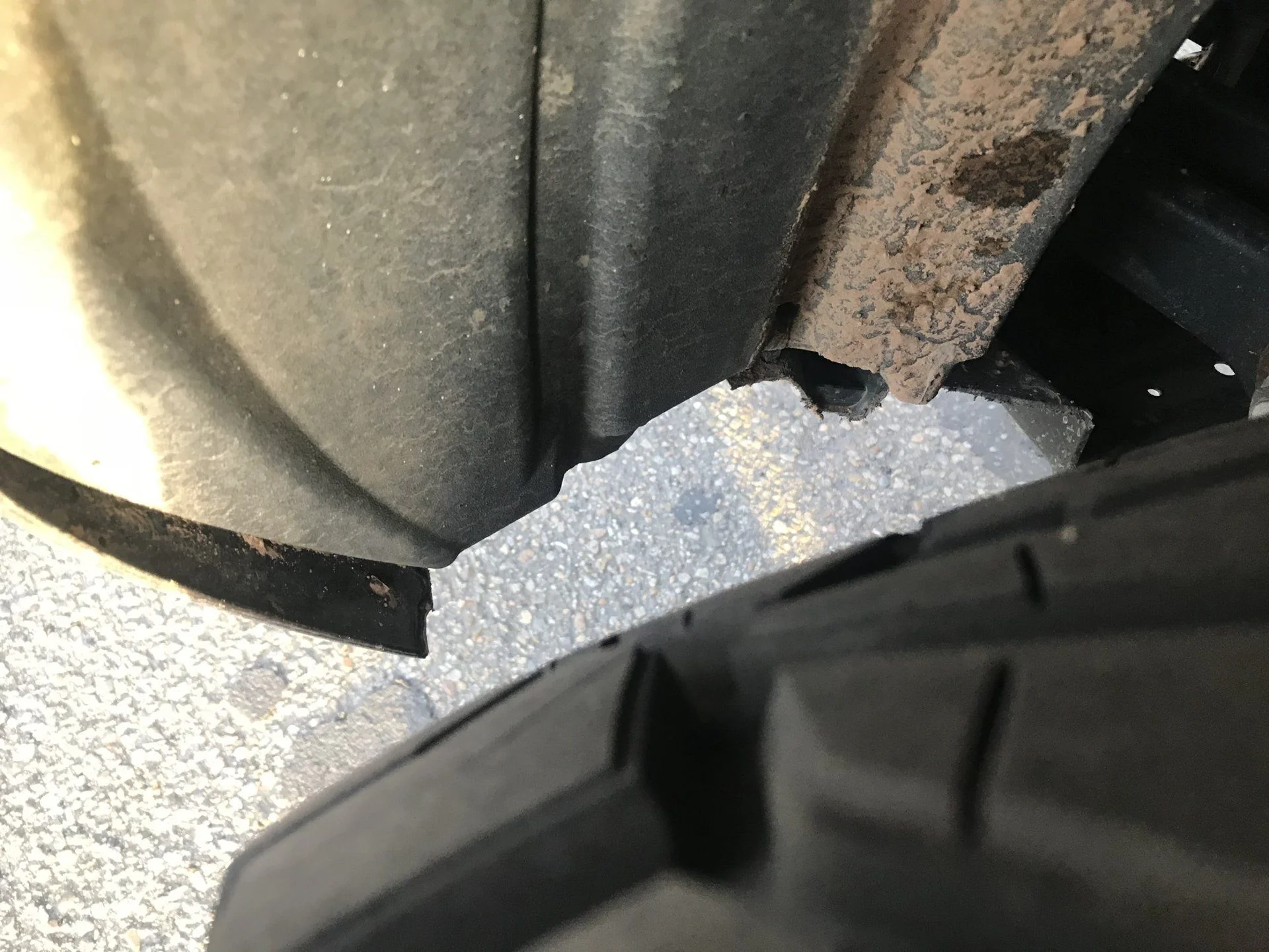

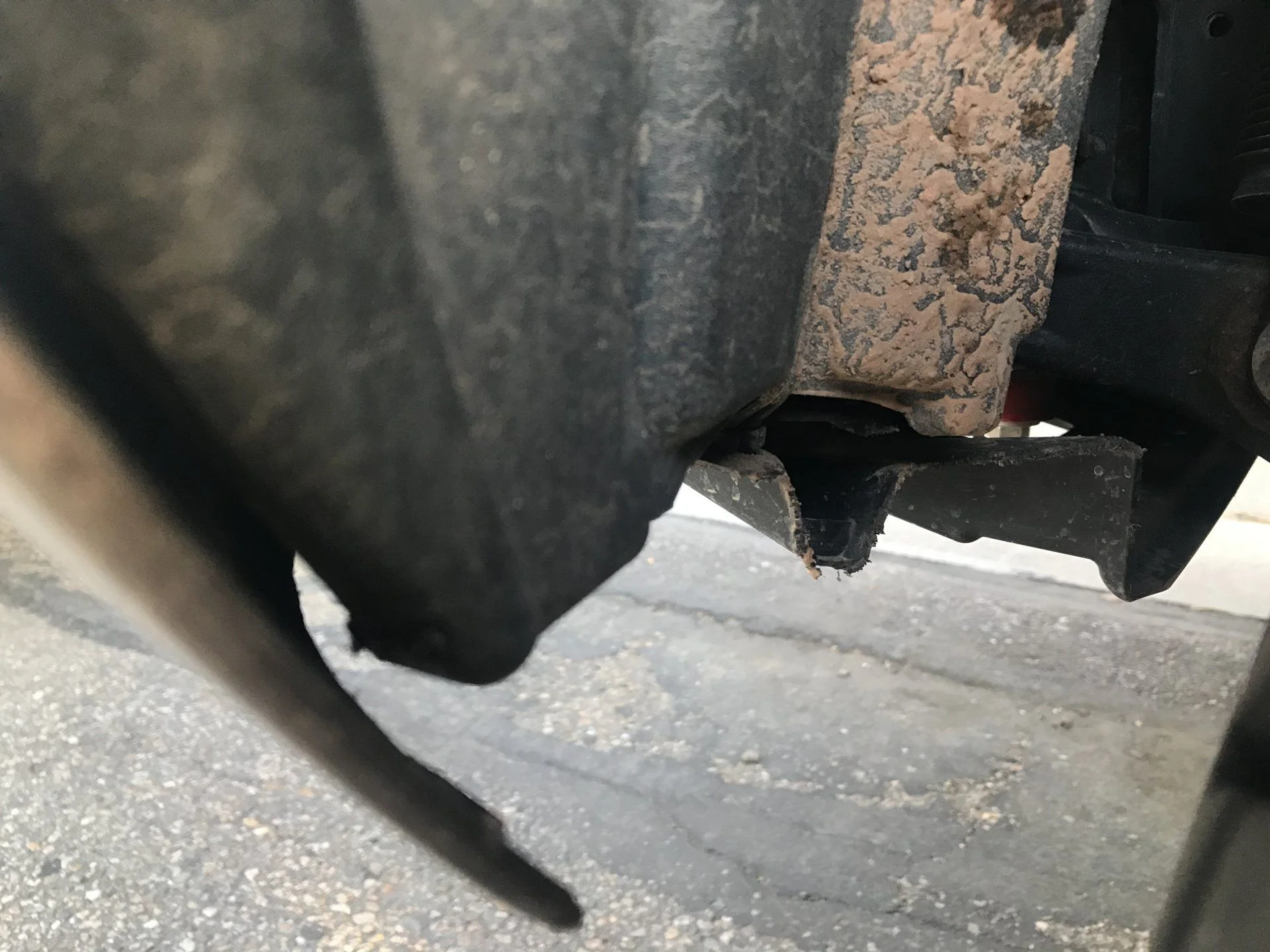

I had to remove the mud flaps and trim the front a tiny bit, but overall very little is needed to fit these tires on the stock wheels. There is no rubbing on the UCA and only the slightest rubbing on the driver side KDSS at full lock. Overall I’m extremely happy with the ride and looks of this setup.
Hard to tell because it’s dirty but the pic shows where it rubs KDSS after full stuff and wheeling and the other 2 show where the trimming happened. Very light stuff

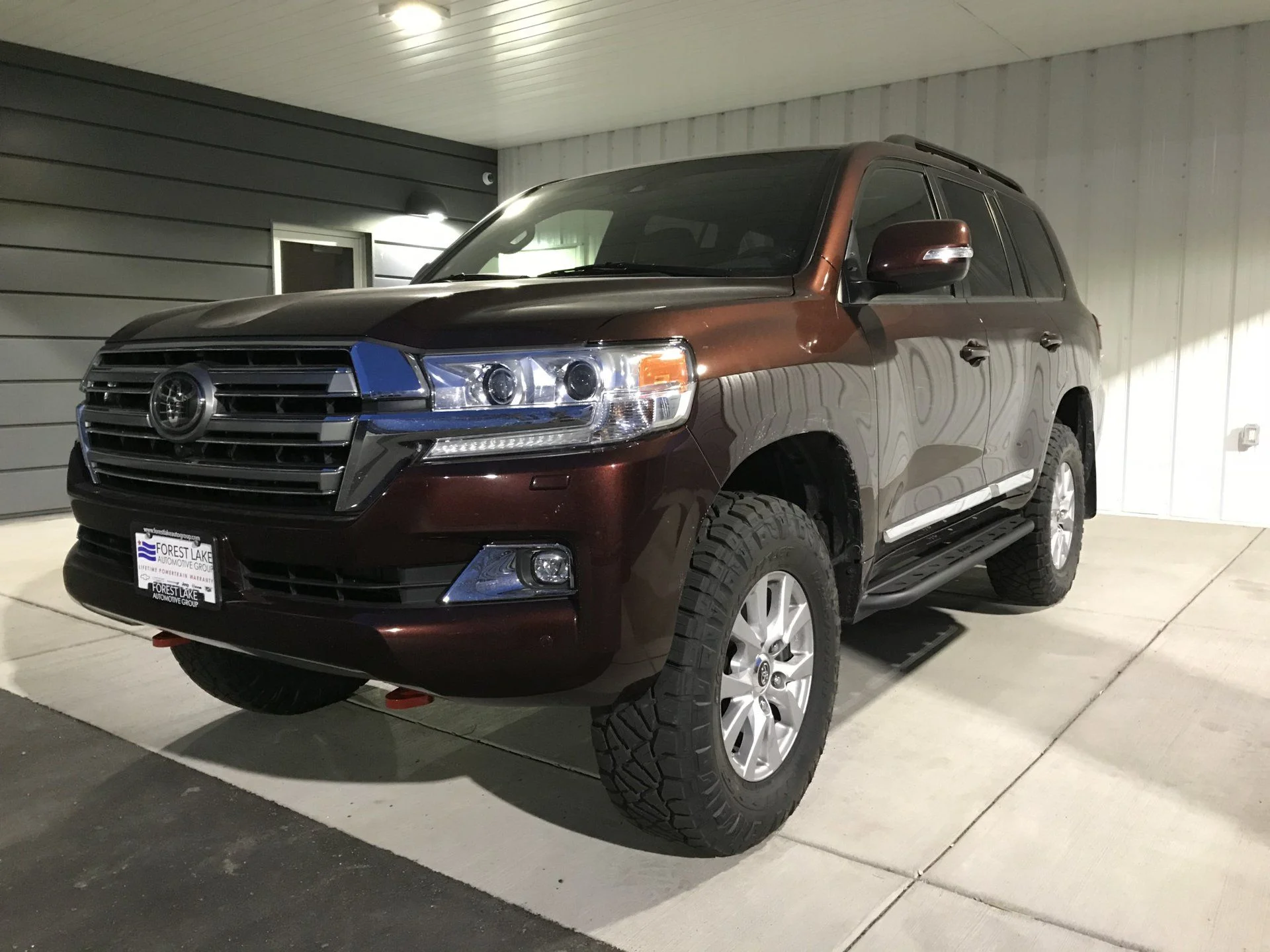

I you want to avoid all the cutting and rubbing go with 275/70R18 Duratracs, they fit just fine... they are 33.4x11, the Nitto's 285/70R18 are 33.98x11.5

Interesting I have them on my stock wheels (2016 LC) and no issues (I do have Factory 1" in front)
