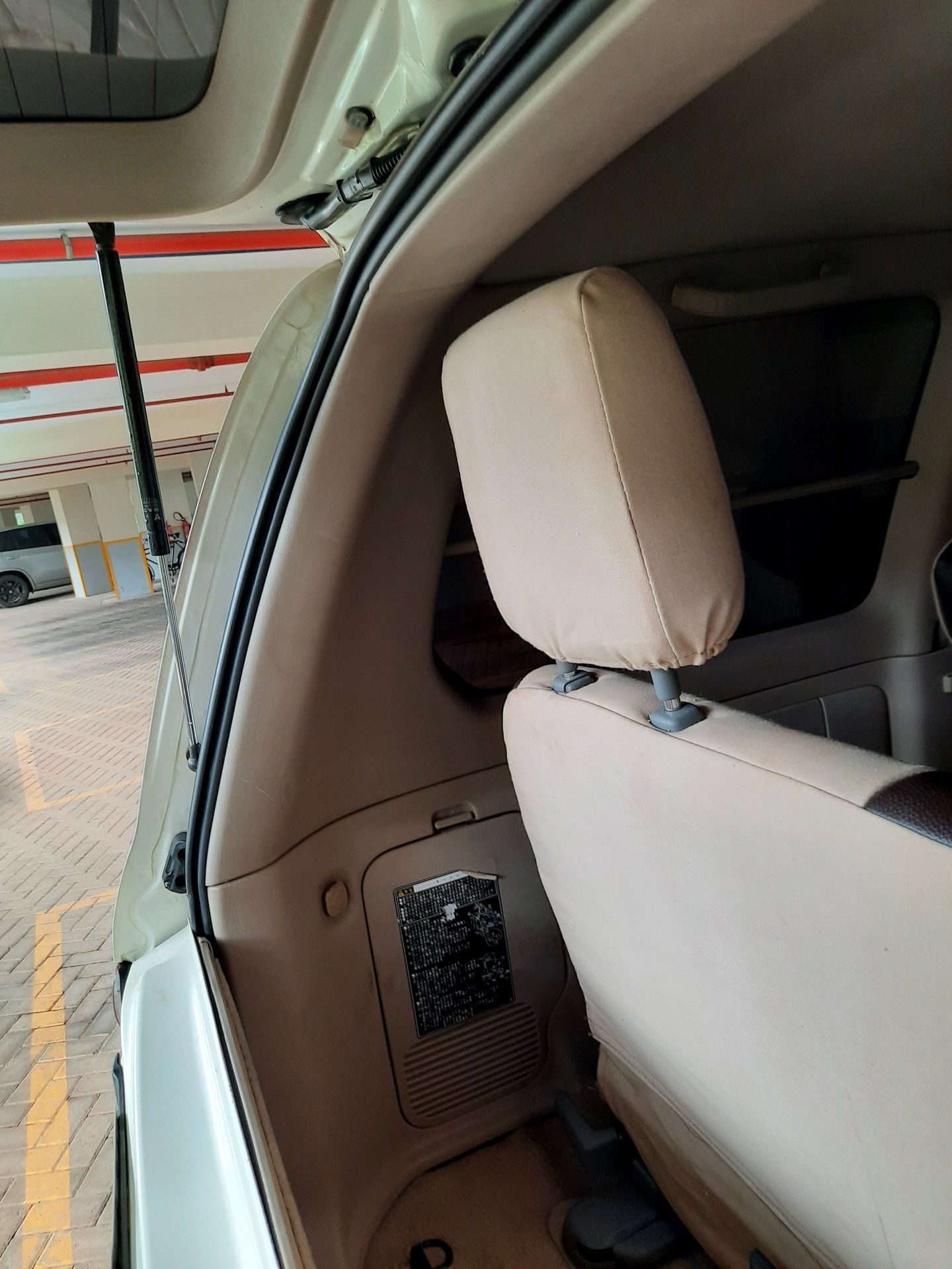

Hi Guys,
I just bought my first Cruiser recently. It has the third row seats present, but no seat belts or any bolt holes/points to attach visible in the window column.
Is this normal? It'd great to get advice on how to proceed with fitting a set.

If you can share pictures, that would help, you might have a different rear seat setup than what was available in the US.

Hi Exiled,
Thanks for your reply. It looks like this:
It doesn't look like those 3rd row seats were original to the vehicle. Could originally have been a 5 seater. I would pull the trimming off the pillar and see if it has the upper/lower seat belt fastening mounts.
Interesting. The floor panel IMO looks like it has the 3rd rows from factory, but the D-pilliar looks like it's a factory 5 seater.
Yeah, the car dealer added the third row for me prior to selling...all coverings done locally here in Kenya.
I wonder if none exists on the pillar, if it's possible to retro fit the third row belts ?
IIRC, the 7 seaters have a reinforced floor. So, I would also check the quality of the retrofit from below (above the spare tire area).
Good advice, thanks...I'll check underneath for the strengthening.
They actually look like they have headrests similar to the 200 series
