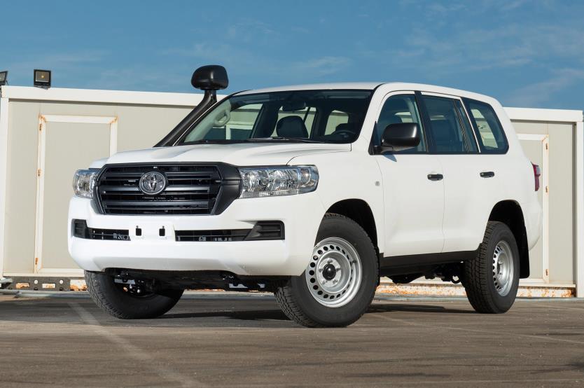

What size is common on cruisers in Africa? And if much narrower, how much of that is dictated by what is commonly available there?
Depends where you are in Africa? For the most part in south africa and along the east you can find almost every common tire size. They might be used. Toyota rims are common. Might not find the exact match you are running so you might have to get 4 or 5 if your in a pinch.

People commonly install balloon tires on LCs here. I’m not sure of the exact width, but I’d say they’re around 8 or 9 inches wide. I’ll ask a relative of mine about the width of his tires fairly soon.
