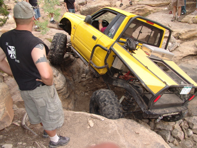

So, you want to put an entire different drivetrain into your 80 correct? Hate to be a negative Nancy, but you will honestly be miles ahead both monetarily and capability wise by starting over. You will end up with a capable truck, but it will still be a big heavy pig that won’t fit on any of the trails that it is built for. You’ll end up dumping it, destroying all the nice “creature comforts of the 80 and end up starting over anyway. I see that you wheel it hard, based on the pics in your sig, this is good. Take your dream wheeling drivetrain components and stick them in a different smaller carcass or tube cassis and leave your 80 together so you have something to wheel while this couple year project comes together. Cut the fenders, fit 37’s and call your 80 good.

Trust me, this is a good idea. Half the weight and size of an 80 and minimalistic is a very good quality in a wheeler. Surprisingly my sheet metal doesn’t really get that beat up.
Fitting 40s on your 80 and keeping it low enough that it isn’t scary is gonna be a bitch unless you weld your rear door shuts and get crazy with hot flame. Sean’s truck was WAAAAAY too tall. But if you do what I have in my head, that would be cool :) I wouldn’t worry about selling your truck, you can get pretty decent coin out of 80 parts once your new wheeler is built and you part out your truck. Like I said before you will spend just as much trying to modify your 80 as you would by starting a new project. I have 5G total in my 40, including purchase price :)
