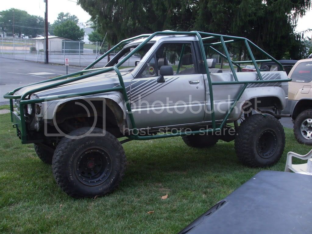

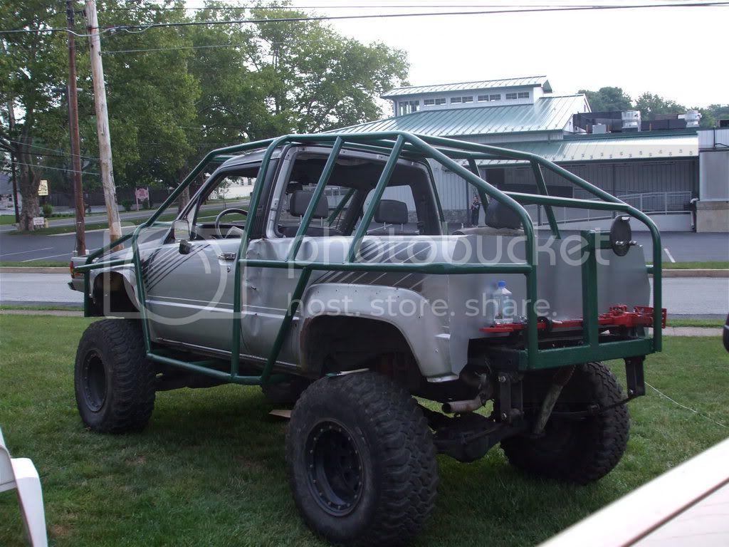

I'm doing the cage because I bartered for the tube. The bender is a Harbor freight special I traded my work for a bunch of transport chain.
I may have to start breaking into the expensive 40 parts to fund this.
Amazing how quickly it gets out of hand . . . looks pretty sweet!
I'm welding as fast as I can. Didn't think the first run at it would hold up, so I went back in to trangulate and reinforce. I'll get more pictures up soon.
Well, didn't think it would hold up until I found my free pipe was reject sch. 40. The reject part is it was sch 80 marked as 40. That would be why it was so hard to bend and cut. So the main hoop, sliders, and side of the cage are 80, while the stiffiners and cross bars are 40.

Got camera. Here's pics.
We're trying to decide if its more Department of Corrections or Mad Max?
But for now its grasshopper.
Wife chose the color. I wanted hot pink.

hot pink would've ruled. that's quite the cage!
The correct tubing. Wife went back and threw enough of a fit
to bring out someone else who said, "hey, thats the wrong stuff",
and then corrected it.
Works much better now
