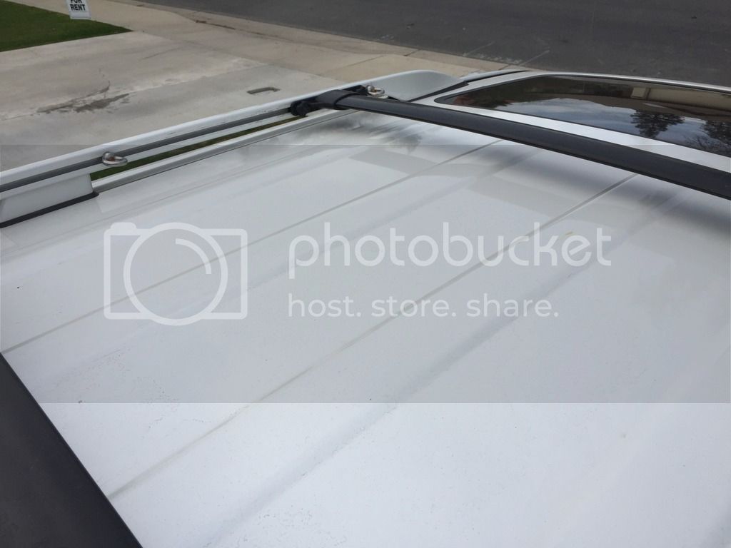

Could you share info on the roof rack cargo hooks.
CARGO HOOKS
Here's all the info for the cargo hooks.
I was having some difficulty securing cargo to the roof so I started looking around for a better way. I came up with using some t-slot bolts and eye loops nuts and some rubber washers to protect the paint.
It was not a cheap solution but it works OK.
The t-slot bolts, unfortunately these are not stainless, if you do this project try to find some stainless ones. Mine have already started to rust with one trip near the pacific coast. Also these bolts are too long, I had to cut them. Try to find some shorter ones.
uxcell M8 Thread 30mm Length T Slot Drop-in Stud Bolt Screw 20pcs Silver Tone: Amazon.com: Industrial & Scientific
The eye loop nuts. These are stainless.
uxcell M8 Female Thread Stainless Steel Lifting Eye Nuts Ring 10 Pcs - - Amazon.com
The installation:

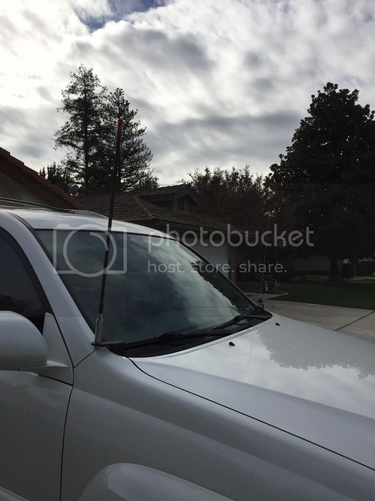

2 m RADIO INSTALL
For the radio installation I used CBI off-road ditch light mounts for the antennas. The 4th Gen 4runner models fit just fine on the GX 470.
The ditch light mounts re the exact same as the antenna mount they sell but If you by the ditch lights they are cheaper for no apparent reason. And you get a free shirt which is pretty sweet.
The mounts:
4th gen 4Runner Ditch Light Brackets + FREE SHIPPING | CBI Offroad Fab

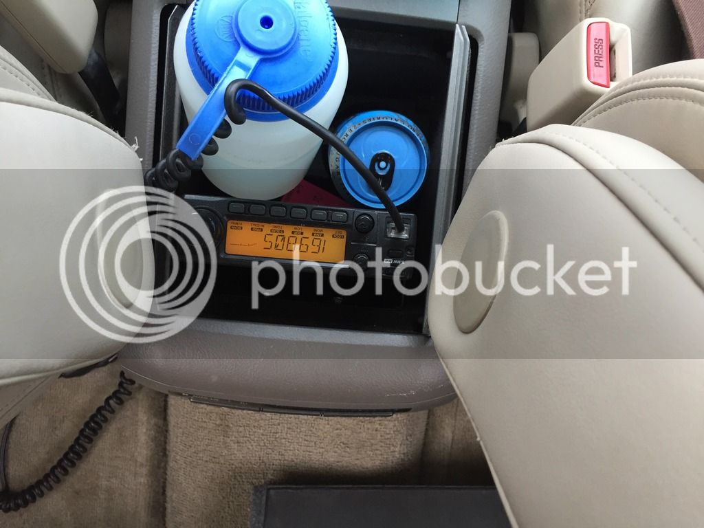

Icom 2m radio location: mounted in the center console. If you remove the rear A/C and sound system controls you have acces to put bolts into the radio mount from the rear of the console.
The 2m antenna and mount:

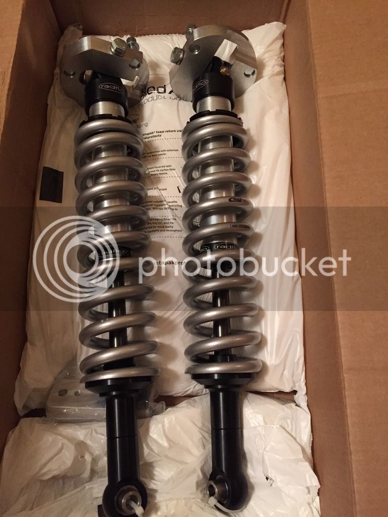

SUSPENSION
For the suspension I decided to go with Radflo front coilovers and FJ cruiser rear springs with radflo rear shocks.
On my old tacoma I had done Bilstien 5100 with a slight lift; 1" in the front I think. Anyway I wasn't super happy with them so I decided to go a different route with this GX.
After a good amount of research I went with Radflo and so far am very happy with them after about 1,500 miles on them. I took them on a full run through some pretty rough roads in death valley and was very impressed. I could bomb down these dirt roads at 55-60 MPH and felt totally smooth and comfortable. On the road they ride great for the most part. There is some strange behavior at very low speeds sometimes (parking lot speeds) where it feels like there is s spring with no damping component but this is a minor gripe. they can't be perfect for every situation.
