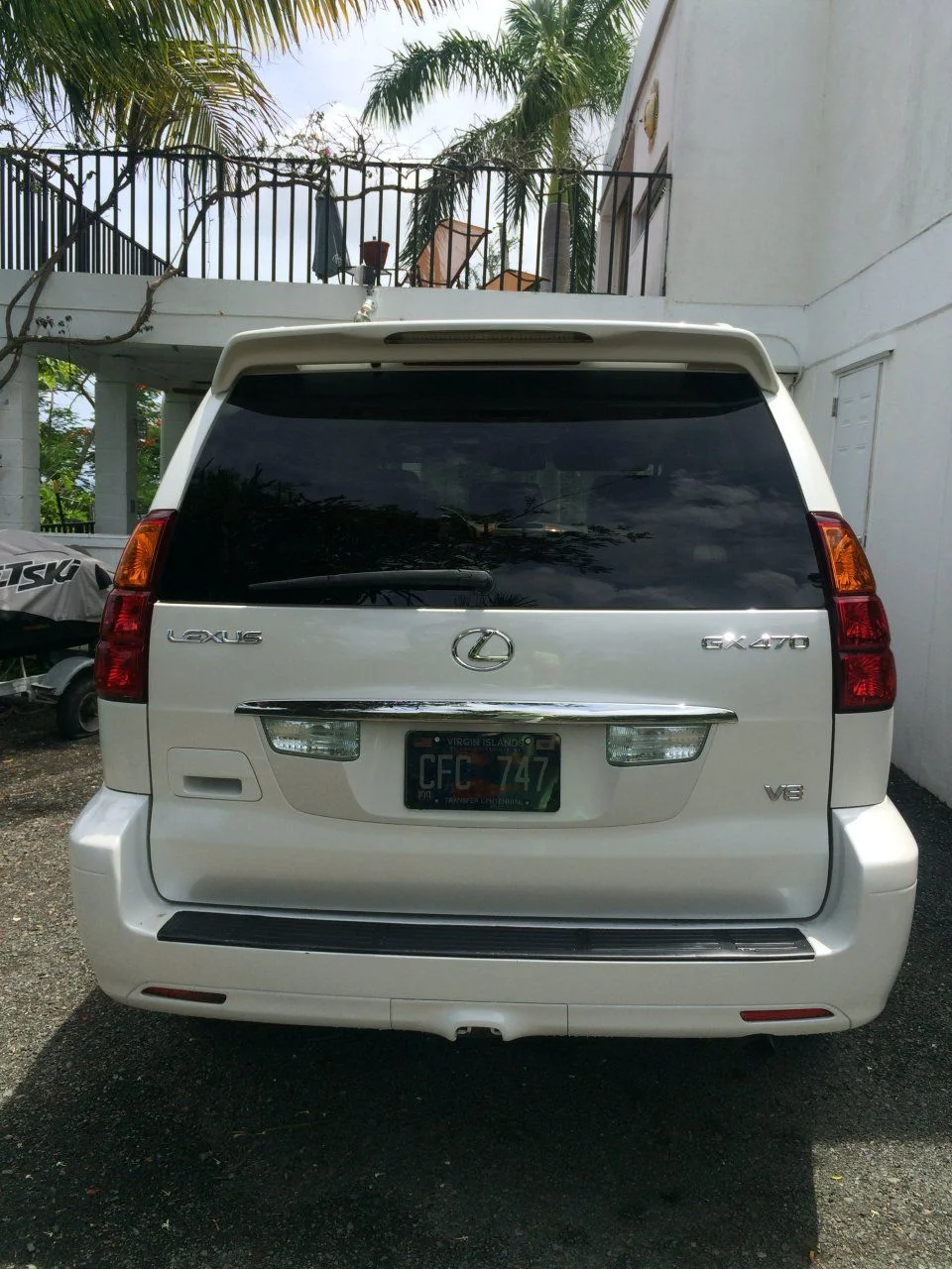

I has been a while since I have updated my progress on the log awaited GX 470 island build. Since my first post I blacked out the emblems on the rear of the GX along with the chrome strip with more Plastidip. I have attached a few photos of my process. All I did was clean the emblems well with alcohol and q tips and spray three coats from various angles. A good tip to remove the paint from small places inside the emblems is a tooth pick.
